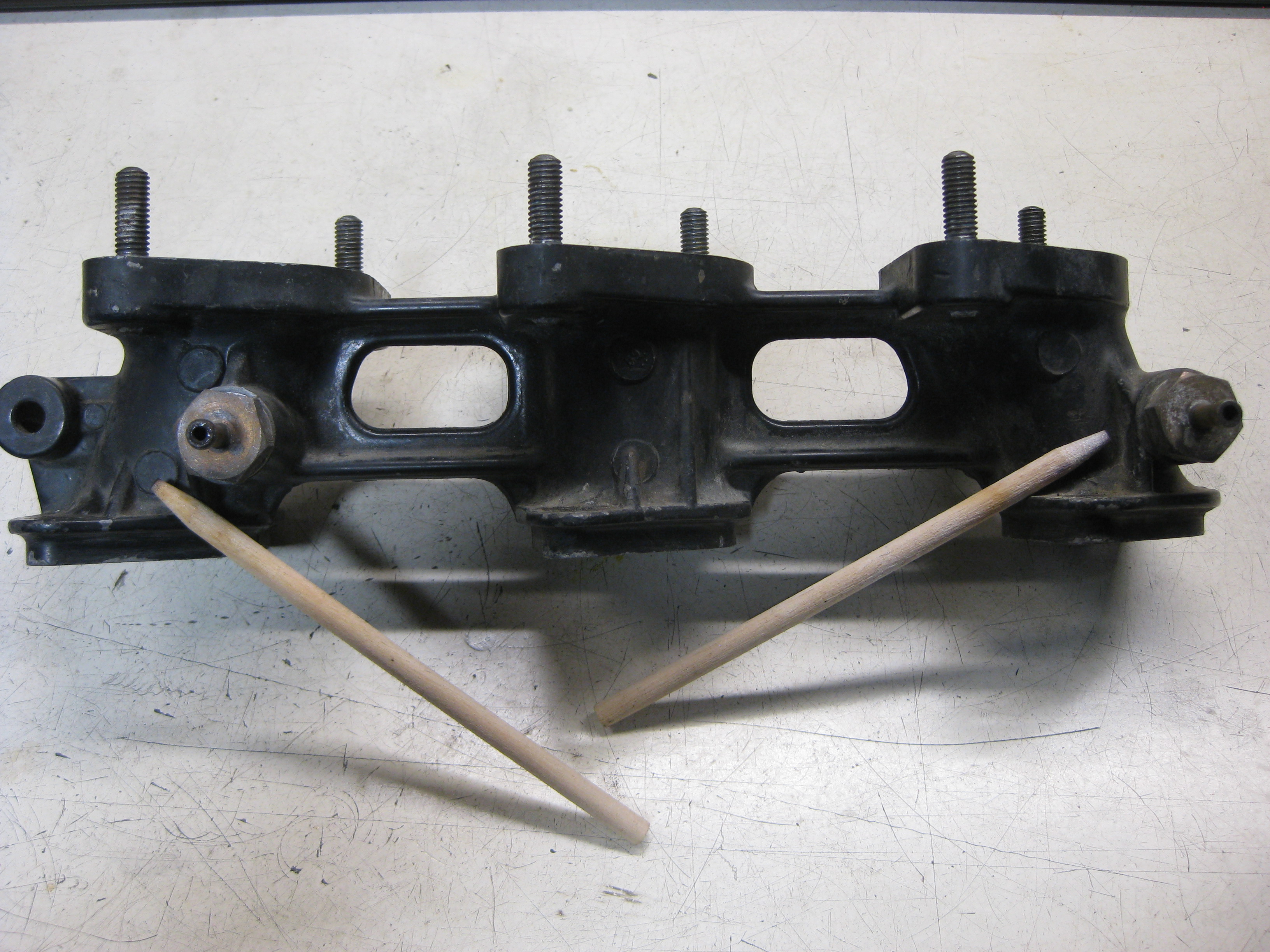

914-6 intake manifold with vacuum ports
Very interesting! Thanks for the visual aids. Do you know if those ports were threaded?

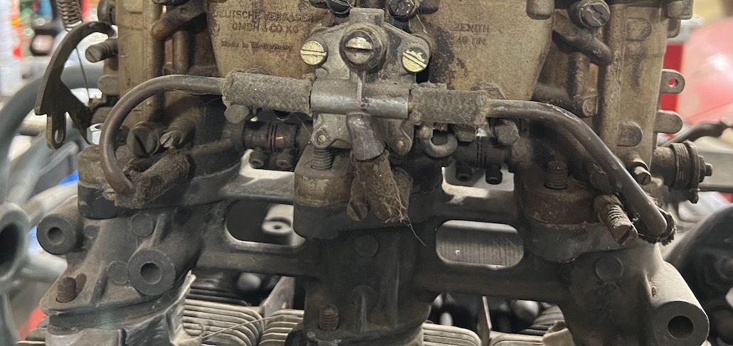

Our engine was missing the carbs. What we have now is a set of Zenith. The intake manifold has openings, but they are are not threaded.

Dennis those carbs and manifolds are from a '70-'71 2.2 911T
Two year only combination.
Not drilled for the vacuum ports....but could be.
How serious is your restoration ?
Those manifolds will be just fine on your 6 unless you insist on the absolute correct
parts.
The only difference is the vacuum ports which you will likely never use.
