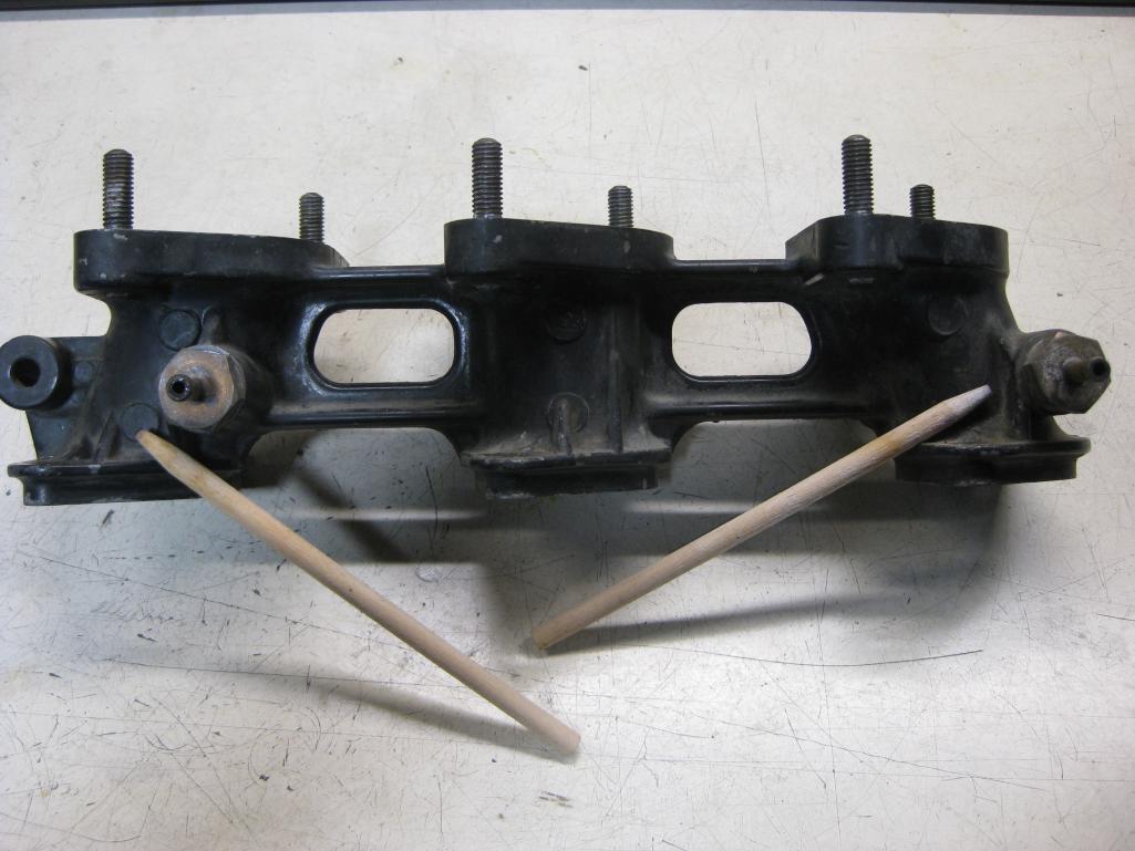

johnhora
post Sep 5 2022, 08:39 AM
Posts: 890
Joined: 7-January 03
From: Derby City KY
Member No.: 107
914-6 intake manifold with vacuum ports
picture from the shop manuals 914-6 fuel system volume

QUOTE(johnhora @ Sep 5 2022, 07:39 AM) *
Very interesting! Thanks for the visual aids. Do you know if those ports were threaded?
Our engine was missing the carbs. What we have now is a set of Zenith. The intake manifold has openings, but they are are not threaded.

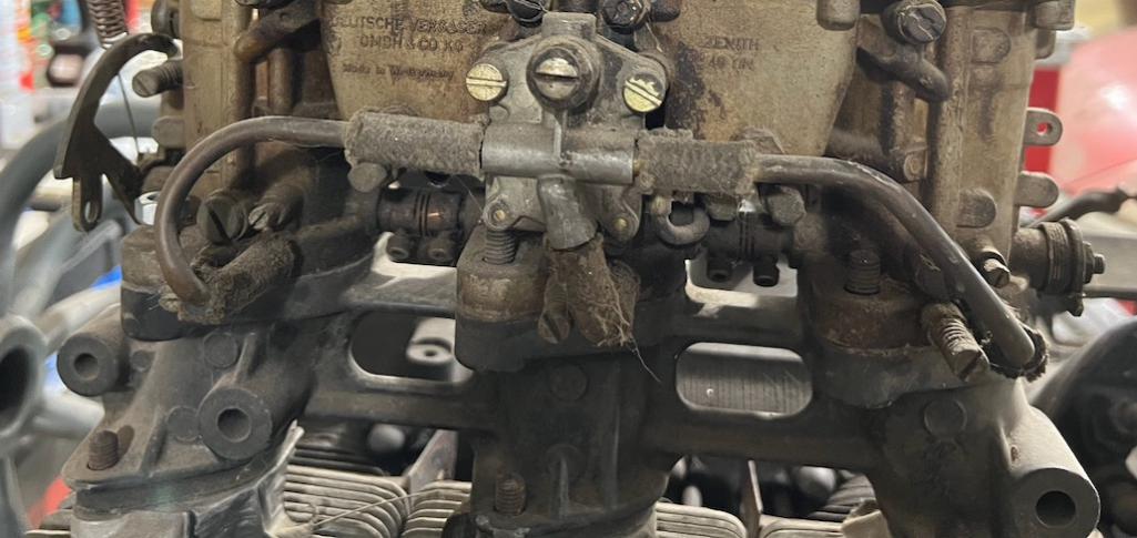

rgalla9146
post Sep 9 2022, 01:49 PM
Posts: 4,786
Joined: 23-November 05
From: Paramus NJ
Member No.: 5,176
QUOTE(DennisV @ Sep 9 2022, 12:09 PM) *
Dennis those carbs and manifolds are from a '70-'71 2.2 911T
Two year only combination.
Not drilled for the vacuum ports....but could be.
How serious is your restoration ?
Those manifolds will be just fine on your 6 unless you insist on the absolute correct
parts.
The only difference is the vacuum ports which you will likely never use.
