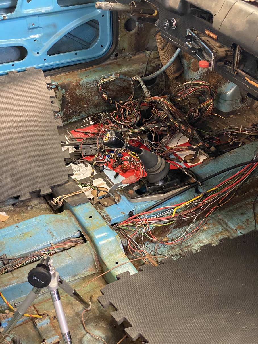

Yesterday I was able to squeeze a few hours into the 914.

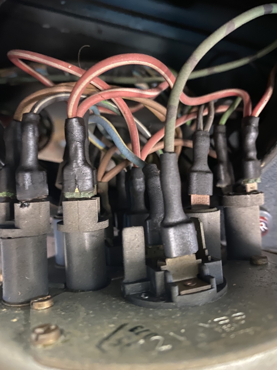

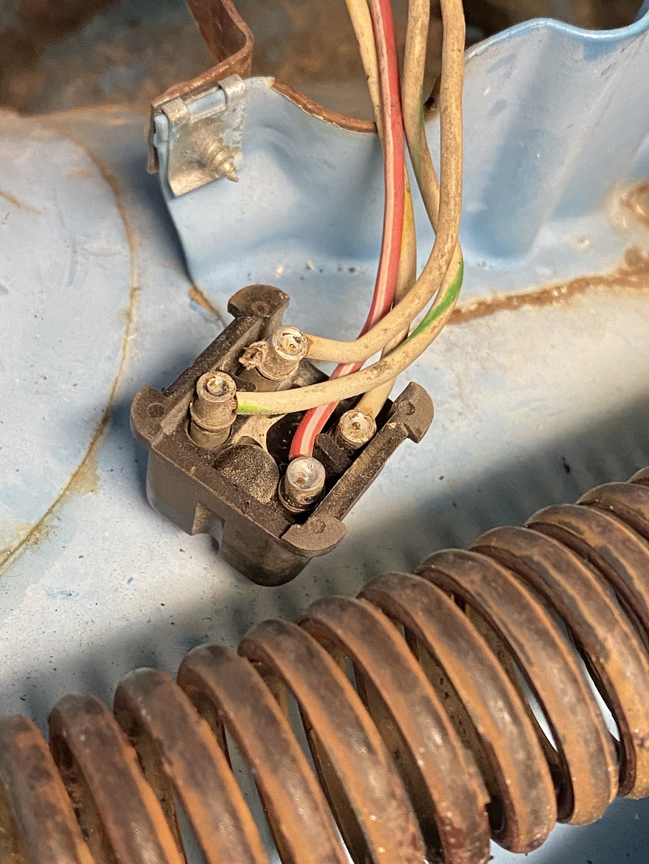

I thought it would be best to completely remove the wiring harness and either A, pare down the existing and replace the cut ignition wires, or B, buy a Kroon or other harness for the 6 conversion.
The 6 conversion wont actually require anything more as I'll be going weber or PMO carbs on it. The existing wires, though filthy are not too bad, save for the engine bay section which feels a little hard, presumably from the engine heat.
I started by removing the dash harness which was not too bad. I took photos of the gauges to assist with the reassemble.
I've removed a harness from a 77 911 in the past and I'd say the job was about the same. The frunk took longer than expected as there were the parking lights, horns, and popup light motors to contend with.
I just cut off the boots to the side marker lights as they wouldn't have fit through the bulkhead anyway and were pretty much wasted. I think I'm going to delete the side markers anyway.
I had to remove the housing to the fuel level sender end to squeeze it through the hole in the firewall:
The only wires going to the front will be the Fogs, Fuel, the popup headlight motors, the headlights, the parking lights, the horns, and probably an automatic fan for the front cooler. I'm probably forgetting something else.
The rear was pretty easy too. PO had already removed the harness up to the rear lights and it was laying in the trunk.

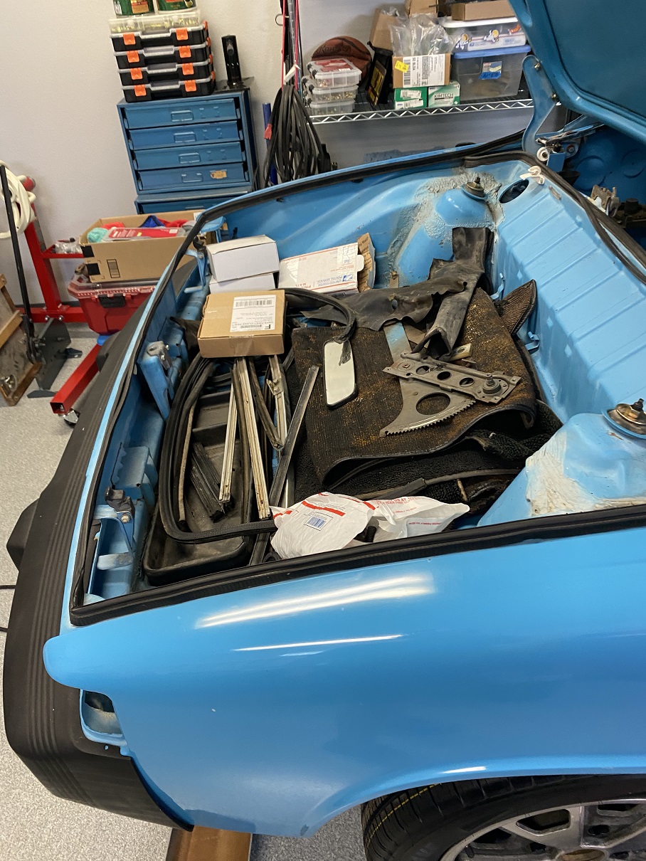

The trunk is full of parts atm:
Back to the frunk, I'm at the point where 90% of the front is pulled into the cockpit and I need to research the best way to remove the rest. The 911 pulls out the back, so I'm thinking the 914 is the same way.

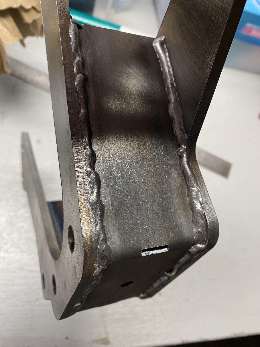

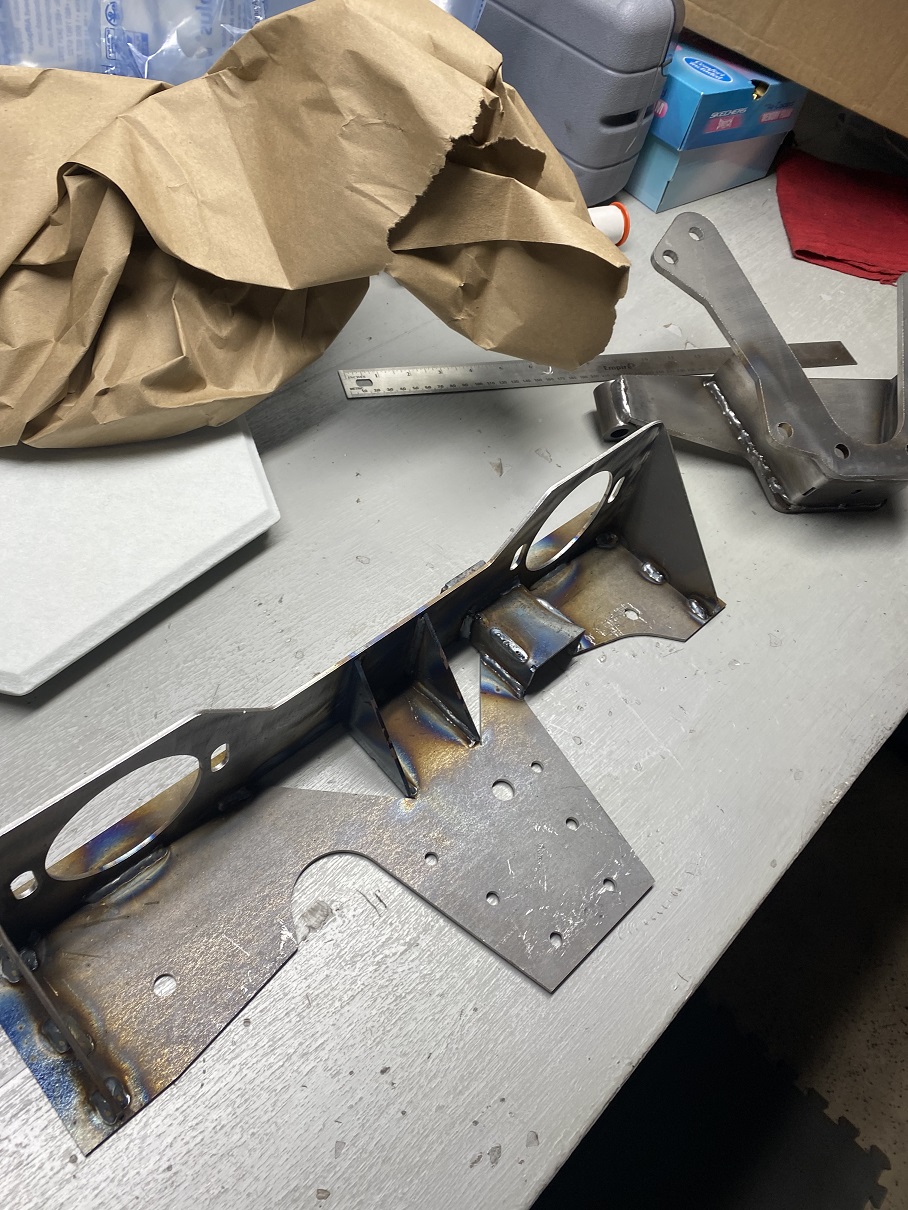

I received my 6 motor mount. I took advantage a labor day sale and received the part yesterday:
It still needs a lot of work to be welded to the bulkhead, and once it's smoothed over, seam sealed and painted it will be great.
The yoke is heavy duty and well done: I'll probably powder coat this black.

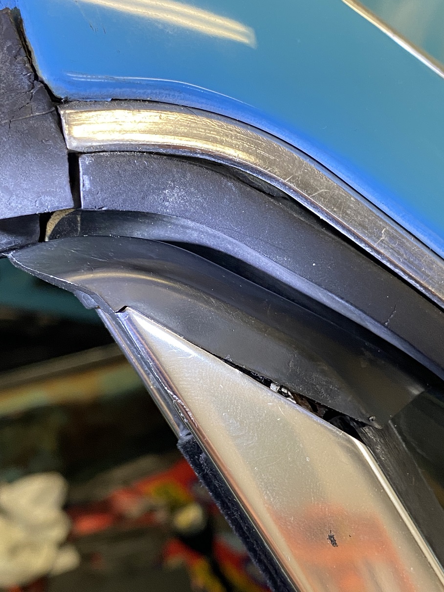

Lastly, I have to take the window out yet again. I think I'll go ahead and patch the mirror holes while it's out, and then try to get this top fit better.
It just really fits poorly at the moment. I can't get the cap to sit flush, I think it requires internal trimming or something, I should also put new rubber on the A pillar as well.

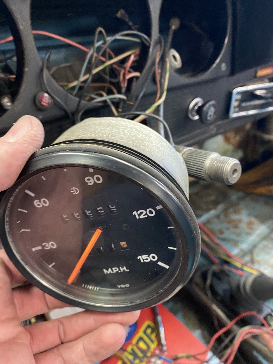

Graydingo   check out this cool RPM gauge I found in one of th...   Sep 6 2026, 02:23 PM
porschetub   check out this cool RPM gauge I found in one of t...   Sep 6 2026, 03:55 PM
