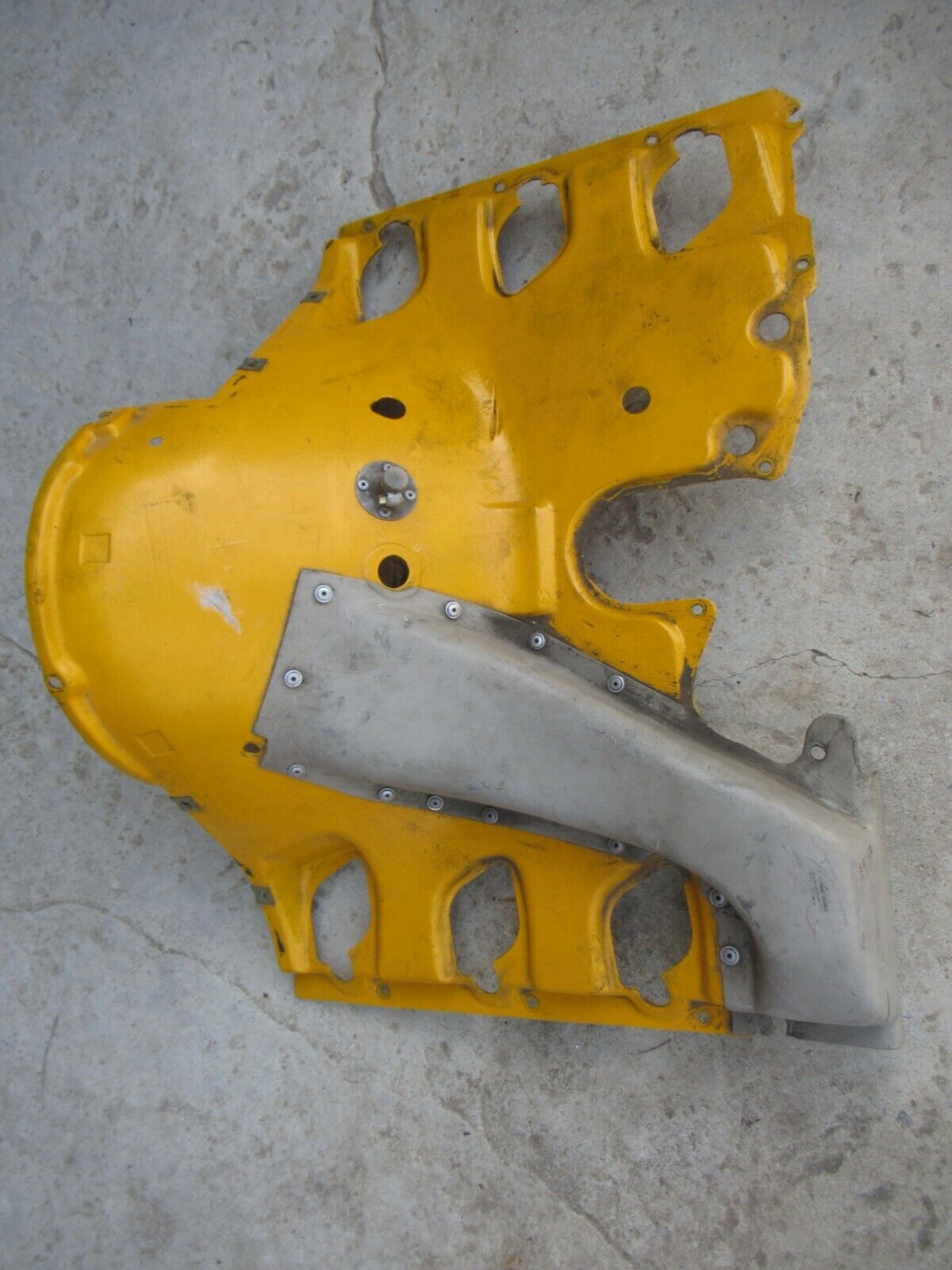

blk one on Ebay is a year too early,,, but could work if you had the grey oil cooler duct wich the 914-6 Has.
Should look like this, But Blk .

brant   jeff, doesn't your yellow example have the i...   Sep 14 2022, 03:28 PM
DennisV   doesn't your yellow example have the injector...   Sep 14 2022, 03:32 PM
mb911   I have a black on on my car currently. Wanted to g...   Sep 14 2022, 03:53 PM
sixnotfour   yes yellow has mech injector holes ,,reason i didn...   Sep 14 2022, 04:46 PM
