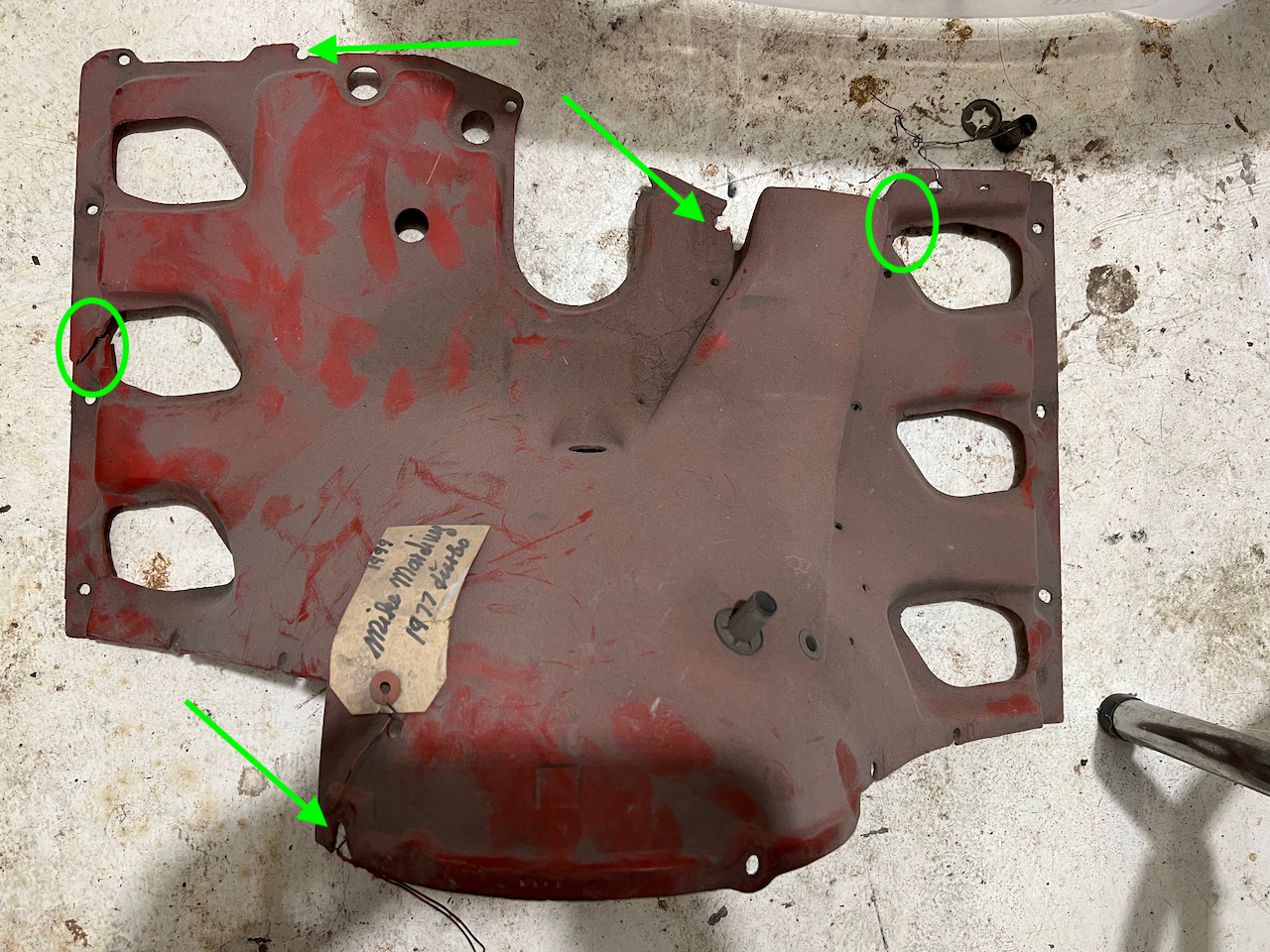

We have an original 914-6 engine, sans the fan shroud (aka upper air guide) and tin. Can someone educate me on fitment and availability? Is there a definitive fan shroud article or post? If so, I could not find it.
What I understand is correct would be a 911-106-901-00 Air Guide Upper Black. This appears to be shared with 1969-71 911T with carbs.
What we do have is a red shroud, which appears to be off of a 1977 911 Turbo. It has a couple cracks and some bolt holes broken open. I have no doubt it could be salvaged with some effort, but even then I am wondering if it would fit correctly. There’s a post on the early911sregistry site, which suggests there are differences beside the color but doesn't go into much detail.
It seems like they are hard to come by. I did find one currently on eBay that says it has been “modified”. It this my best current option? Does anyone recognize the modifications?
Of the after market vendors I found mentioned in old threads, it appears that series900 may still be selling them. I am waiting to hear back from them. Does anyone have first hand experience with the quality and fit of their product compared to original?

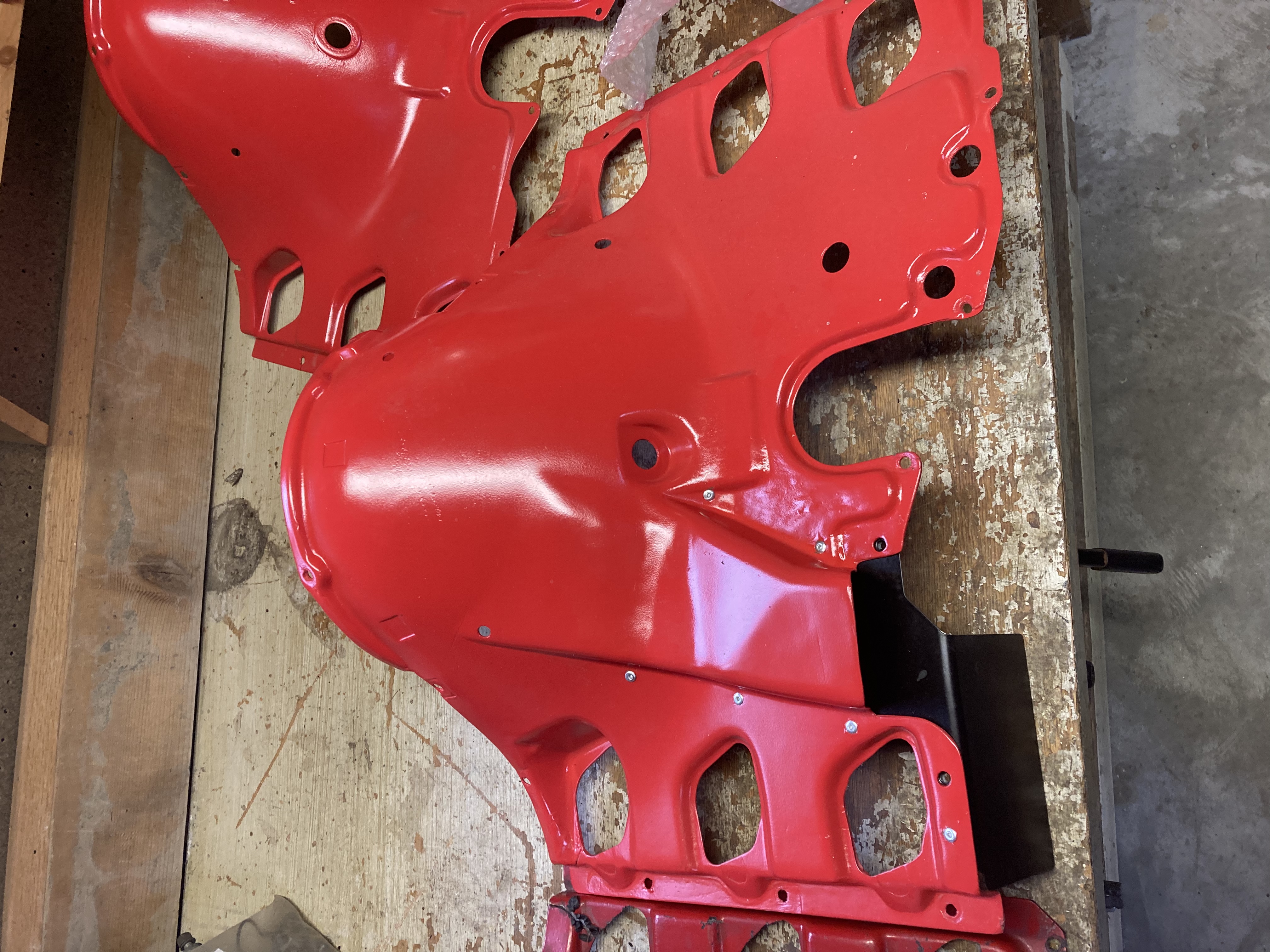

Retroracer   Check out the two photos. The first is the shroud...   Sep 14 2022, 05:35 PM
DennisV   Thanks everyone for the info. Check out the two p...   Sep 15 2022, 05:53 AM
sixnotfour   the second shroud is a 74 non S shroud , pretty ra...   Sep 14 2022, 06:02 PM

sixnotfour   the last red one of the Groupe can e modified to a...   Sep 14 2022, 09:48 PM
