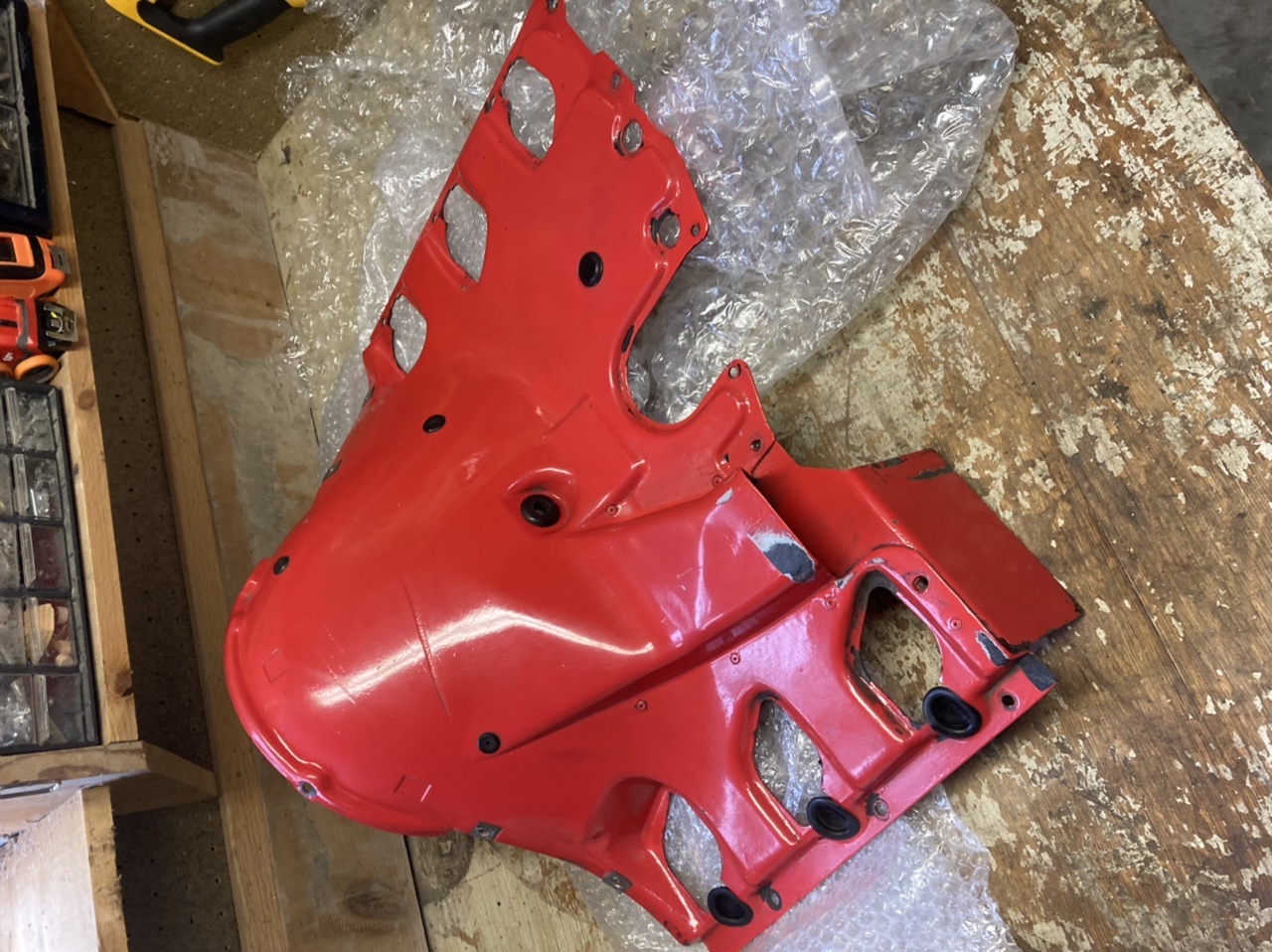

We have an original 914-6 engine, sans the fan shroud (aka upper air guide) and tin. Can someone educate me on fitment and availability? Is there a definitive fan shroud article or post? If so, I could not find it.
What I understand is correct would be a 911-106-901-00 Air Guide Upper Black. This appears to be shared with 1969-71 911T with carbs.
What we do have is a red shroud, which appears to be off of a 1977 911 Turbo. It has a couple cracks and some bolt holes broken open. I have no doubt it could be salvaged with some effort, but even then I am wondering if it would fit correctly. There’s a post on the early911sregistry site, which suggests there are differences beside the color but doesn't go into much detail.
It seems like they are hard to come by. I did find one currently on eBay that says it has been “modified”. It this my best current option? Does anyone recognize the modifications?
Of the after market vendors I found mentioned in old threads, it appears that series900 may still be selling them. I am waiting to hear back from them. Does anyone have first hand experience with the quality and fit of their product compared to original?

DennisV   914-6 Fan Shroud Education   Sep 14 2022, 03:06 PM
sixnotfour   blk one on Ebay is a year too early,,, but could w...   Sep 14 2022, 03:18 PM
DennisV   @[url=http://www.914world.com/bbs2/index.php?showu...   Sep 14 2022, 04:28 PM
brant   jeff, doesn't your yellow example have the i...   Sep 14 2022, 03:28 PM
DennisV   doesn't your yellow example have the injector...   Sep 14 2022, 03:32 PM
mb911   I have a black on on my car currently. Wanted to g...   Sep 14 2022, 03:53 PM
sixnotfour   yes yellow has mech injector holes ,,reason i didn...   Sep 14 2022, 04:46 PM
sixnotfour   The short shroud, islate 72-89, You need the long...   Sep 14 2022, 04:52 PM
Retroracer   Check out the two photos. The first is the shroud...   Sep 14 2022, 05:35 PM
DennisV   Thanks everyone for the info. Check out the two p...   Sep 15 2022, 05:53 AM
sixnotfour   the second shroud is a 74 non S shroud , pretty ra...   Sep 14 2022, 06:02 PM
BillJ   Damon made me a brand new one that i am very pleas...   Sep 14 2022, 06:33 PM
brant   I went to look in the parts stash I think 2 early...   Sep 14 2022, 08:38 PM
brant   And   Sep 14 2022, 08:38 PM
brant   And   Sep 14 2022, 08:41 PM
sixnotfour   the last red one of the Groupe can e modified to a...   Sep 14 2022, 09:48 PM
oldie914   I am fairly certain that the 914/6 fan shroud was ...   Sep 15 2022, 02:32 AM
DennisV   I made a factory tour in 1971 and saw a 914/6 eng...   Sep 15 2022, 06:03 AM
mlindner   I purchased a early shroud (carb holes). It was pr...   Sep 15 2022, 07:03 AM
johnhora   Same as a 911 2.2T carbureted   Sep 15 2022, 10:51 AM
DennisV   Sorry. I know this is getting beat to death, but i...   Sep 15 2022, 12:14 PM
Retroracer   Sorry. I know this is getting beat to death, but ...   Sep 15 2022, 04:40 PM
johnhora   Stock Real 914-6 Shroud Early 70s were parts chan...   Sep 15 2022, 02:23 PM
