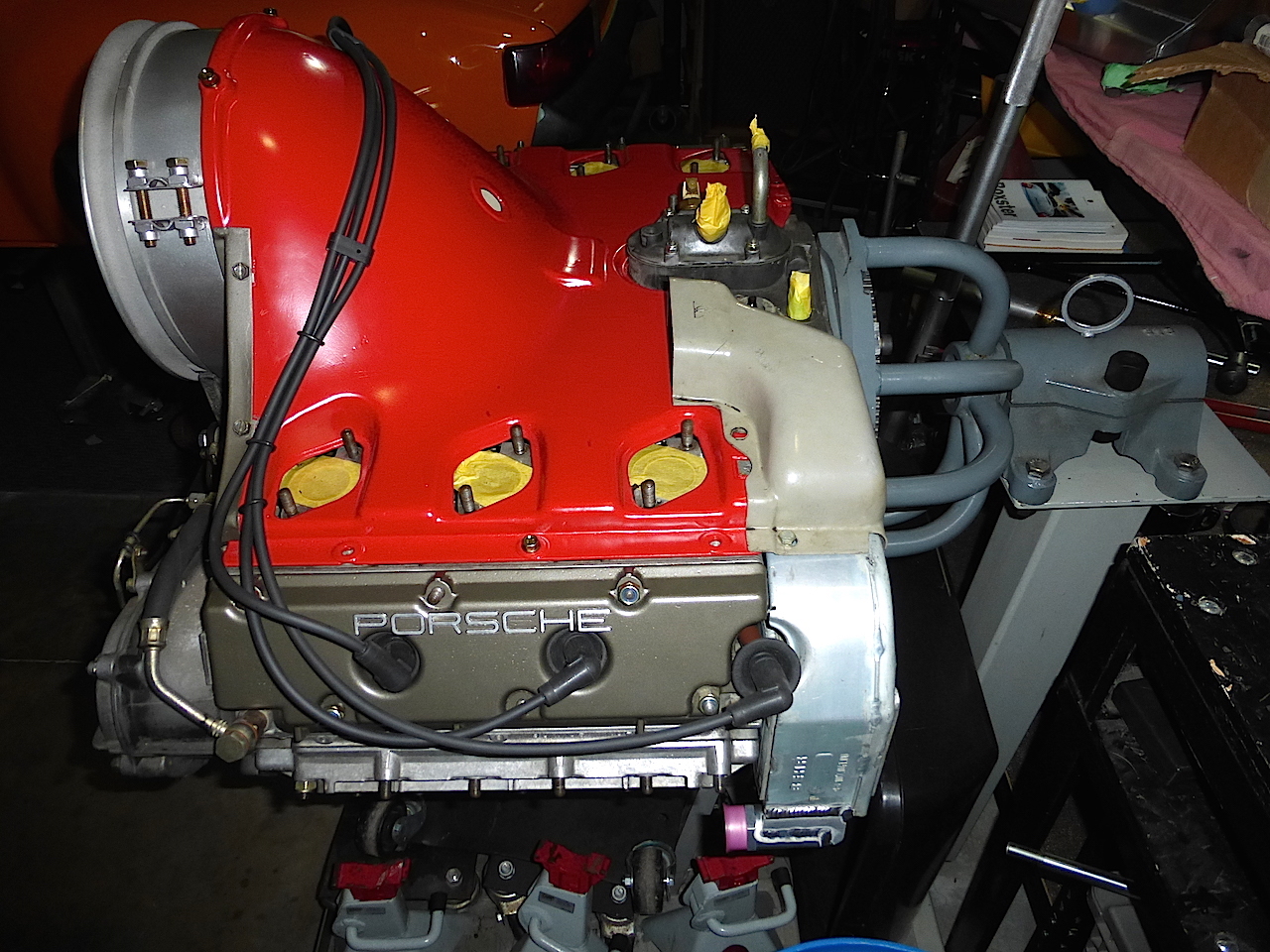

I purchased a early shroud (carb holes). It was pretty bad shape, fiber glassed broken areas, then did a gel-coat over sanded glass and painted red for my 2.2 E with S pistons. Then added duck to oil cooler. Best, MarkAttached Image
