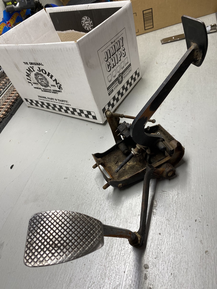

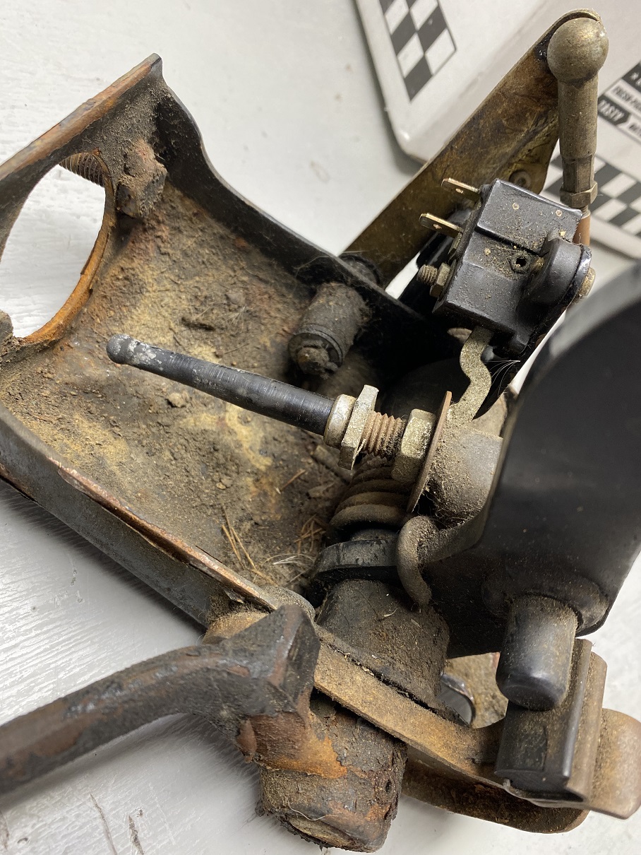

I removed the pedal cluster and shipped it to Bruce Stone for a refresh. While I've refreshed two 911 clusters, I just felt like farming it out this time. With all the work of plating, powdercoating etc it's a lot of time to do it by yourself. I even made a video of me doing my 911 cluster if anyone is interested in the process
I think mentally, I just didn't want to do it again. Plus Bruce replaces the aluminum nut with his own part if I recall so he makes it OEM +
I like reaching out to others in the 914 world to get to know the community. So often I learn something when I talk to people who've been doing this for years.

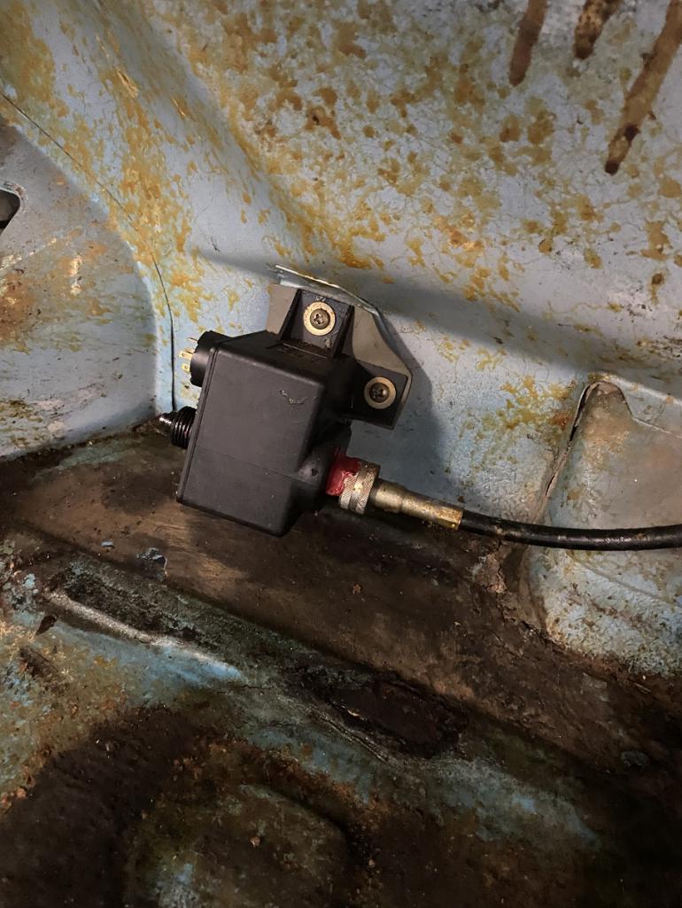

Removed the EGR counter, sourcing a single speedo cable instead of the two piece setup used for the EGR counter.
I may replace the gauge surround plastic face with a non EGR/CAT version as I don't really want or need those lights in my dash now.

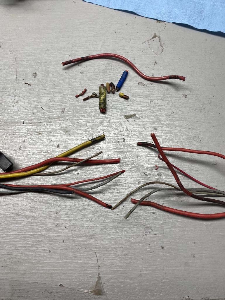

More inspection on the wiring harness is revealing a lot of funkery. Many cuts all over the place as well as melt damage, outright wrong wire replacements, and copious amounts of electrical tape. As I mentioned the ignition harness was cut and then hastily wired back together. Every. Single. Wire. While ultimately whomever did it, only needed to cut two or three of the 6 wires. Ugh. Here's the harness after I cut out the offending wire nuts, electrical tape, and odd soldering.
I believe I've found a full harness out of a 76 with only very mild differences. I'm swapping out the 914 Tach with a 911 2.7 midyear tach, and I'll need to choose a wire for oil pressure and maybe AFR. I run a dual AFR gauge made by John Bell in my 911 and it's pretty badass. :-D

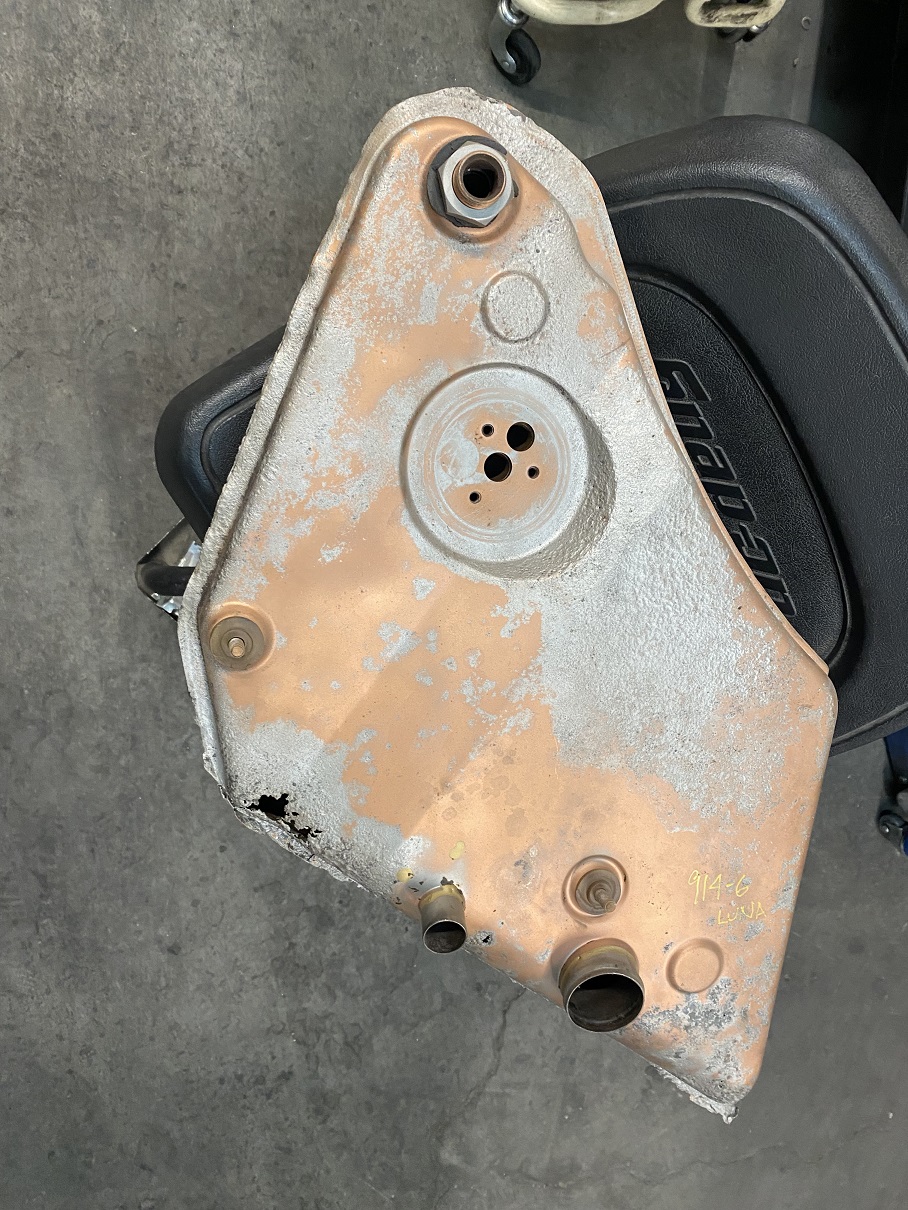

Yall might find this interesting; Carl's place had an original 914-6 tank. I took some photos for reference. Note the holiness:
As I mentioned previously, I did buy Ben's setup as it's a hugely important piece of the 6 swap and it did not disappoint.

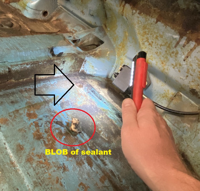

Finally, when removing the EGR counter I found a weird blob of sealant just to the right of the tunnel on the passenger side:

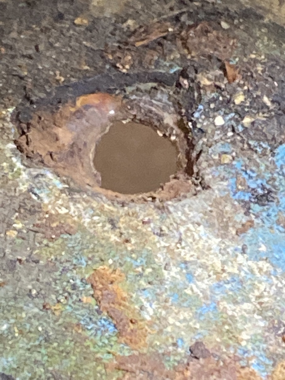

After popping it out I discovered a bullet hole:
This is wild to me because here's the story of my 911 that has a bullet hole in the passenger floorboard.
A closeup of the bullet hole. I reached out to the PO, and he more or less confirmed what it was.
Finding a bullet hole in my 914, which is the same model year (1975) as my 911, which ALSO has a bullet hole in the passenger floorboard (and made just one month early in 8/74) is a little freaky. To top it off I was born in June of 75, meaning myself, the 914, and the 911 were all started in the 'factory' approximately the same time.
