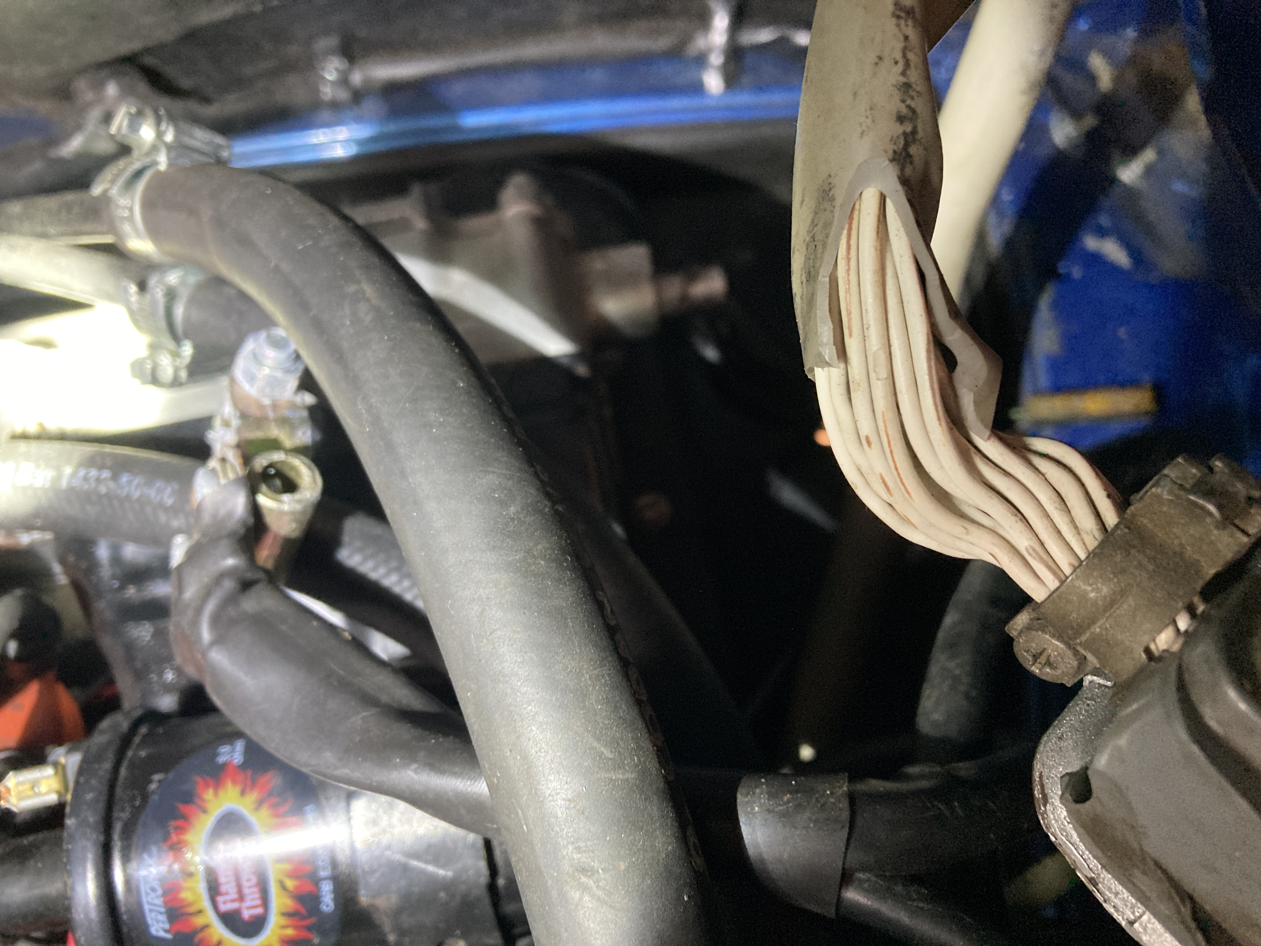

One of the things I did notice was that the ECU as very loose. At some point the garage hadn't re-attached it properly and it was rubbing on the wiring loom which in turn was resting on the cooling shroud. It had rubbed through some off the outer protective sleeve but the wires appeared intact - however some had a weird brown discolouration on them... (Pic attached) perhaps like they had been getting hot? Anyone seen this before?

ChrisAttached Image
