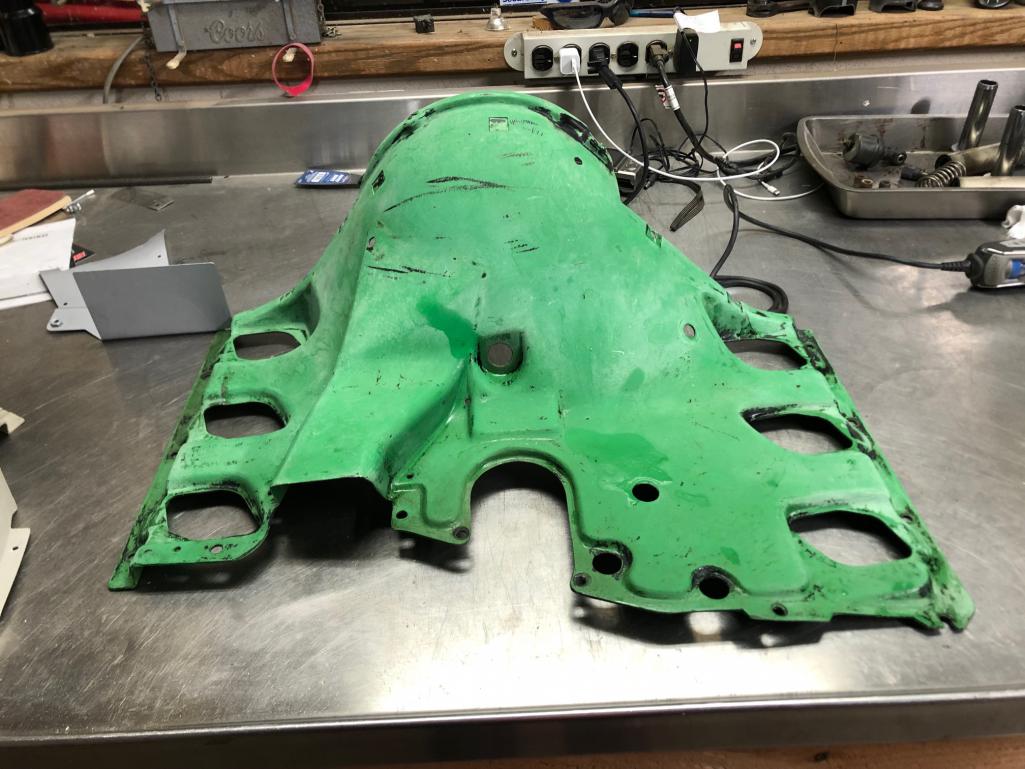

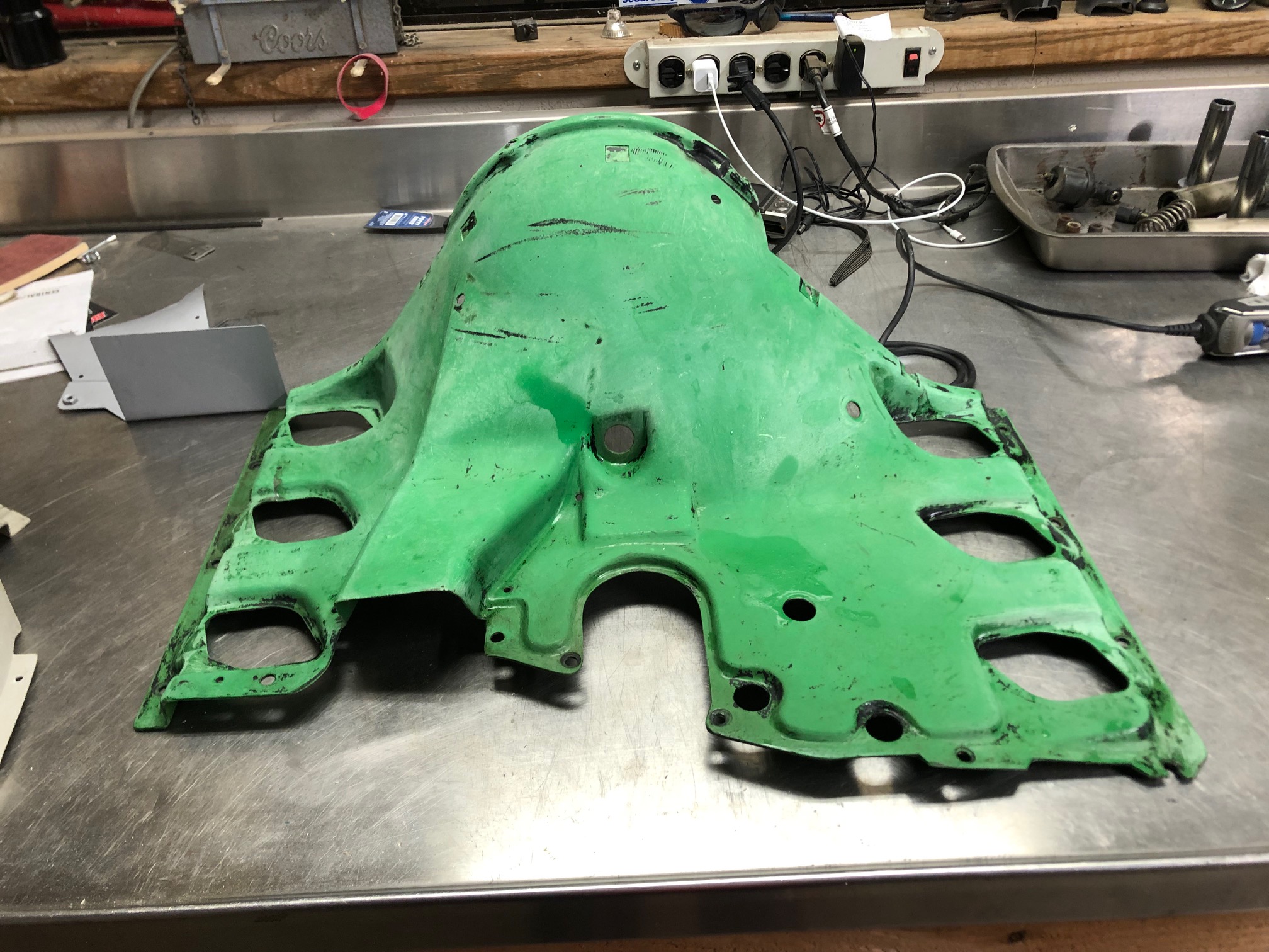

  • Painted the fiberglass shroud

Halfway through sanding the old rattle can black paint off.

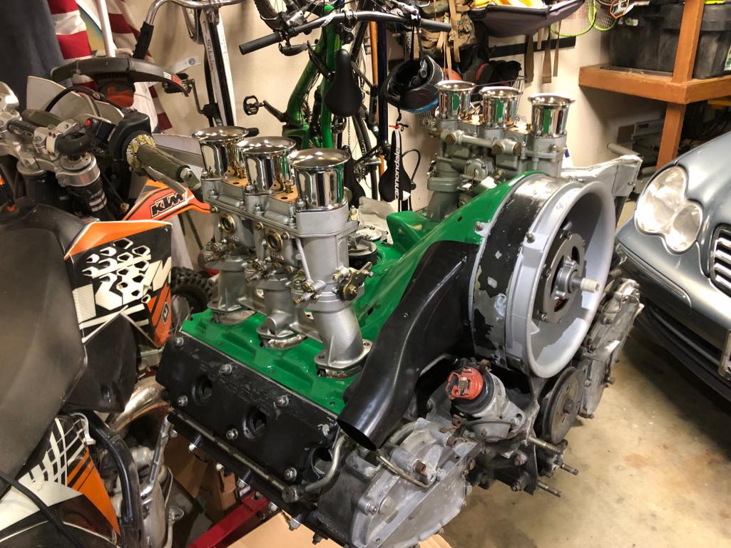

Cowl painted and placed on engine. Carburetors mock placed just to get me all fizzy about the project again.

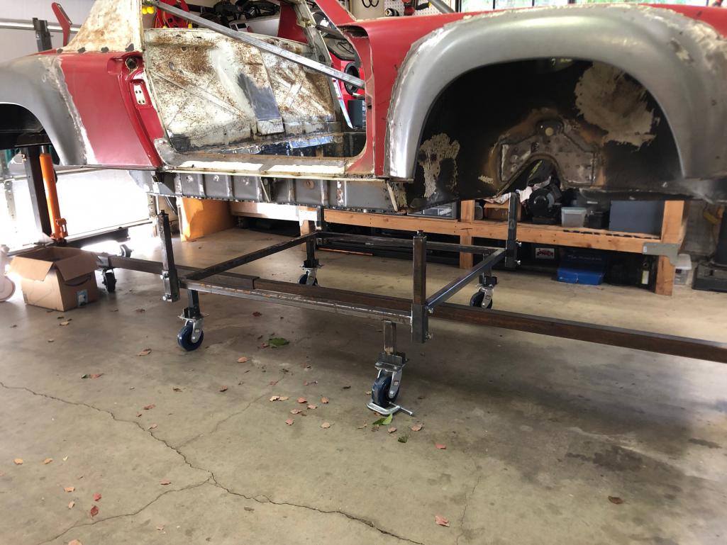

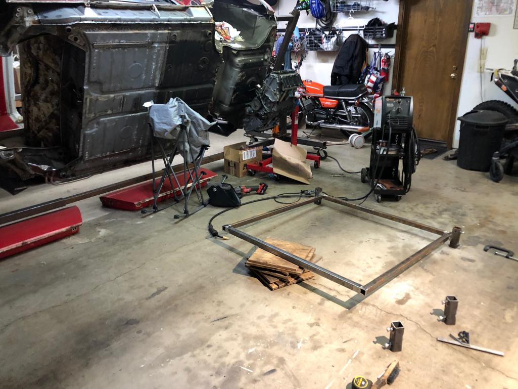

Frame dolly fabrication in progress
Frame dolly completed and placed under the rotisserie.

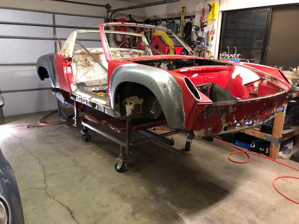

How she sits today:
