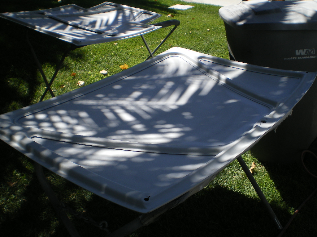

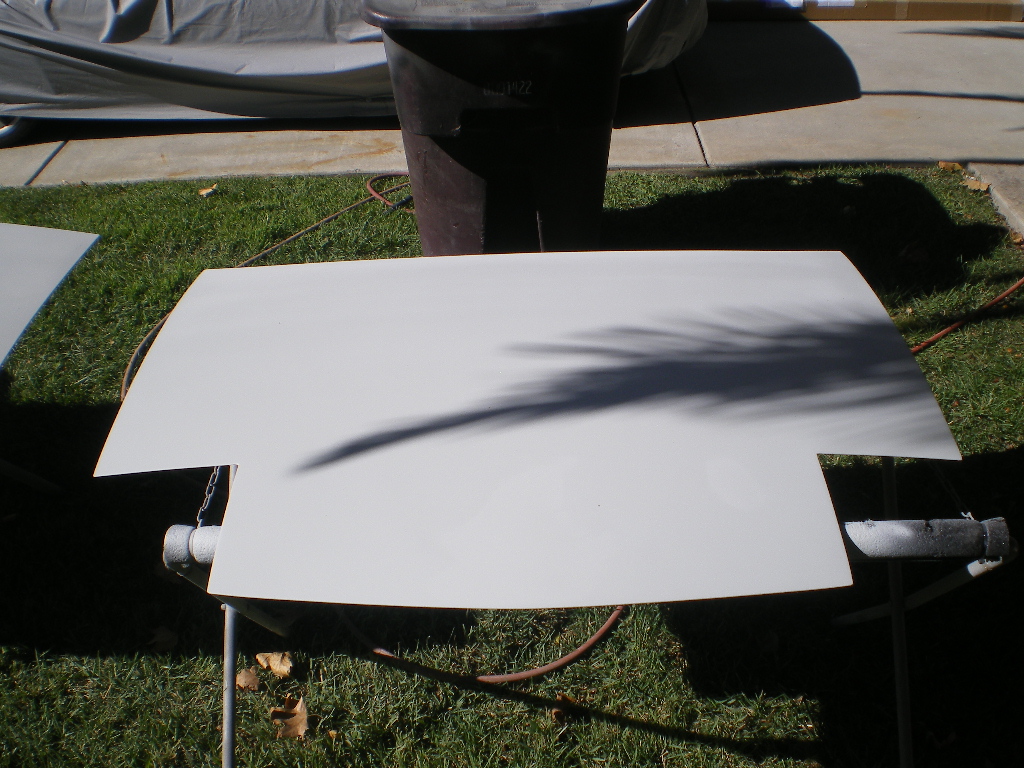

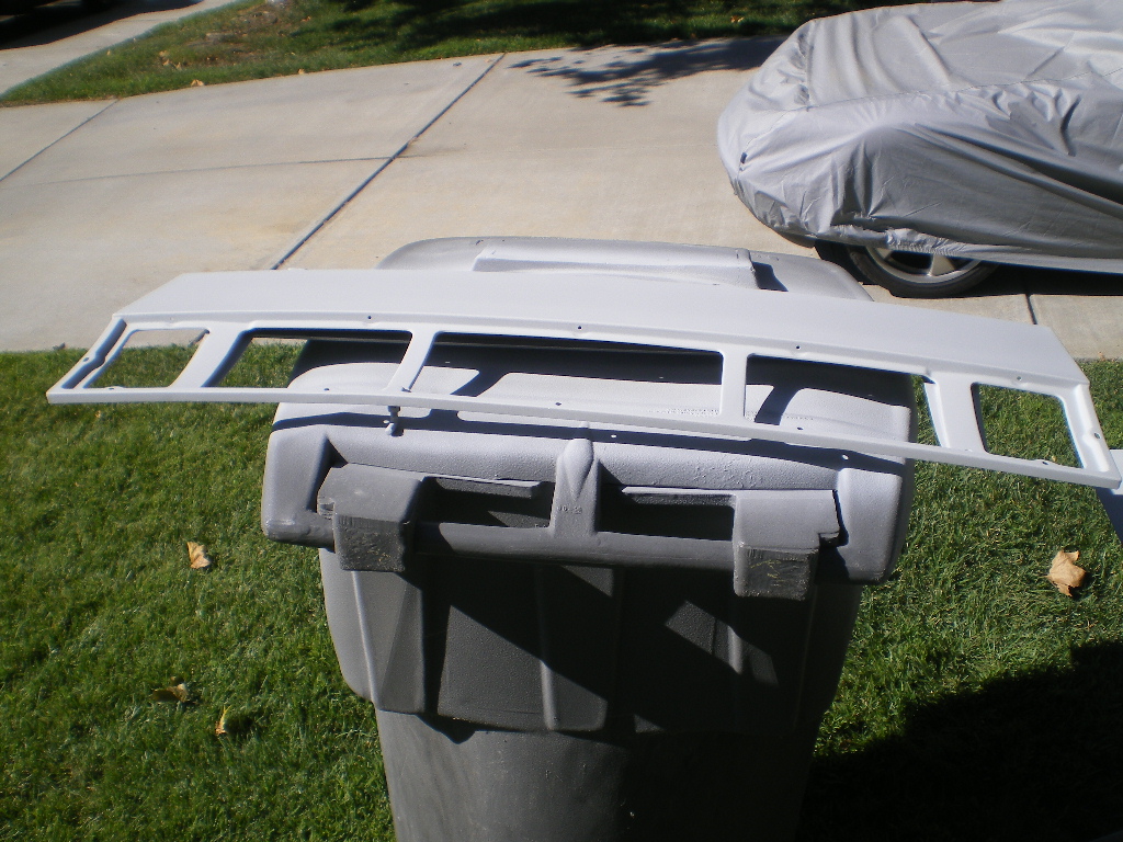

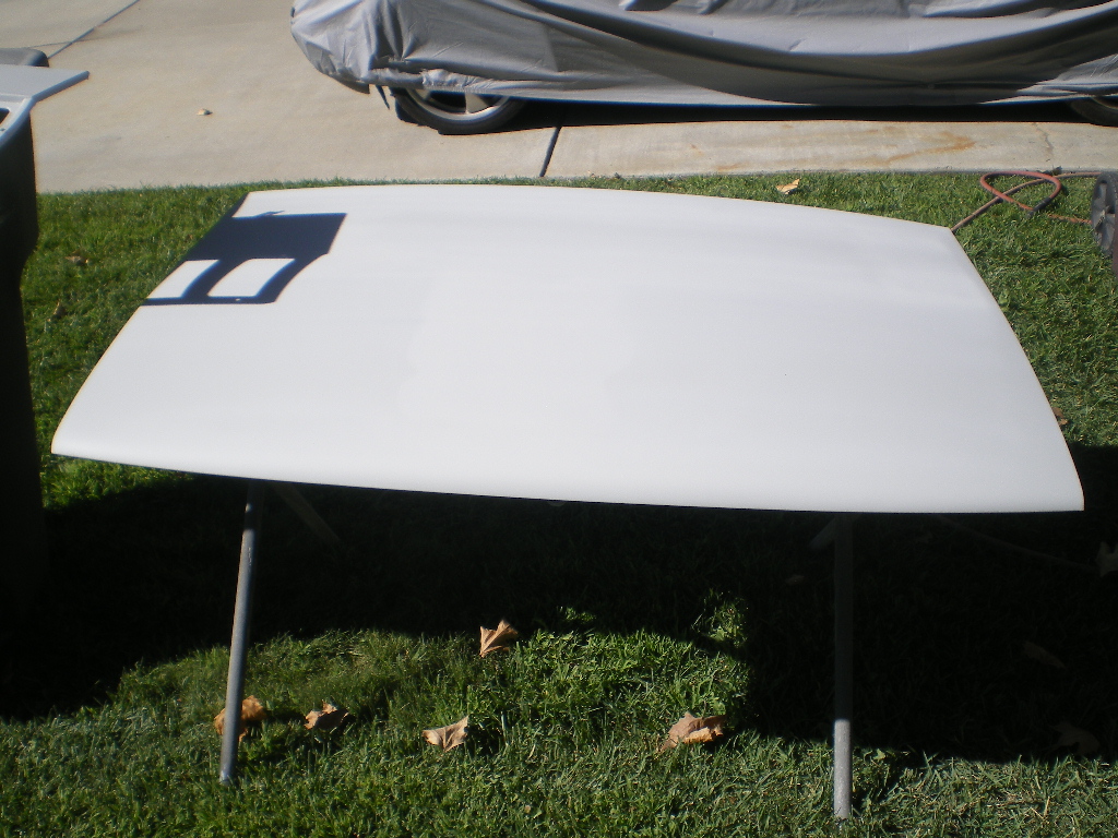

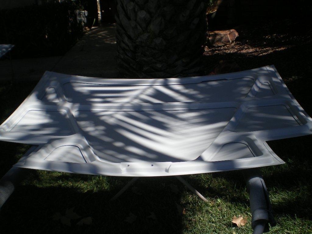

So I covered the naked lass whilst my senses were still about. Crap, I forgot to take a pic of the bottom side of the engine lid. (IMG:style_emoticons/default/headbang.gif) I'll get it later. That was a bitch to cover in primer. I'm glad that a Pro is shooting the paint.

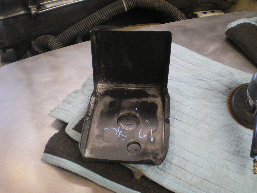

While at the Junk Yard a few weeks ago I looked down and thought to myself, "I wonder". Sure enough it fits like it was made for the 914. The hold down bolt hole even lines up. The nice new batt tray is covered & as a bonus the ECU is protected from the battery. I have no idea what this piece of plastic came off of or what it's intended purpose was either.
