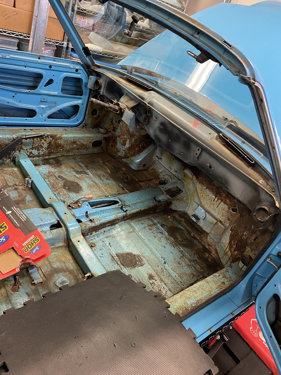

Making a bit more progress on the 914.

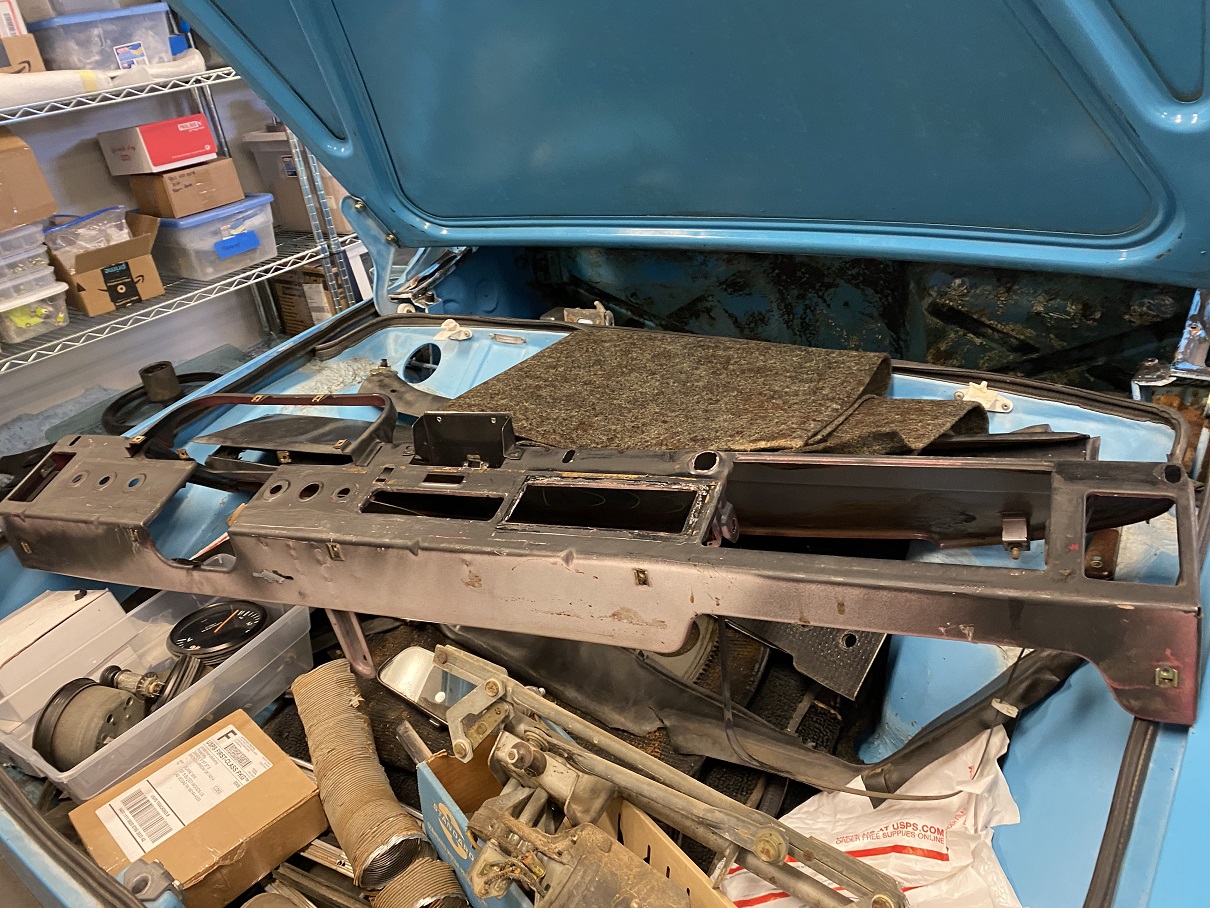

Removed the dash completely.
I noticed the top vinyl pad is tucked under the metal dash, so I decided to remove it entirely in order to put the new pad on since I'm leaving the windshield in. Not too bad of a job, just hard to get to some of those nuts that are in the frunk.
I also removed the remaining crusty rubber seals. These rubber seals were left in the sun for a few years and they are hard as a rock. I can literally snap them in half like a piece of spaghetti.

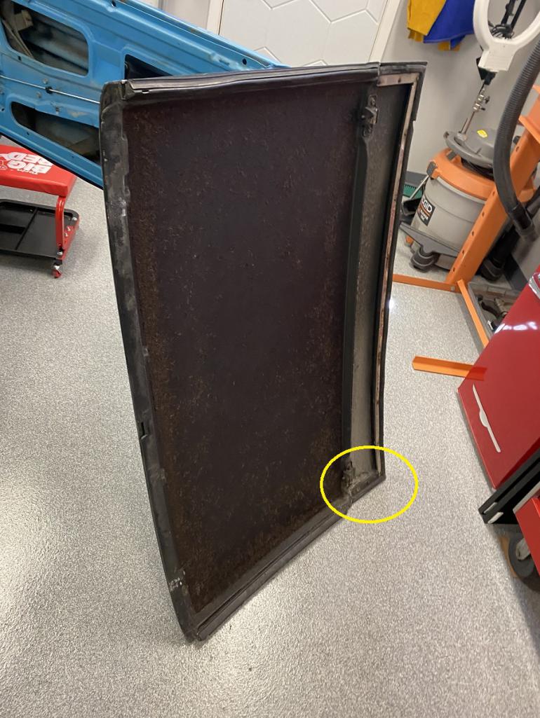

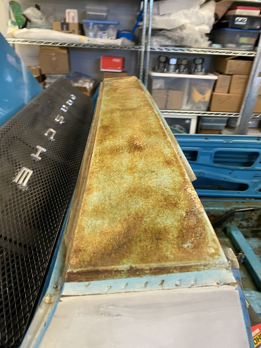

I removed everything off the targa top in prep for paint. I picked up some SEM trim and the plan is to just rattle can it.

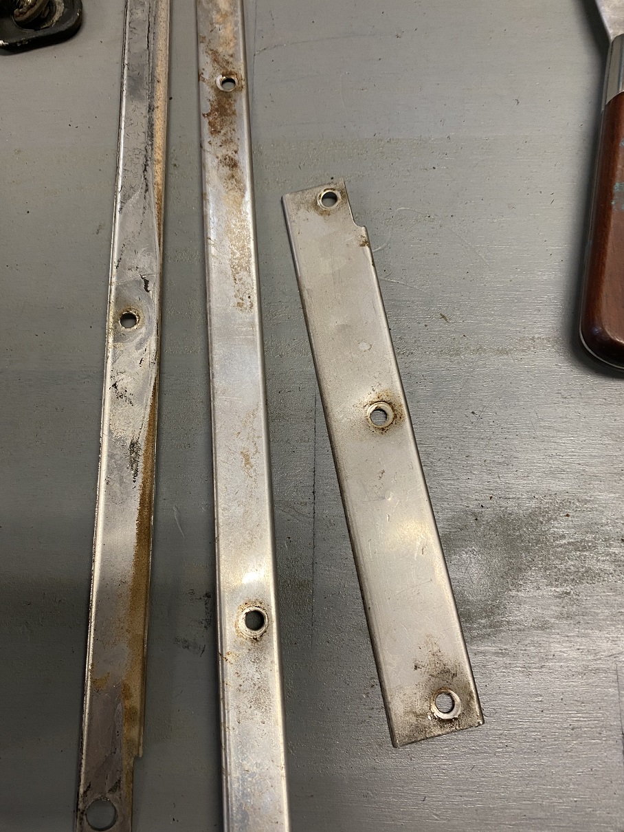

I'm also missing one of the small passenger side aluminum trim strip. If anyone has one for sale please let me know, driver quality is fine.
The rear latches are pretty beat up. I might replace entirely.
I removed the vinyl across the targa bar and the pads and side pieces.

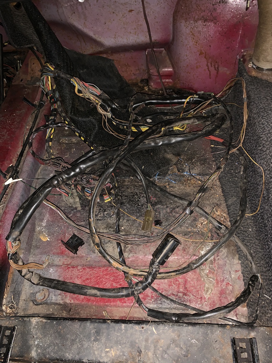

Sourced an entirely new harness from a 76.
If anyone needs bits and pieces from a 75/76 harness, reach out with your request. There are a lot of good parts left on my harness, especially in the frunk and dash.

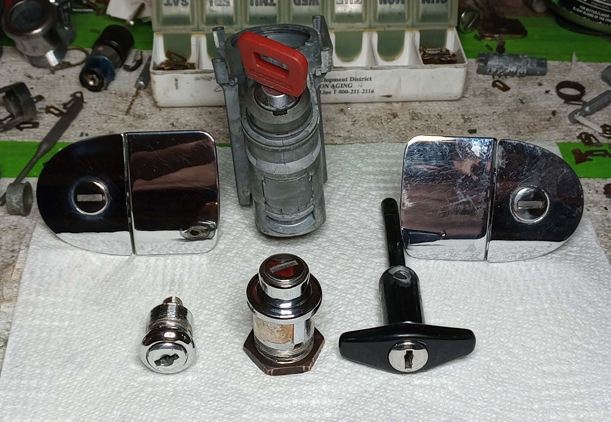

Lastly I got word from Curt regarding my locks. He's waiting for the drivers handle to be finished at the chrome place and will send out. It will be nice have brand new keys and everything working.
