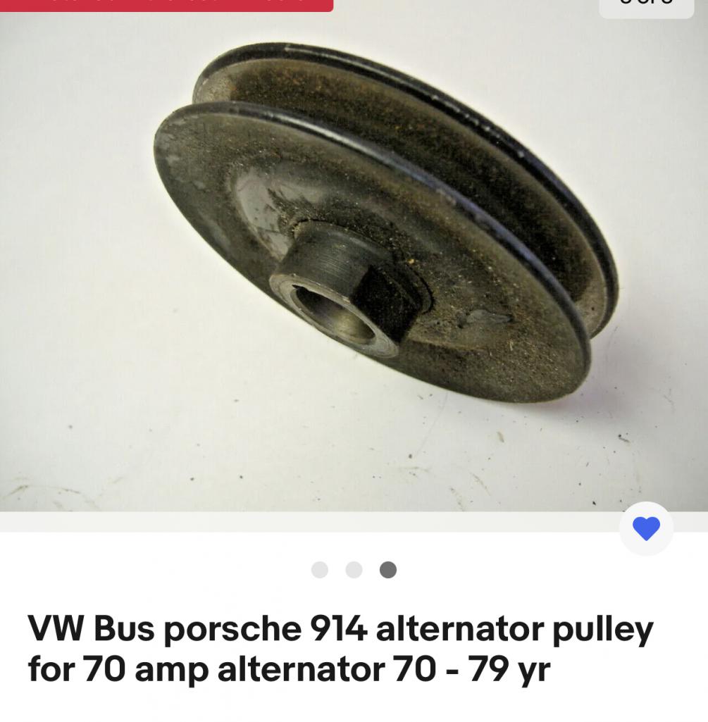

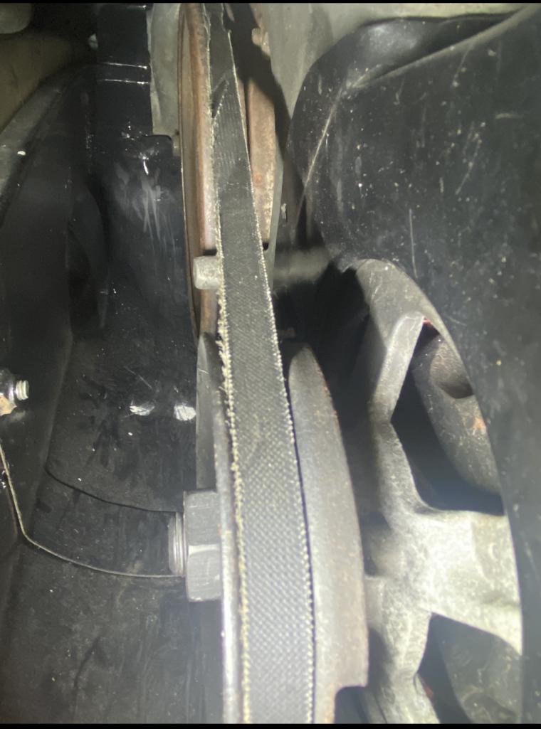

This is my car, with the old belt for now.
I can see pulleys are not parallel. As well as measure. The small pulley is too far to the front. And the small pulley doesn’t look like the one on eBay, which doesn’t have the notches. (I am trying a looser belt, less tension, to see if it stays on longer) Anyone have a photo of their pulley? In an engine sitting in their garage? |

This is my car, with the old belt for now. I can see pulleys are not parallel. As well as measure. The small pulley is too far to the front. And the small pulley doesn’t look like the one on eBay, which doesn’t have the notches. (I am trying a looser belt, less tension, to see if it stays on longer) Anyone have a photo of their pulley? In an engine sitting in their garage? That pulley is on backwards. The cut outs go towards the outside (used to hold the pulley when tightening it). |
