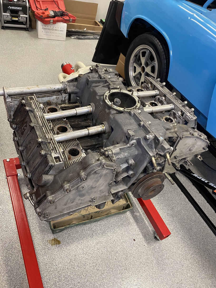

A friend of mine is headed to Ollies this coming week so I decided to get after it and tear the 2.7 down so he could take the major components along.
I think the big thing is to align bore, RR piston squirters, hot tank, vapor blast, and do the case savers. Ollies will also do the crank, the heads including bigger bore, clean the cam tower and RR the oil tube, and rebush the rockers.
I'll go with a nice set of JE P's and C's probably 9.8:1 compression.
MSD ignition, or 123 dizzy.
I have a set of Weber 40's I'll probably move over to this engine.

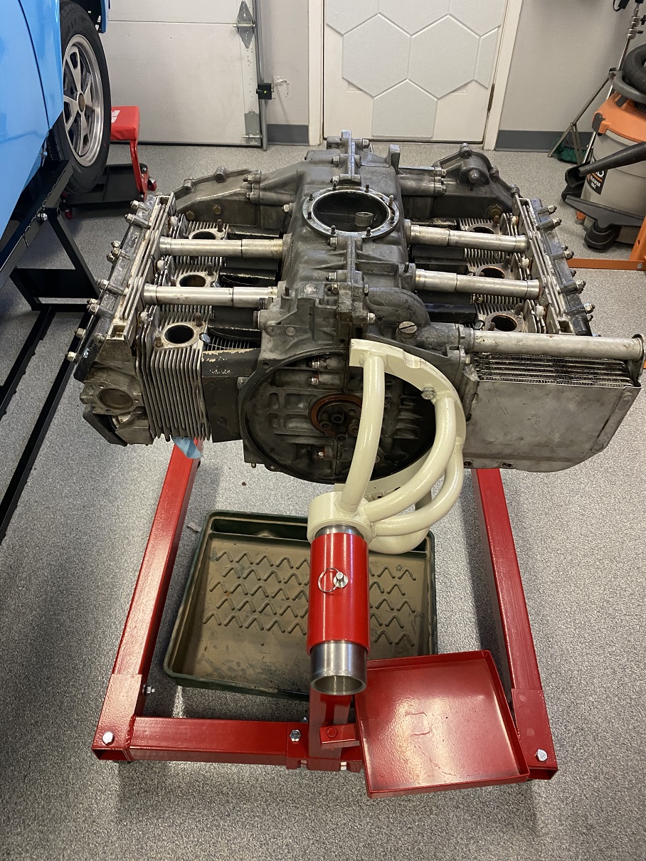

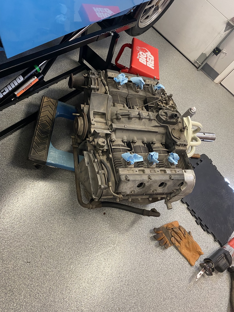

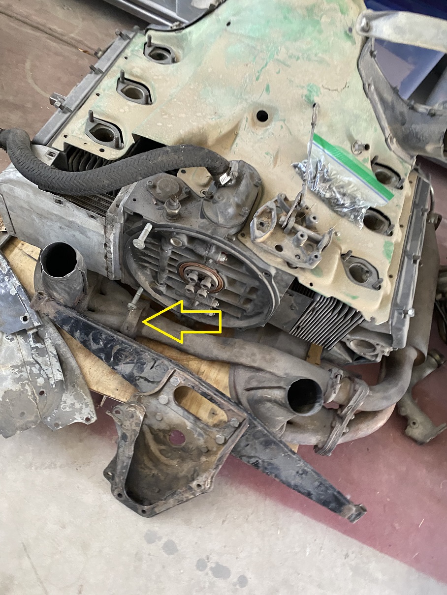

But first I have to tear it down. First was dragging it out from under another project and trying unsuccessfully to remove the early heat exchanger rear cross over pipe.

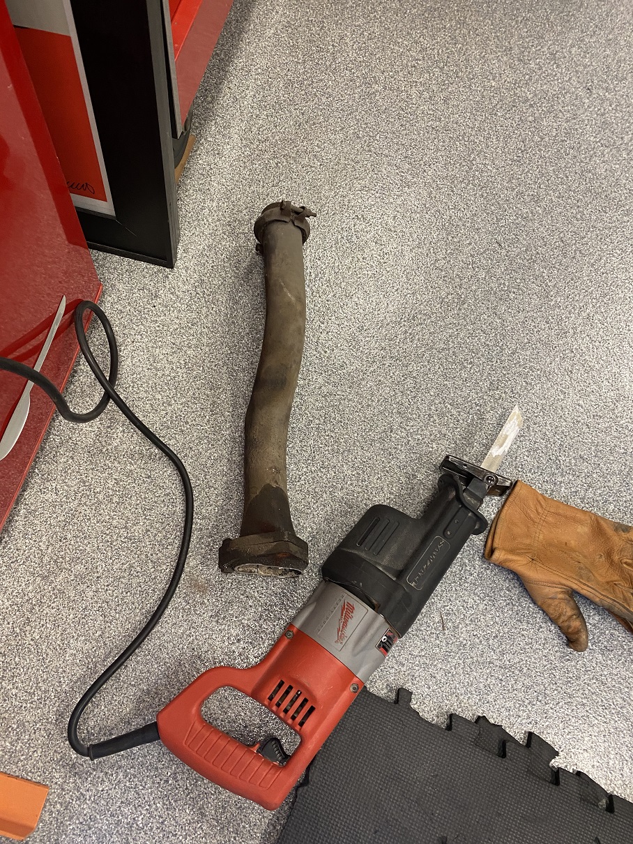

My yoke wouldn't fit on the engine due to the relief not lining up with the crossover pipe flange on the rear of the motor. Swine 'discount off brand yoke'
After an hour of twisting off a few bolts I said "f' it" and just sawzalled through the right side heat exchanger and the crossover pipe.
These original heat exchangers were rusty and had holes in the bottom. Typically, because of the size and weight, It doesn't make sense to sell them as they are only worth about $100 bucks and way more hassle to pack and ship.
Once I got the Yoke mounted, I rallied my neighbors to help me lift it onto the engine stand.

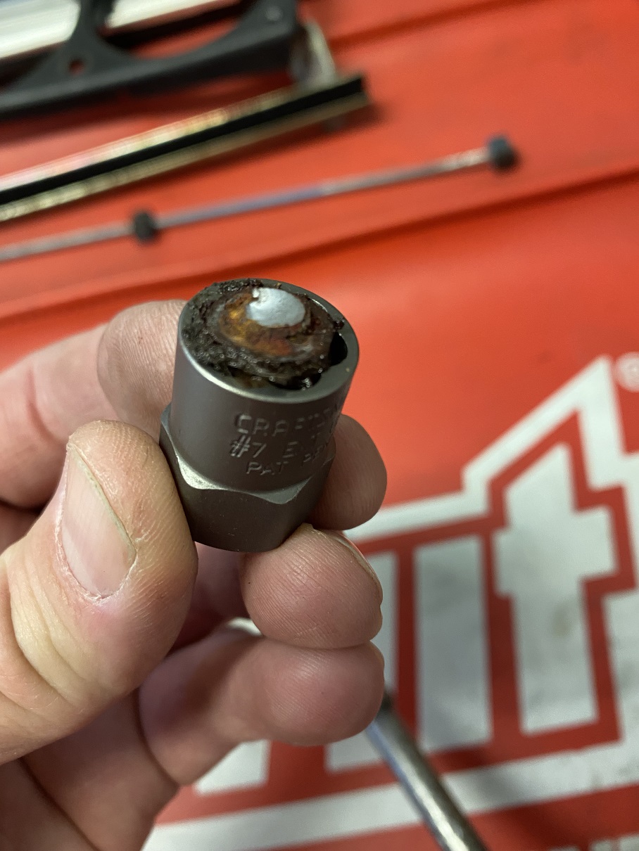

Luckily the nuts holding the exhaust onto the motor were put on recently and came off with little persuasion.
Next up, full tear down and inspection.
