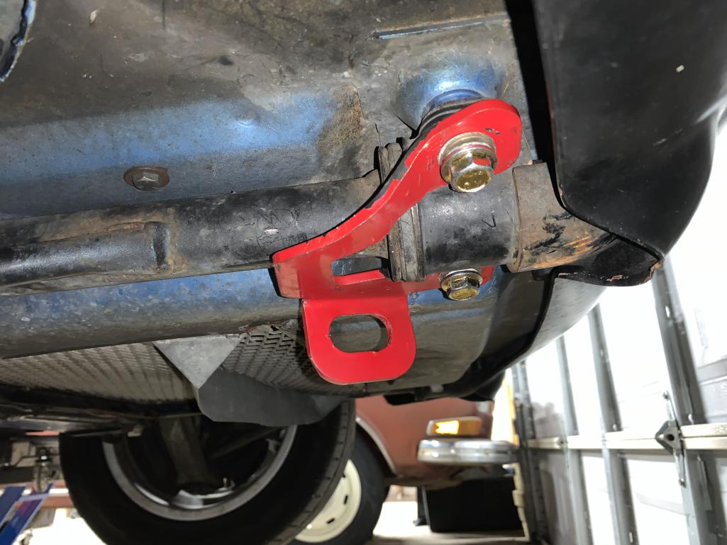

My car has dealership installed AC so the front tow point is gone. I got it with a bent drop link I’m sure was the result of a past tow. I’m trying to figure out what my options are and found these tie downs from Jman. Has anyone used these or something similar? If so I would really appreciate a picture of one installed.

Here is the way I ended up installing it. Had to modify it a bunch. Depending on what Chris’s looks like I might change it to his.

mlindner   Yes, those are 911 type and will fit. But, not wit...   Sep 5 2022, 06:19 AM
AzGuy238   I have them on my 1976 and they seem to work fine ...   Sep 5 2022, 06:25 AM

TX914   I have a similar situation and looked into a tow l...   Sep 5 2022, 06:34 AM

AzGuy238   I actually reversed them and only use the two bolt...   Sep 5 2022, 11:44 AM

Superhawk996   By turning those around and eliminating the 3rd fa...   Sep 5 2022, 01:07 PM

ChrisFoley   It really shouldn't be between the a-arm carri...   Sep 17 2022, 05:55 PM

914werke   Confused about intended use? Title says "Tow ...   Sep 18 2022, 07:54 AM
jdamiano   Confused about intended use? Title says "Tow...   Sep 18 2022, 08:24 AM
ChrisFoley   I’m trying to add a good place to hook a tow c...   Sep 18 2022, 08:42 AM

ChrisFoley   That looks ok as an emergency tow point - as usefu...   Sep 25 2022, 03:53 AM
