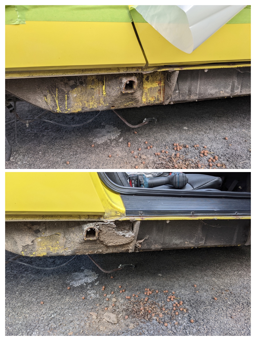

I did some sand blasting in the engine bay yesterday and realized that I will need to learn how to do body soldering/tinning/leading or whatever you want to call it. I’ll post more on that tomorrow if I get the blasting all done. For today though, I cleaned up my mess from poor taping, retaped the car, and took the rockers off… more acorns! The PO tried his damnedest to kill this car. 90% of the rust issues I’ve found were under piles of acorns.
Both sides had a decent stash, but the passenger side still had one bedroom apartment in there. The Ziebart gave its life to save the longs (IMG:style_emoticons/default/flag.gif)
