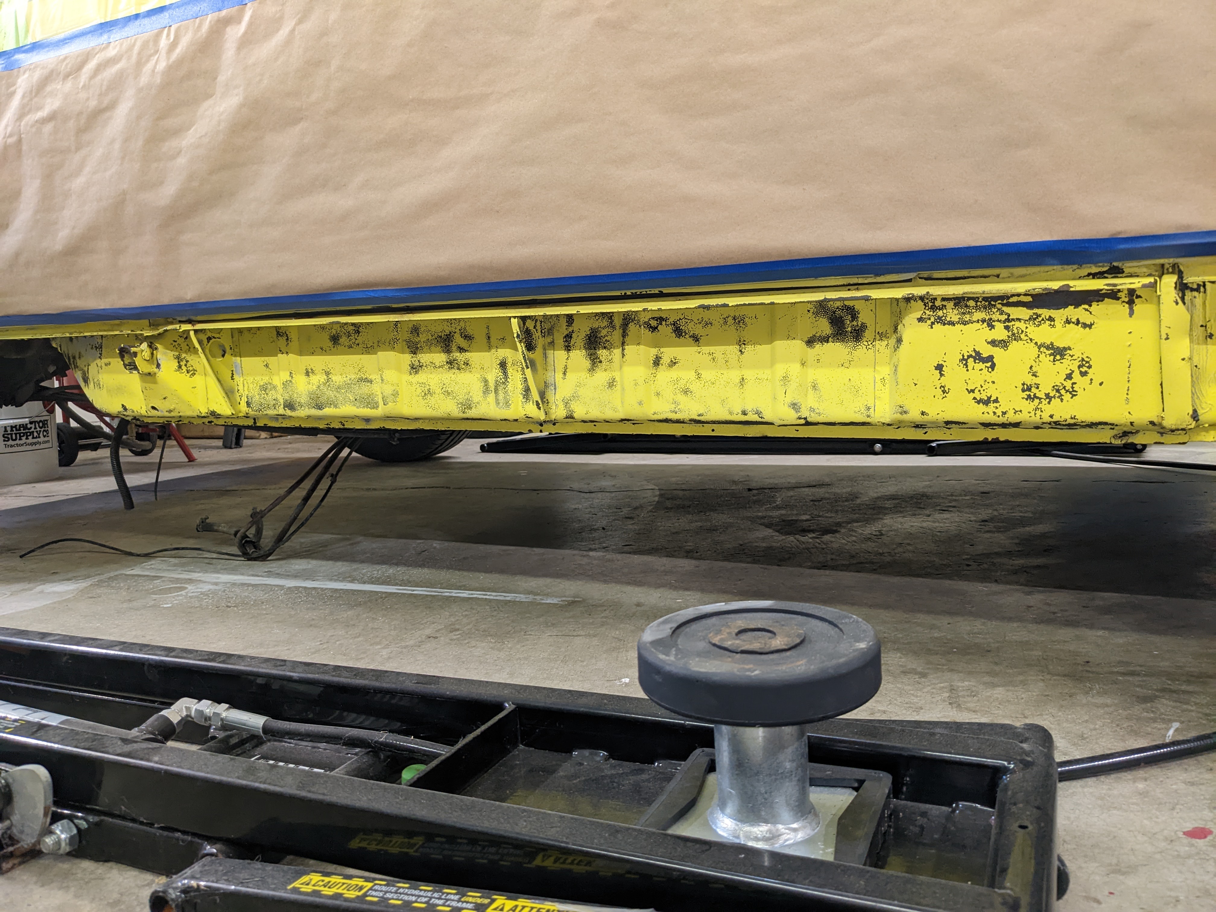

post Sep 25 2022, 10:53 PM
Posts: 1,621
Joined: 20-October 21
From: WR, GA
Member No.: 26,011
Did some fine grit soda blasting on the longs… definitely got lucky there!

Van B   Did some fine grit soda blasting on the longs… d...   Sep 25 2022, 10:53 PM
