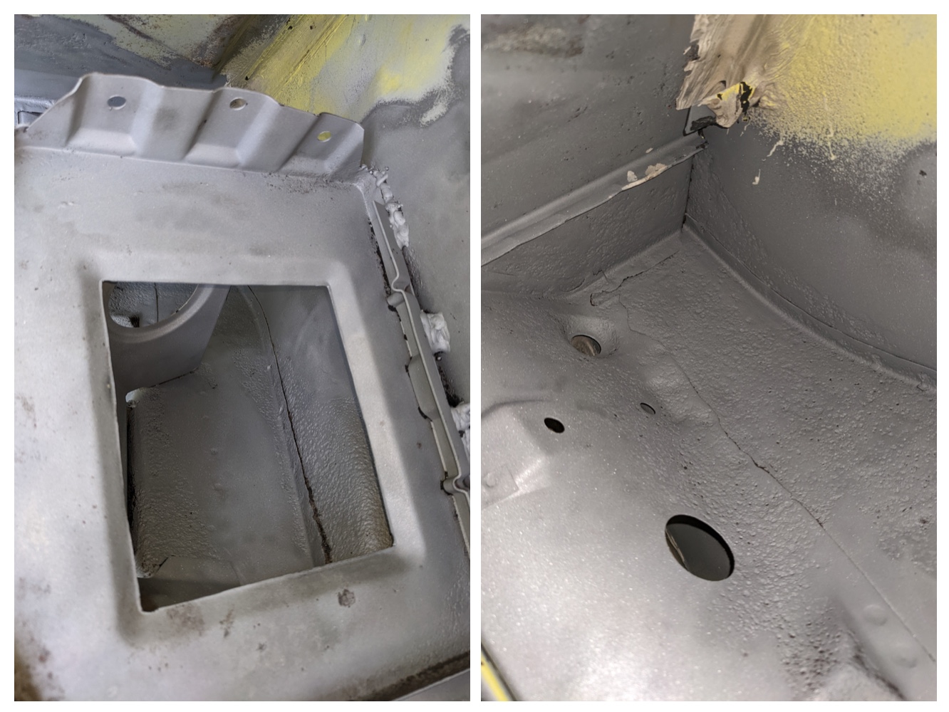

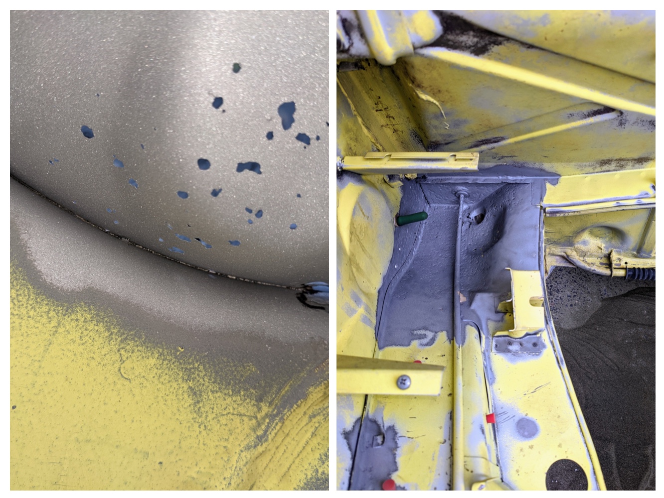

As for the engine bay, I’ve finally reached the bottom of the rabbit hole… and I found some Swiss cheese on the drivers side. I’ve spent a lot of time in there and despite the perforations, the metal is still strong. So, I’ve decided to do some tinning (lead free). Nothing is structural, thank you Lord! I even ran a scope down into the longs and everything is very clean on the inside.

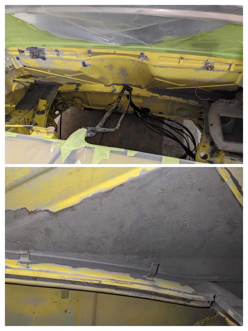

Van B   Getting a little behind on updates here. I know t...   Oct 12 2022, 11:15 PM
Van B   After the firewall, a lightbulb came on that resul...   Oct 12 2022, 11:18 PM
