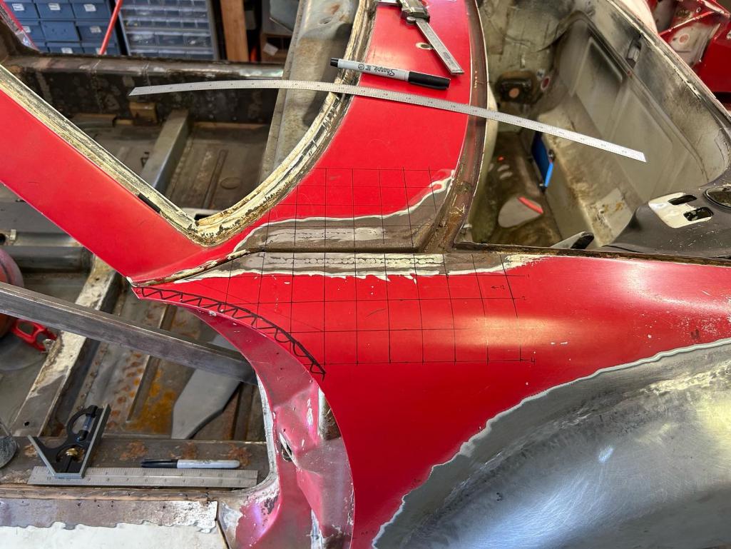

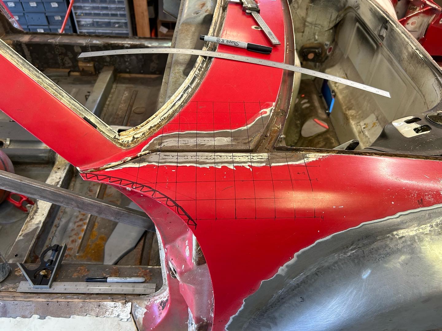

pencap914   Update: So I bought this car knowing the tub was ...   Mar 14 2021, 10:29 PM
mate914   Most all of the rear pillar strength comes from be...   Mar 15 2021, 07:27 AM
pencap914   Most all of the rear pillar strength comes from b...   Mar 15 2021, 10:15 AM

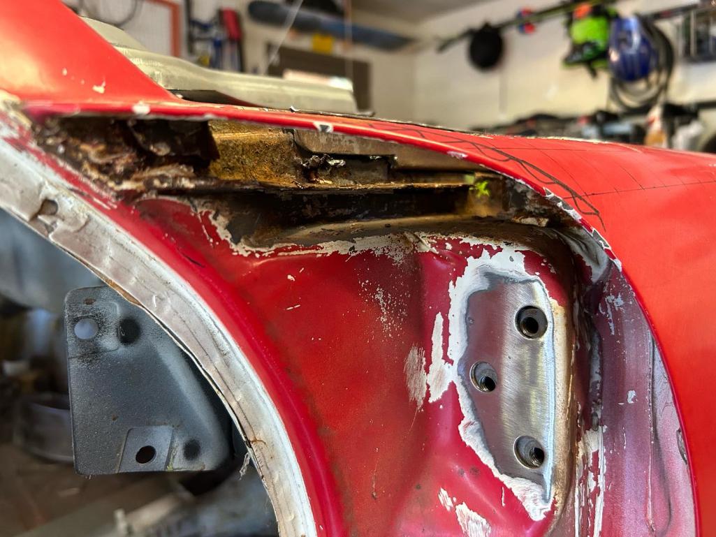

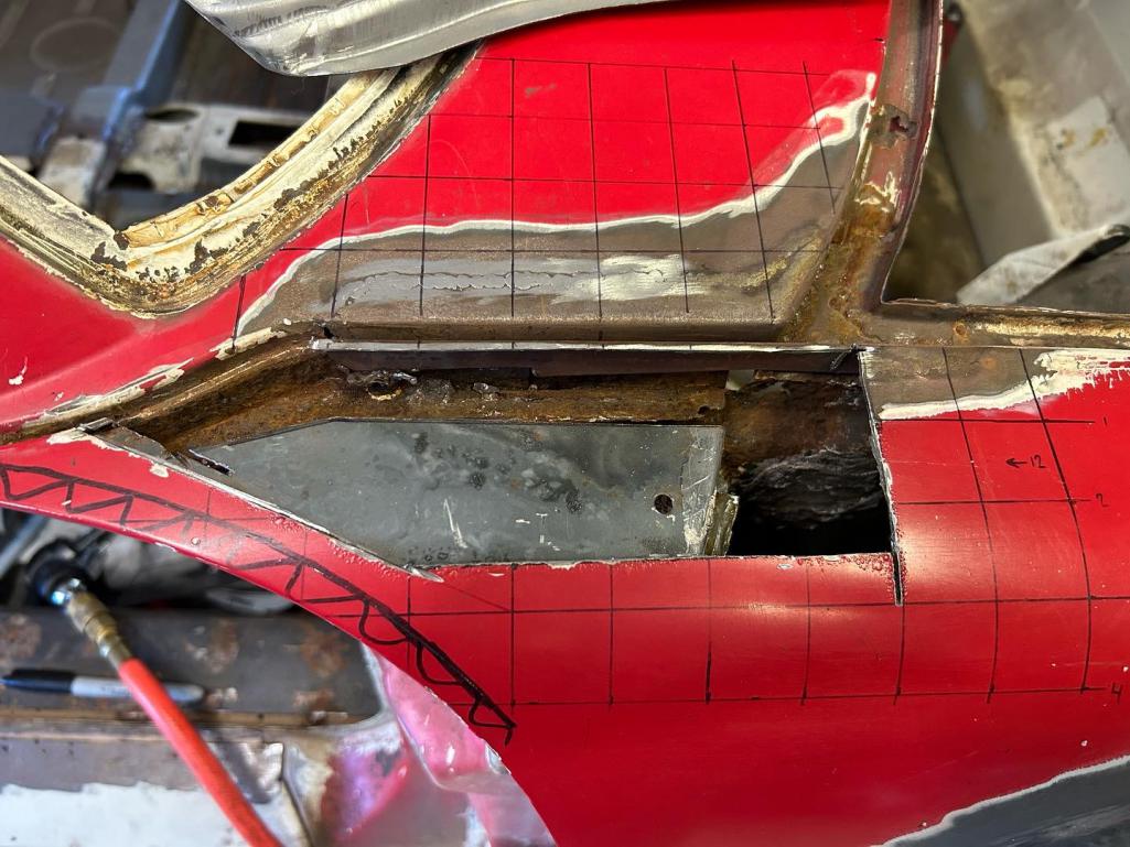

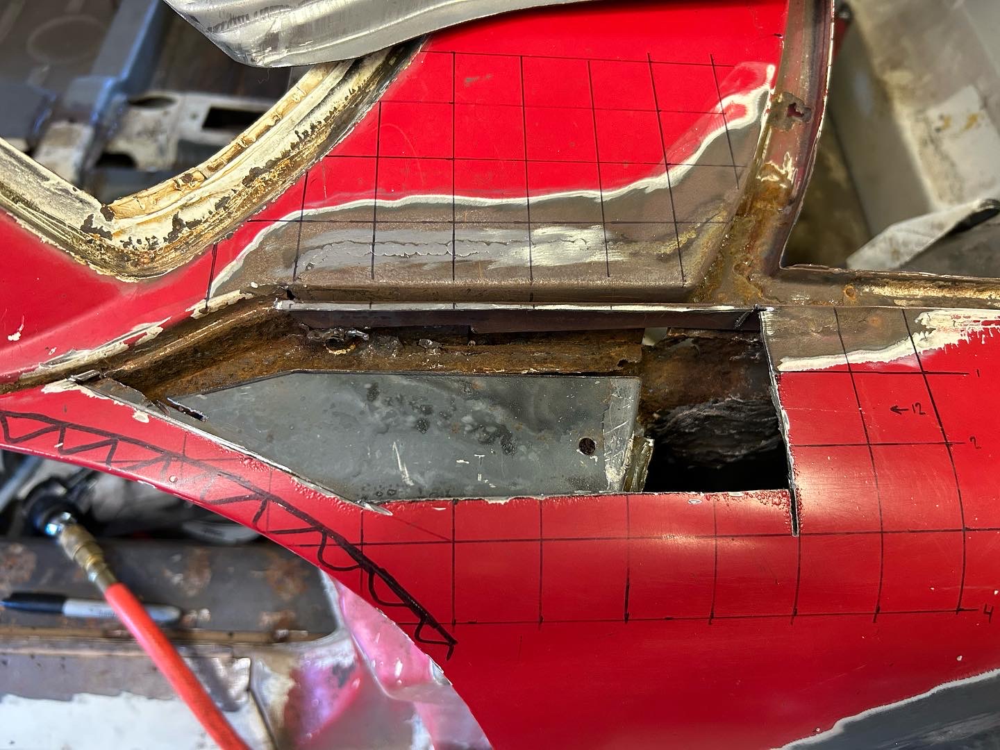

pencap914   Well, finding more issues with some of the previou...   Mar 23 2021, 11:04 PM
mate914   Well, finding more issues with some of the previo...   Mar 24 2021, 09:02 AM
