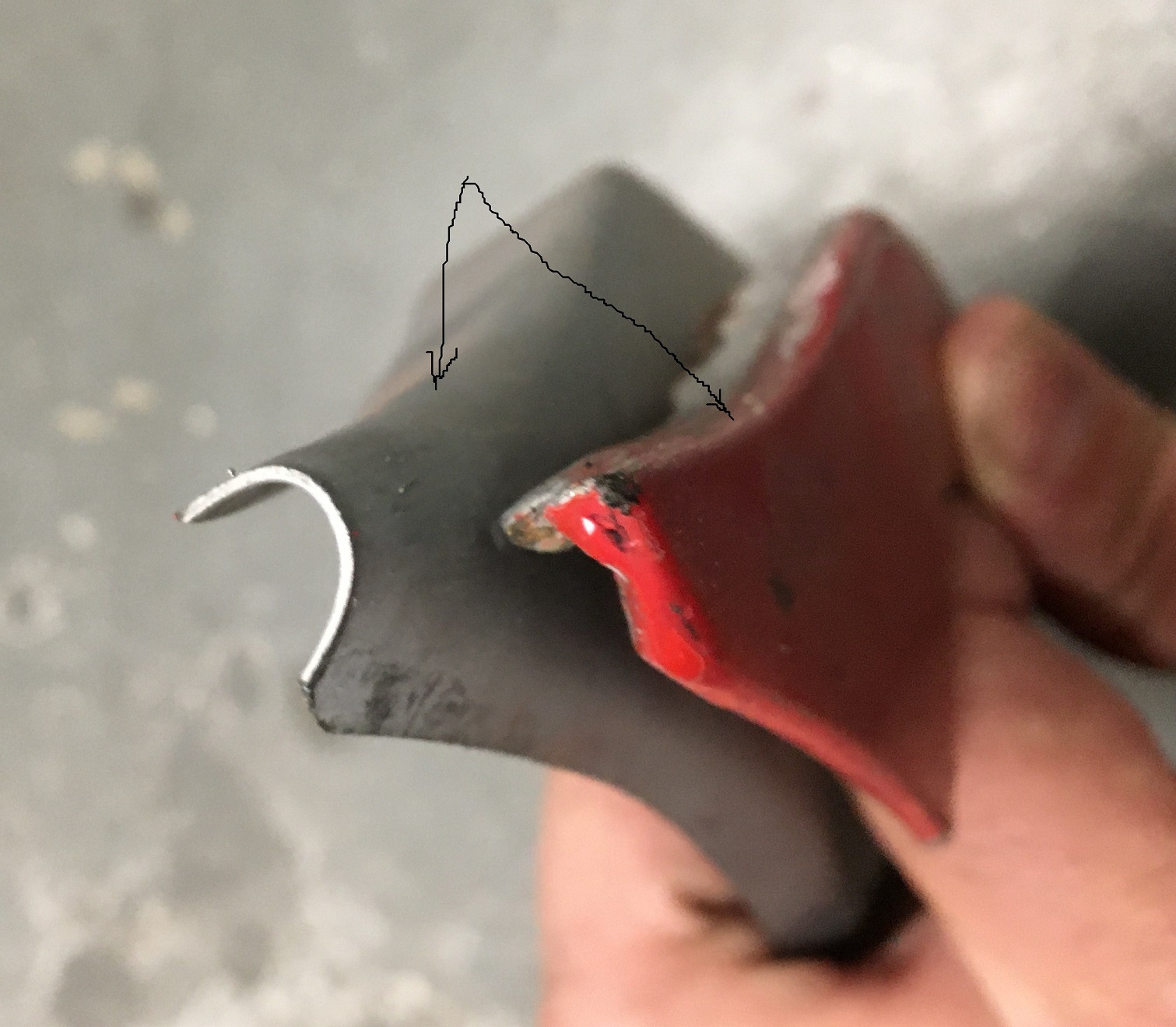

pencap914   Finally after a year of avoiding it I decided to o...   Sep 29 2022, 08:48 PM
Montreal914   I like the approach you are using. Seems like you ...   Sep 29 2022, 09:29 PM
Montreal914   This is what I am referring to... <_< Th...   Sep 29 2022, 09:37 PM
pencap914   @montreal914 Thanks for sharing that. Yeah I...   Sep 29 2022, 11:23 PM
