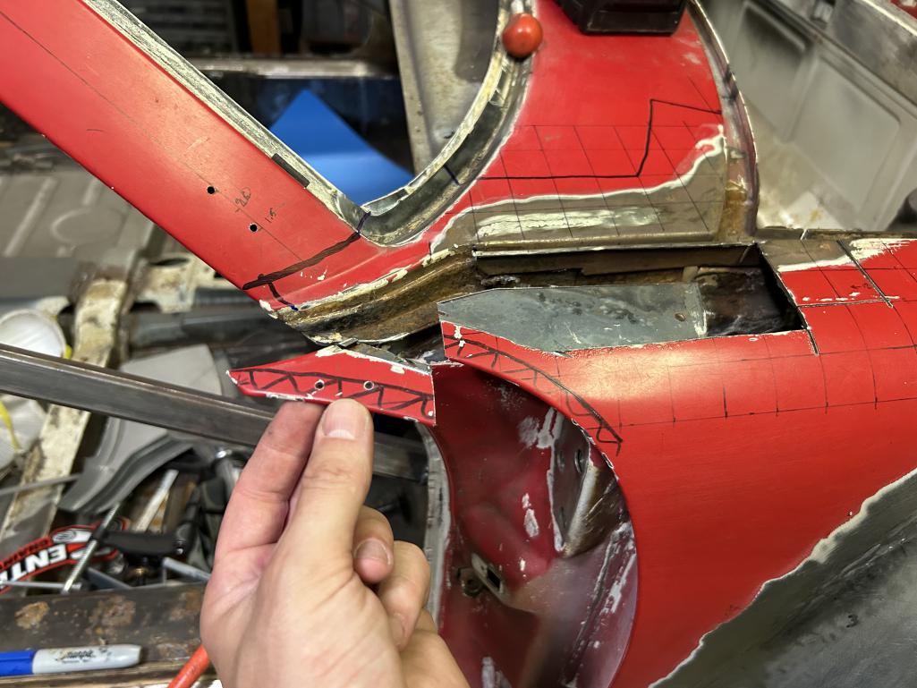

pencap914   Finally after a year of avoiding it I decided to o...   Sep 29 2022, 08:48 PM
Montreal914   I like the approach you are using. Seems like you ...   Sep 29 2022, 09:29 PM
Montreal914   This is what I am referring to... <_< Th...   Sep 29 2022, 09:37 PM
pencap914   @montreal914 Thanks for sharing that. Yeah I...   Sep 29 2022, 11:23 PM

pencap914   Made some more progress on the cowl repair:   Oct 23 2022, 08:42 PM
pencap914   RE: My '74 Budget GT Tribute build   Oct 23 2022, 08:45 PM
pencap914   RE: My '74 Budget GT Tribute build   Oct 23 2022, 08:46 PM
