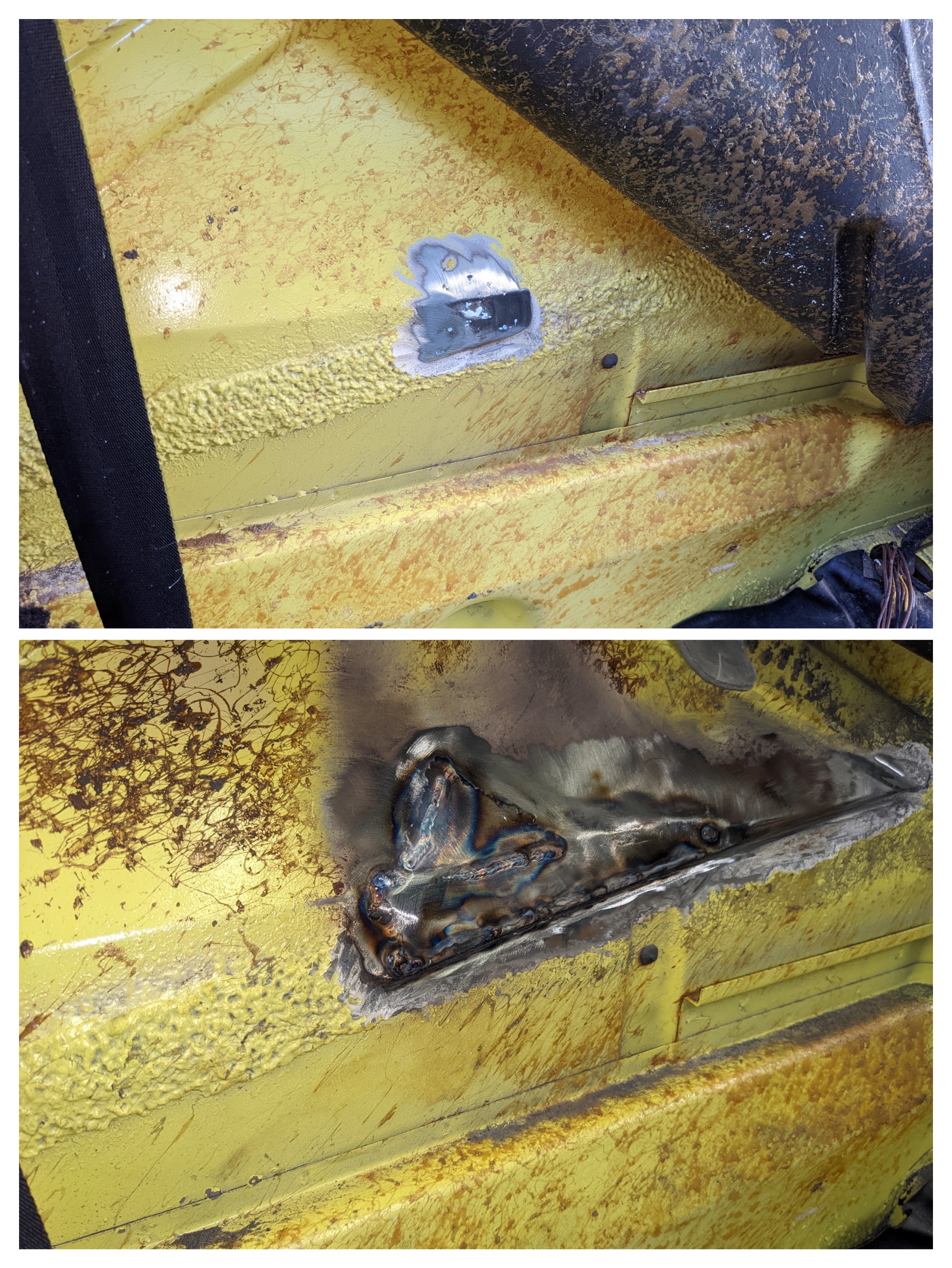

I decided that welding was going to be required in a few spots. I decided to start with the firewall just because it was easier access. Unfortunately, what I thought was going to be one spot expanded rapidly once I was both sides. I’m not real happy with how it turned out and will probably go back in there with correct thickness metal in the future. It for now, it’s super solid and will have its ugliness hidden.
