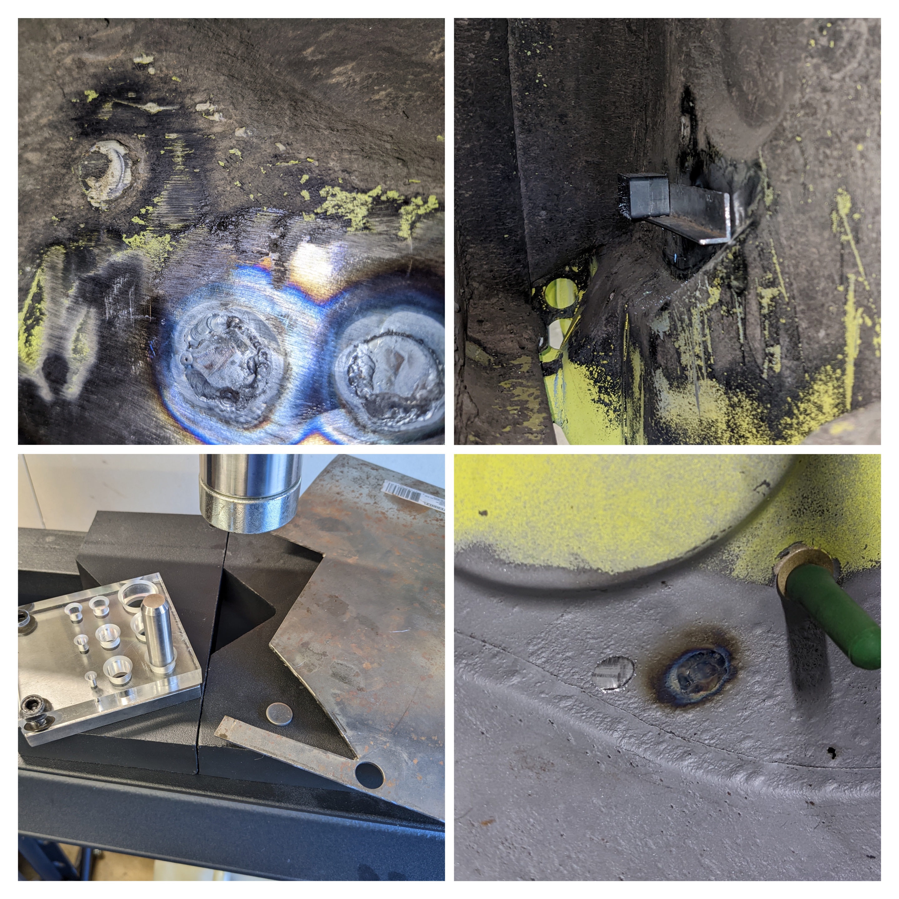

After the firewall, a lightbulb came on that resulted in a trip to harbor freight for a punch and die set. I adopted the technique of making plugs. I reamed out the larger holes and welded in perfectly fit plugs. I used some aluminum angle and some magnets to keep them from falling through. You have to watch out with how close the magnet is to the welding arc or the magnetic field will destabilize your arc. 6” of aluminum gave enough separation though. And, it also did a pretty good job of holding onto some backing gas. I really like this method if you want to save a panel.
