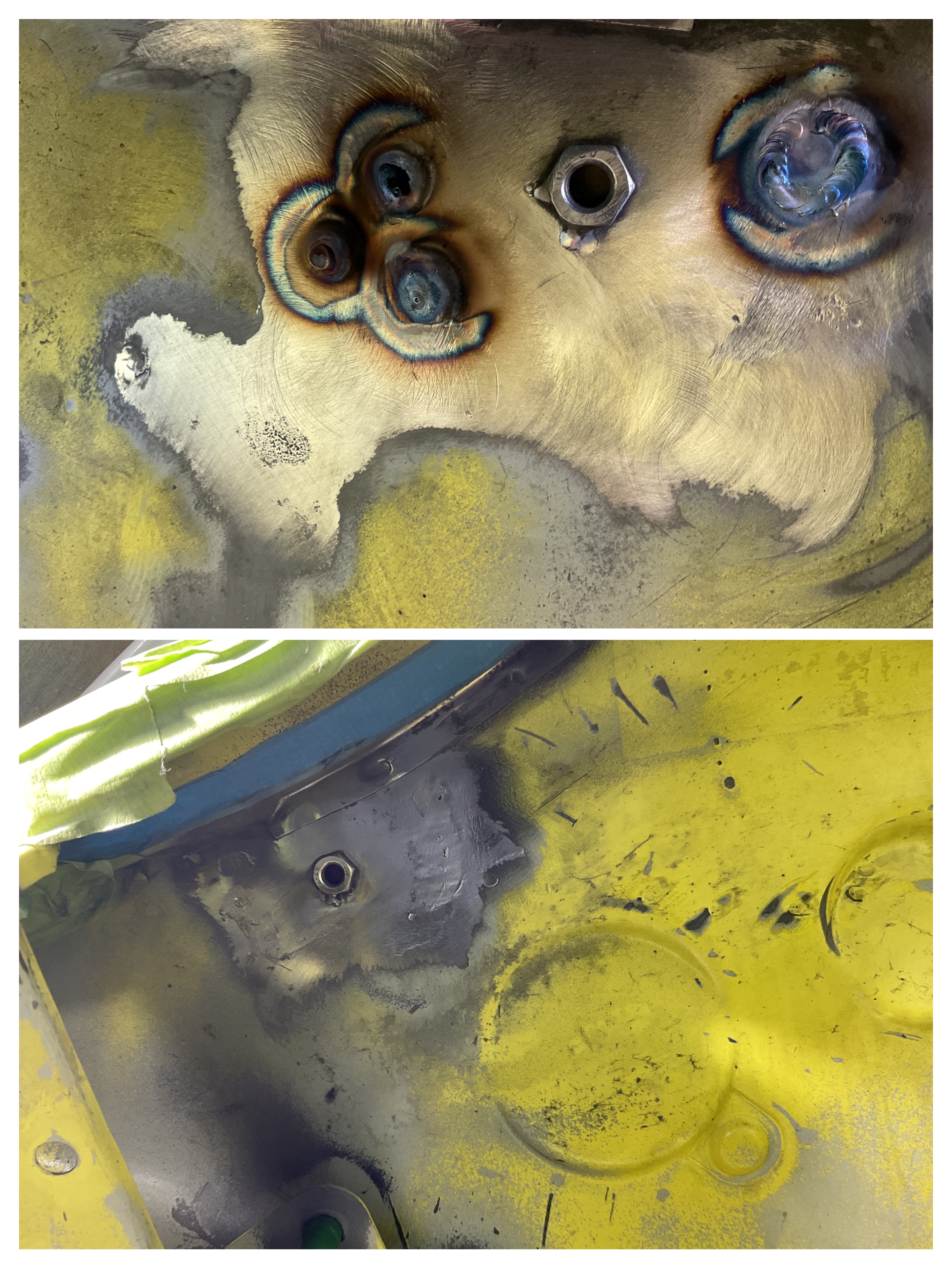

Been working on the trunk hinges:
It was super difficult to to but I managed to tack a nut in place by threading a bolt through the original hinge. I couldn’t get photos because I was struggling so bad to make those tacks through such a tight space. After I got those in I had to repair some tears that had been hiding behind the poor hinge repair.
