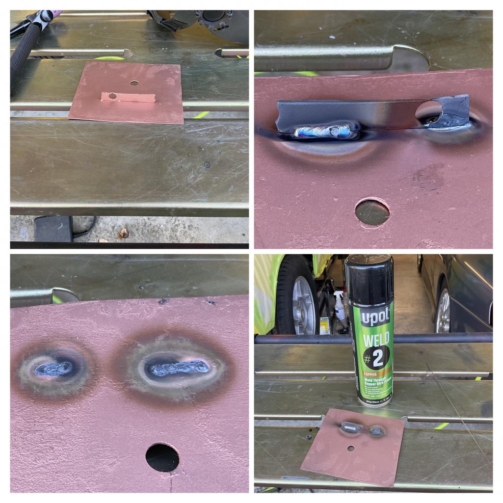

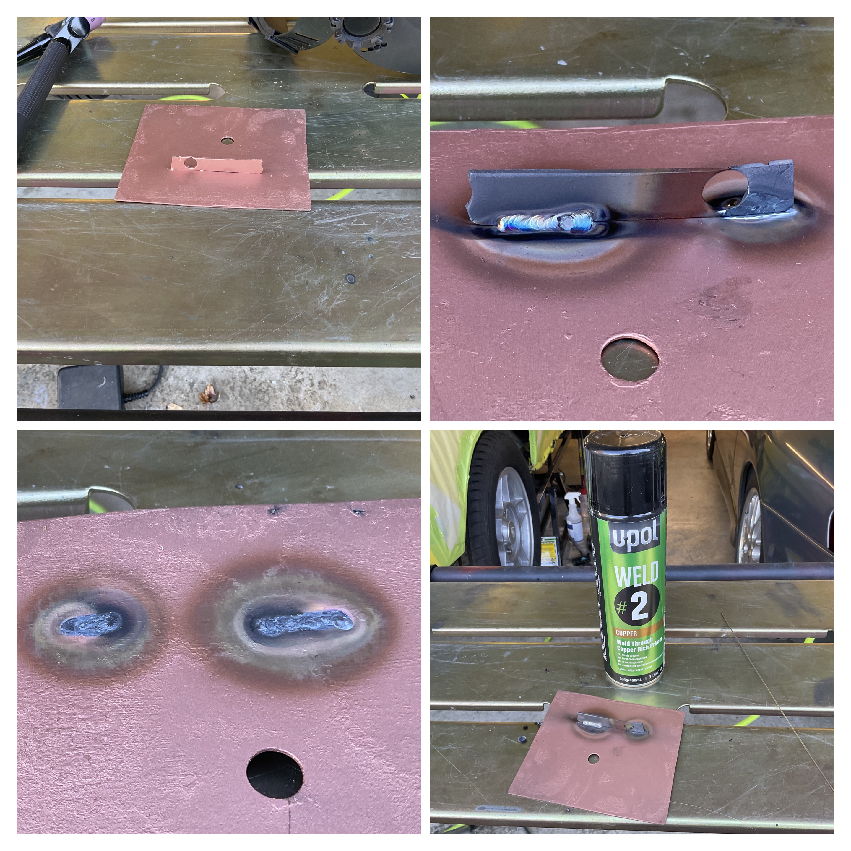

Then I decided it would be wise to test out this fancy copper based weld-through primer I bought. I’m actually very impressed! It burns away real clean under the tig arc and holds up pretty well around the weld.
