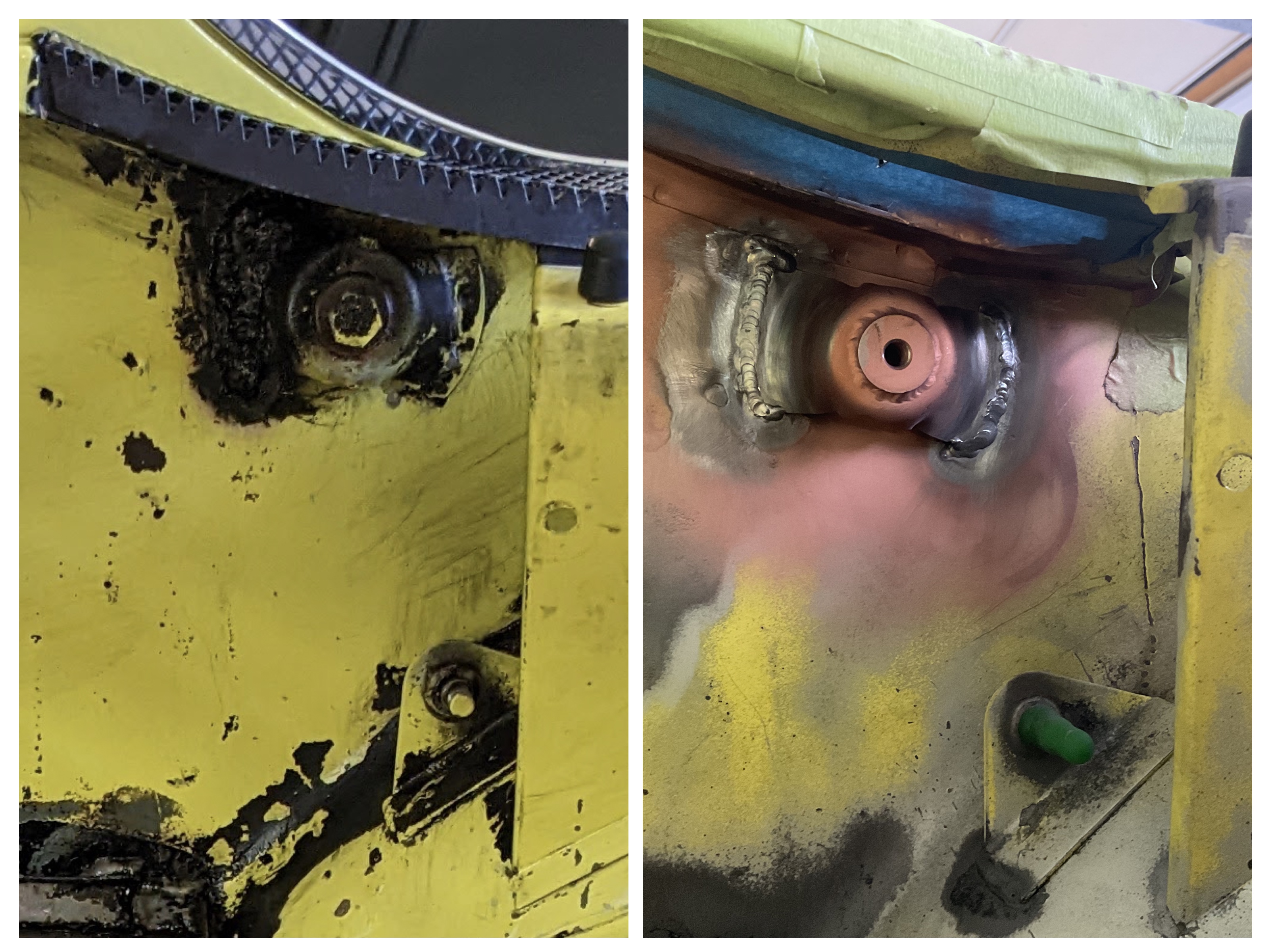

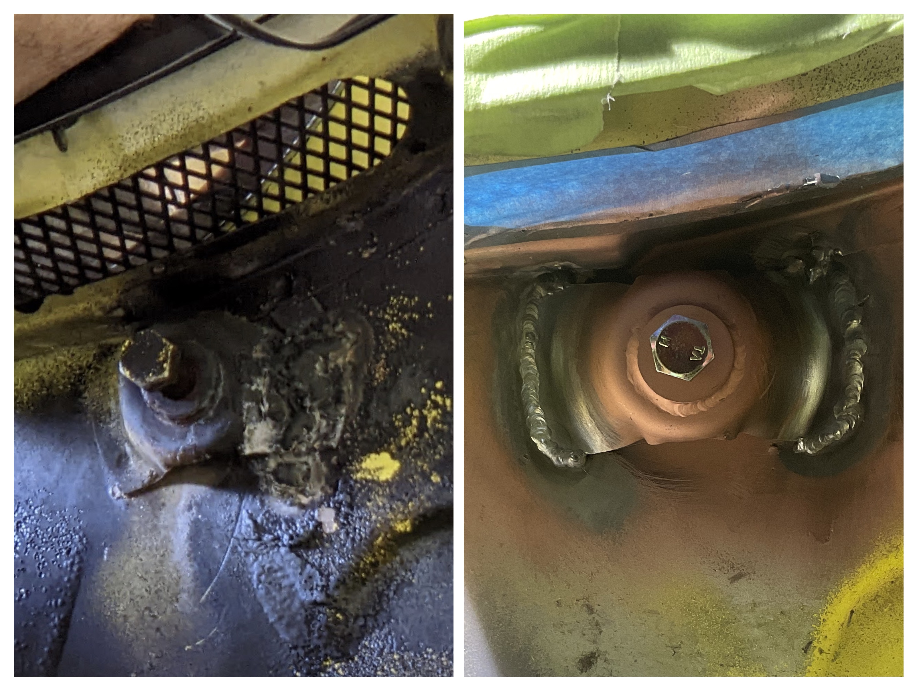

Van B   Been working on the trunk hinges: It was super di...   Oct 15 2022, 09:52 PM
Van B   Then I decided it would be wise to test out this f...   Oct 15 2022, 09:53 PM
Van B   New hinge assembly time: Decided to radius the ou...   Oct 15 2022, 09:58 PM
Van B   And this is where I ended up tonight: I got the h...   Oct 15 2022, 10:01 PM
Van B   Glad I thought of the nut as an alignment tool, de...   Oct 16 2022, 03:43 PM
Van B   No doubt those birdshit welds put a lot of trash i...   Oct 16 2022, 03:49 PM
wonkipop   copper weld through primer is good stuff. used a l...   Oct 16 2022, 05:20 PM
