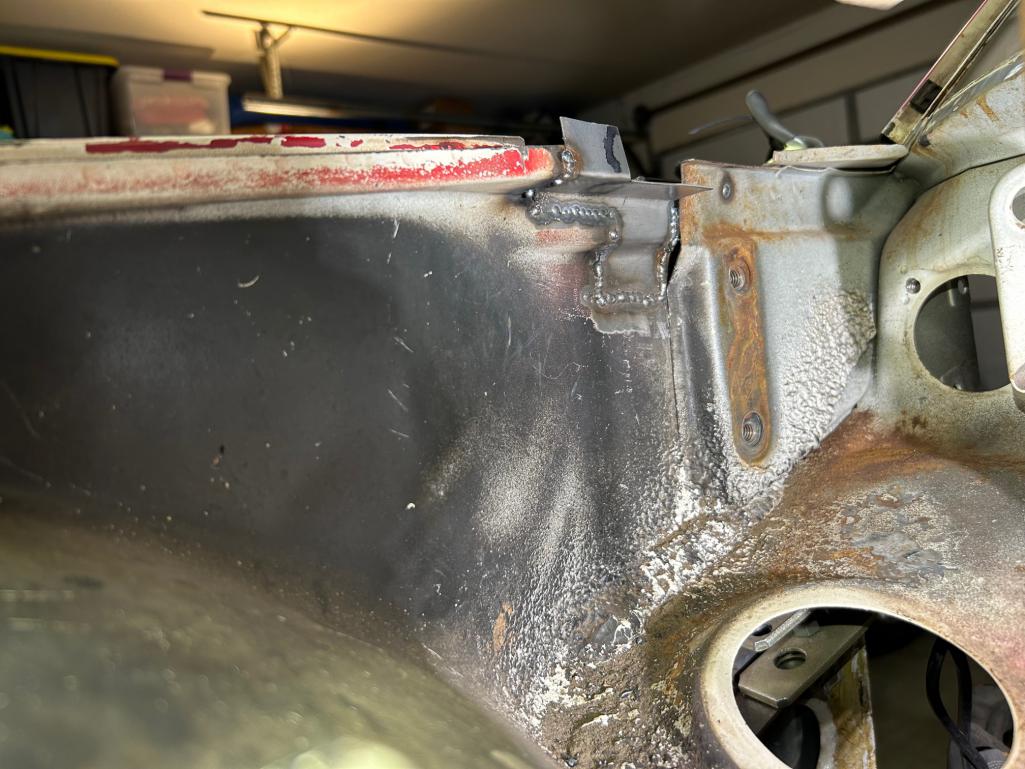

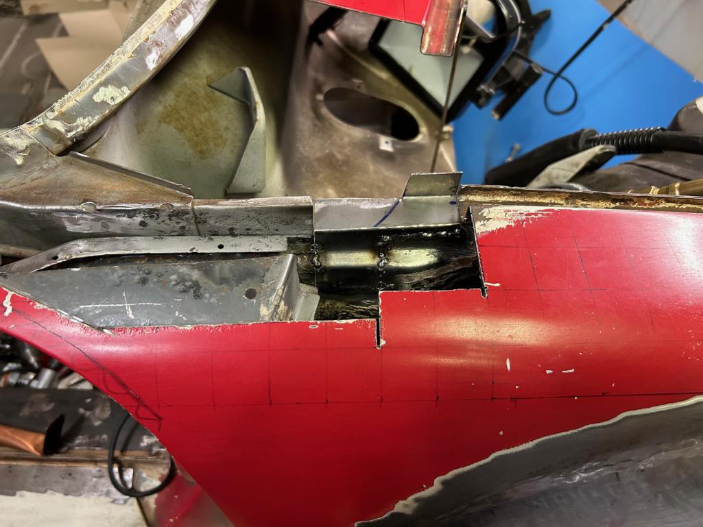

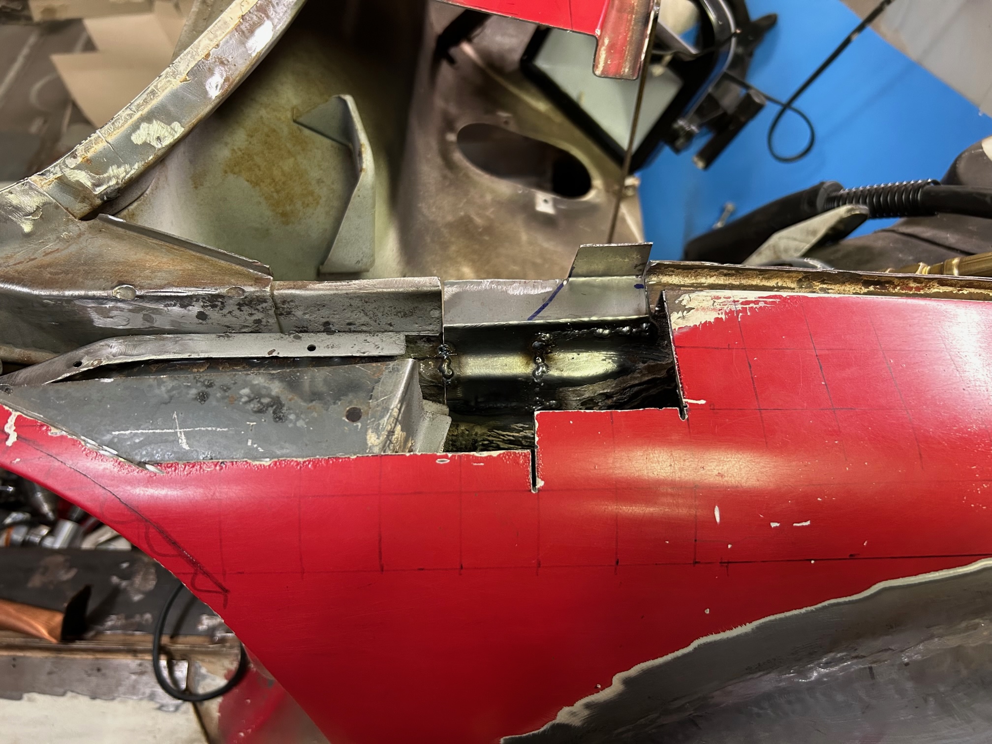

pencap914   Made some more progress on the cowl repair:   Oct 23 2022, 08:42 PM
pencap914   RE: My '74 Budget GT Tribute build   Oct 23 2022, 08:45 PM
pencap914   RE: My '74 Budget GT Tribute build   Oct 23 2022, 08:46 PM
Graydingo   Inspiring metal work!   Oct 24 2022, 06:15 AM
Cairo94507   That is looking very, very good. :beer2:   Oct 24 2022, 06:42 AM
Retroracer   Nice skills there! Keep the posts coming.... ...   Oct 24 2022, 02:55 PM
pencap914   Todd, I used a PPG 2K paint in a "SprayMax...   Oct 27 2022, 10:12 AM

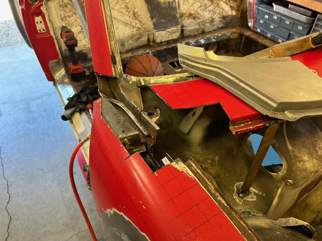

pencap914   Made a patch panel inside the passenger side frunk...   Aug 7 2023, 10:18 PM
TRS63   Slowly but surely you will be driving it ! Tha...   Aug 8 2023, 02:47 AM
Montreal914   Very nice progress! Both of these cowl repairs...   Aug 8 2023, 07:37 AM
pencap914   Very nice progress! Both of these cowl repair...   Aug 8 2023, 09:58 PM
