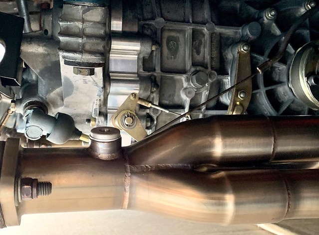

(IMG:http://www.914world.com/bbs2/uploads_offsite/live.staticflickr.com-21-1666631352.1.jpg)

campbellcj   http://www.914world.com/bbs2/uploads_offsite/live....   Oct 24 2022, 11:09 AM
