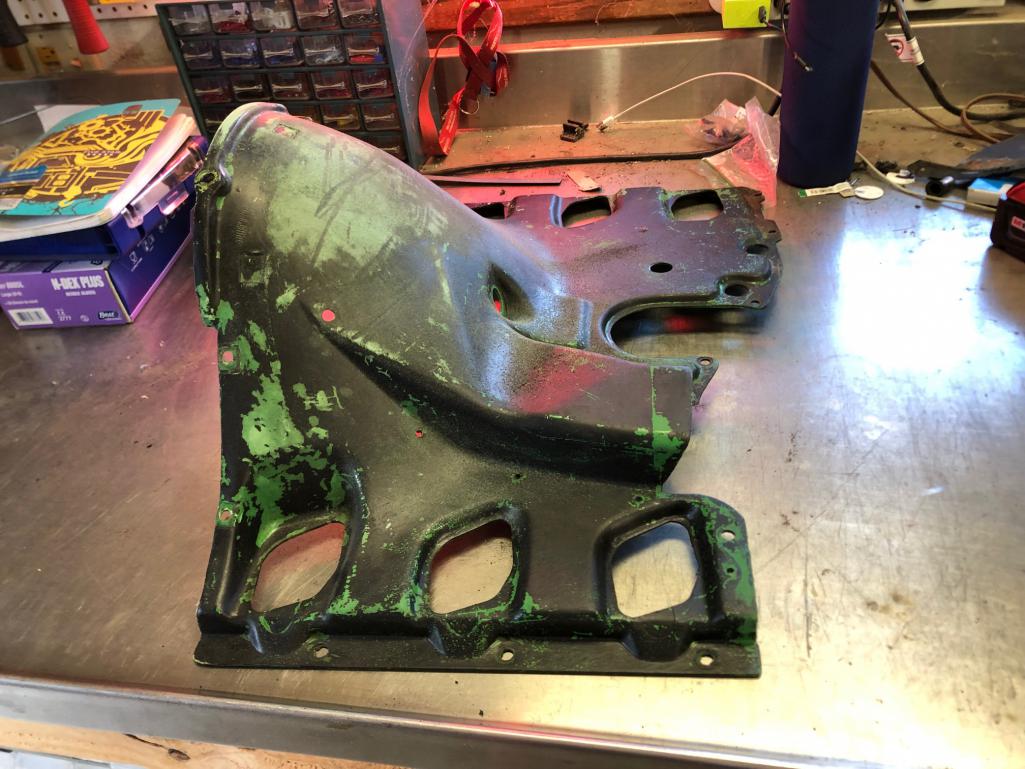

Also working on restoring the fiberglass engine shroud for the 2.7. Few cracks in the fiberglass will have to be addressed, then sanded and painted. This week I'll stop buy the automotive paint shop to talk about what would the best paint options would be for this. A fiberglass engine shroud is a challenging place for automotive paint....

[quote name='pencap914' date='Nov 7 2021, 09:26 AM' post='2958276']
Inspiring work! (IMG:style_emoticons/default/beerchug.gif)
I'm at a cross roads as to what paint to use on my engine shroud (3.0 Carrera ) that's resistant to fuel and oil. Did you find a good product. I'm think about PPG single stage. thanks, Todd

pencap914   Todd, I used a PPG 2K paint in a "SprayMax...   Oct 27 2022, 10:12 AM
