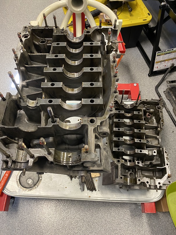

Was able to finish tearing the engine down. timeserts galore, a little over half of the timeserts came out with the head studs. I heat the stud with a MAP torch, then used my trusty snapon collete stud remover. It's one of my favorite tools. It just works awesome and trying to do it any other way would be nearly impossible. Double nuts? maybe. But this thing is quick and easy.
I split the case which was easy. I made absolutely sure all nuts were removed, then just gently tapped with a mallet.

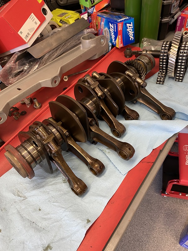

Then I removed the crank. Bearings are in good condition actually, but will obviously replace.

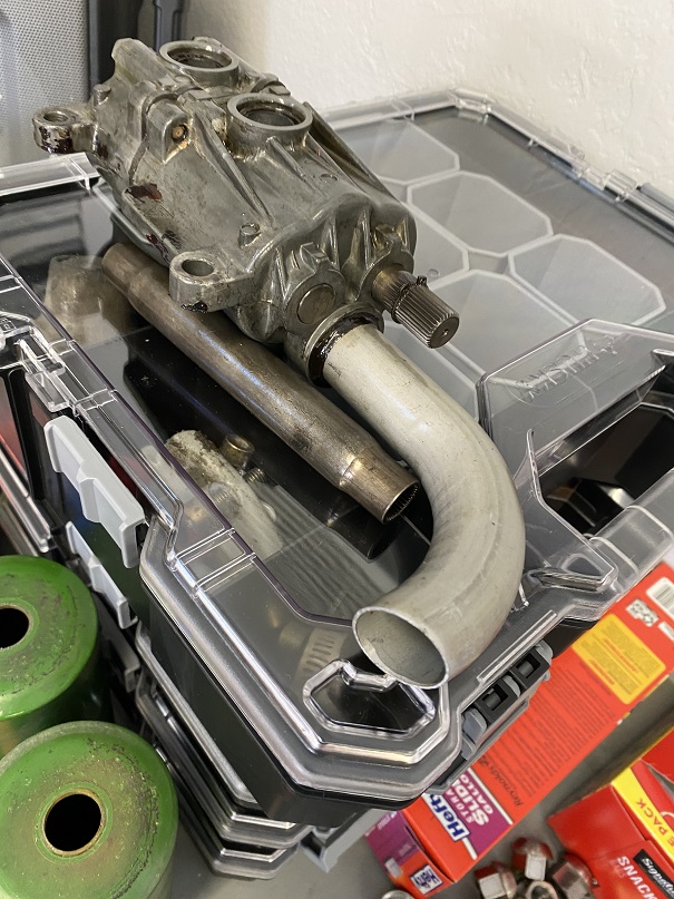

The oil pump came out and looked good as well. I have a fresh Glen Yee Pump from years ago when I was planning a more mild rebuild on my 3.2 engine. I've since gone nuts on that one with a gt3 pump, so I'll probably put the 4 rib carrera pump in this engine.

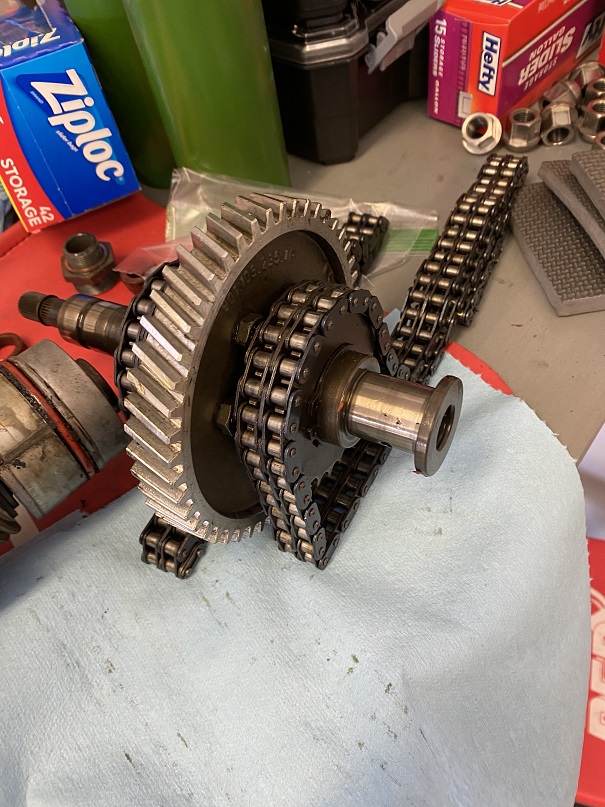

The IMS gears are good, no chips in the aluminum gear that I see yet. Chains have been replaced previously, but will get new ones obviously.
