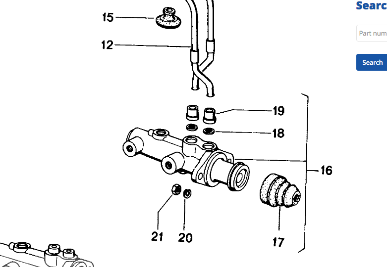

I was reading somewhere here about how difficult it is to get the tubes from the reservoir into the grommets on the master cylinder. I greased them up with caliper assembly lube and they slipped in as easy as a 50 year ol....well lets just say they went right in.

There are no washers. The incoming lines are flared and go into already installed rubber grommets.

QUOTE(pcdarks @ Apr 7 2021, 09:16 PM) *
There are washers and they are 100% needed.
