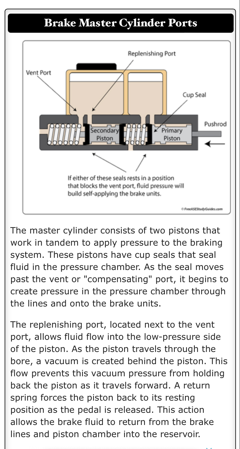

Thanks for the response. I have a 75 with the SB 350 conversion and am having trouble figuring out why my brakes are getting locked up after driving about 1-2 miles. I put a new mc on along with new caliper kit on the front 911 vented brakes. In the process of rebuilding back 914 brakes now. I cannot figure why in the world this is happening. I did have slight brake pad rubbing on the rears but very slight. Do I need a pressure regulator for the brakes? It's like they slowly apply until they completely lock like an E-brake. After sitting about an hour they release. Am totally stumped.
Superhawk996
post Oct 27 2022, 06:31 AM
Posts: 8,048
Joined: 25-August 18
From: Woods of N. Idaho
Member No.: 22,428
QUOTE(JLance67 @ Oct 27 2022, 02:52 AM) *
Pedal misadjusted and/or blocked compensation port is likely cause when brakes begin dragging after heating up and will not release until they have cooled.
@jlance67
You should have a pressure regulator for the rear brakes - has nothing to do with the brakes dragging but has everything to do with safety. I won’t go into the details - it has been covered extensively in other threads. It was put there to avoid rear brake bias which is dangerous.
