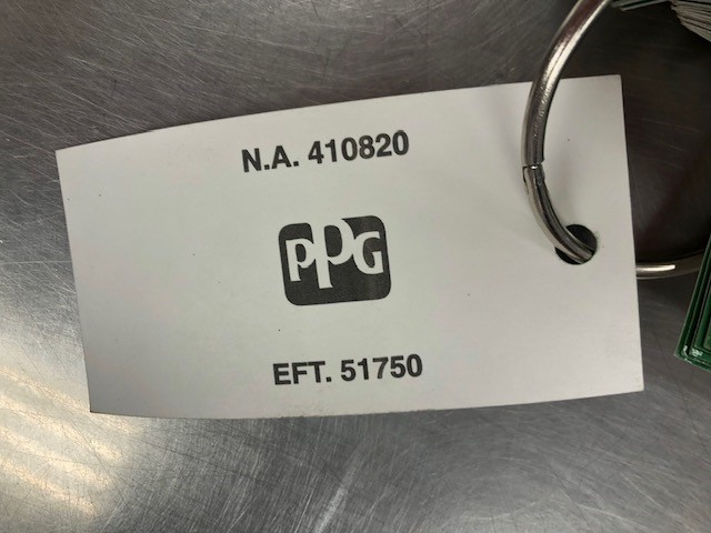

Todd,
I used a PPG 2K paint in a "SprayMax" can where the hardener is built into the can. My local automotive paint shop mixed it on site and said it should hold up to heat/fuel better than regular ol' spray paint. Here's the photo of what shade of green matched pretty close to the original green color the shroud was.

pencap914   Todd, I used a PPG 2K paint in a "SprayMax...   Oct 27 2022, 10:12 AM
