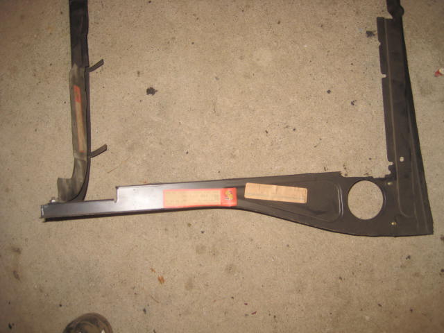

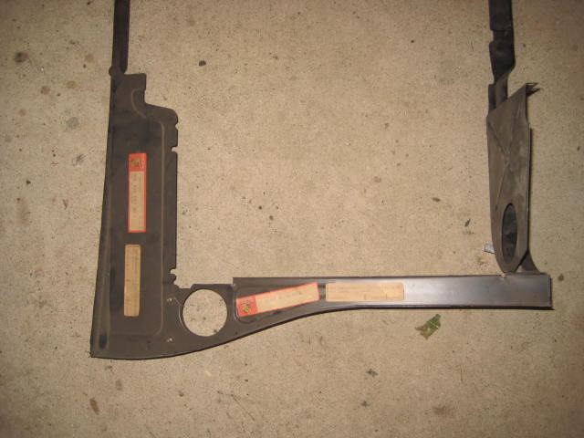

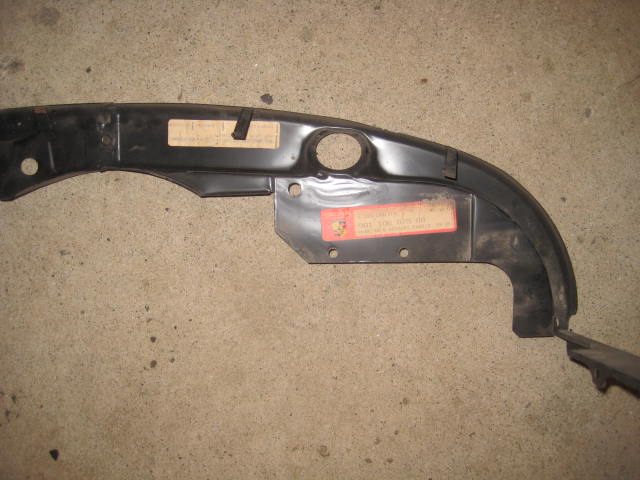

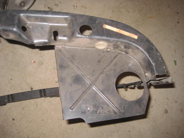

Pics show only standard holes and no added slot for Carrera chain tensioner. Original paint too. The last piece has additional (stock) holes for Sportomatic transmission. Attached image(s)
