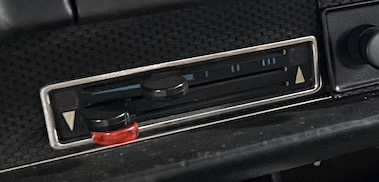

Holes are for heater hoses, those side pieces are for vehicles not running heat. Does that mean that some 914-6 did not have heat in the passenger compartment? It was an option? I assumed every car made since the 50s had heat standard. Does the presence of the red tipped slide control indicate our car came with heat? ![]() |
