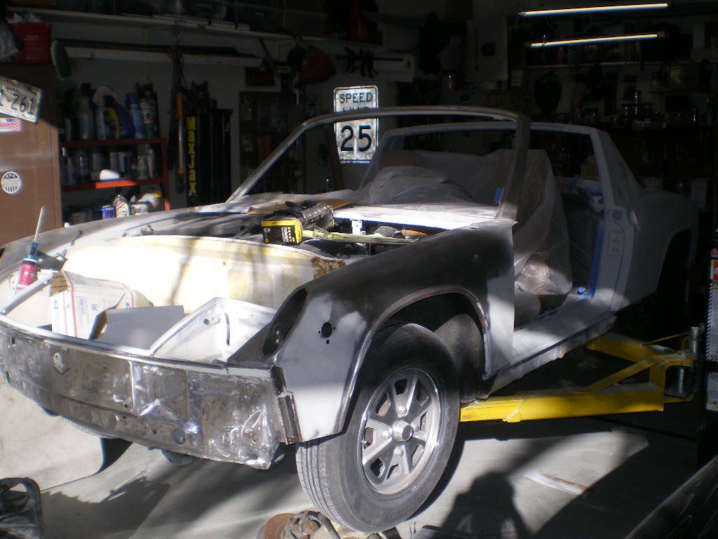

In 2009 I bought this '76 from The LeMay Museum. It had been donated to the museum by one of their members. They in turn decided to sell it and use the proceeds towards other projects they had in their inventory. Google them and you'll see it would not have been a good fit.

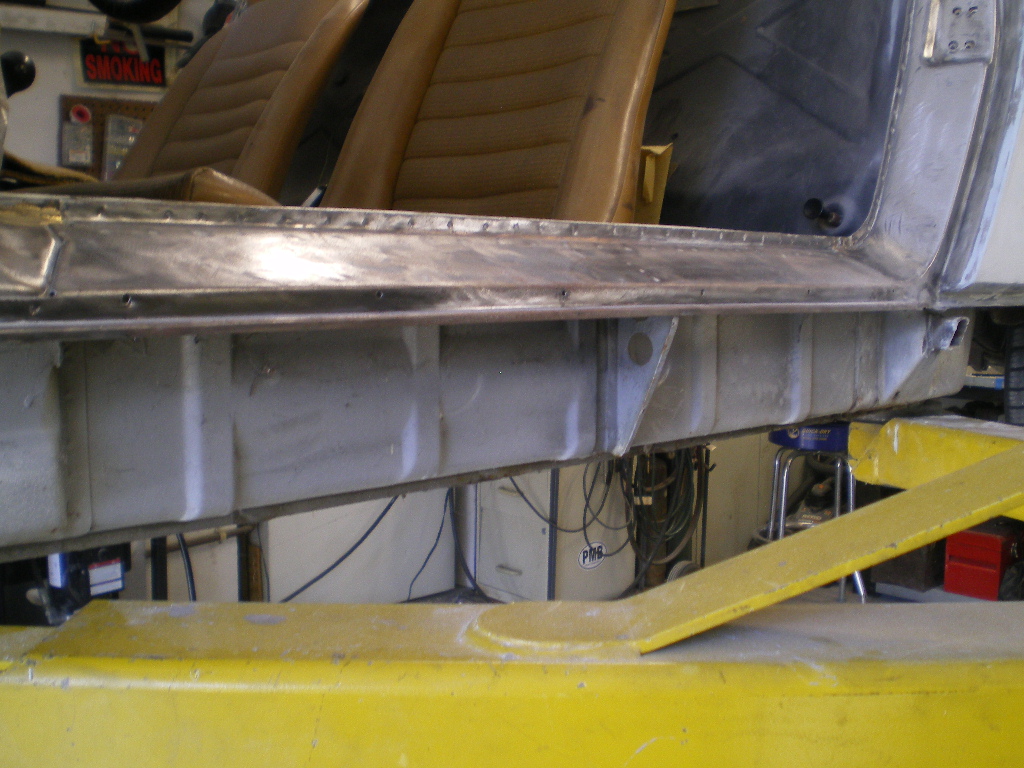

Upon delivery I discovered there were areas where rust had staked it's claim. The sail panels had, as I now know, the usual rust; the battery tray and the area immediately behind it plus a small area on top of the long beneath; and finally a few spots along the front rain channel.
To say I was distraught would be an understatement. Thirteen years and 2 more 914's later I know it was a good deal. Did I mention I paid $1600 for it delivered. The longs were solid as was the rest of the car. I removed the wiring mess for the car alarm & CB radio then reconnected all the wires to their original terminals. Next I replaced the Fuel Pump relay, added gas. After a turn of the key it coughed, farted and started. That's pretty much the Reader's Digest version but little more was done than that.
I hadn't worked on any cars since I was a teen and none of those needed rust repair. However, after building an airplane years earlier, I had some experience with aluminum and fiberglass. Do you see where this is going?
I thought it time that I go back and do a proper repair job on the old girl. Don't get me wrong. I thought that the aluminum angle patch pieces on the rain channel, the fiberglass in the Hell Hole and Bondo on the sail panels was "good enough"! Looking back, I didn't know Shit from Apple Butter.
It has remained as such but Since both of my Subaru conversions are basically finished, sans a paint job on the '73, I decided to go back and correct my "Get're done" repairs. I bought the rail repair pieces from 914rubber which in turn gave me an excuse to buy a metal shrinker/stretcher.
Bore yourself if you will, as there are more interesting and detailed metal restorations going on here, but I thought I'd better post these improvements for the next owner.

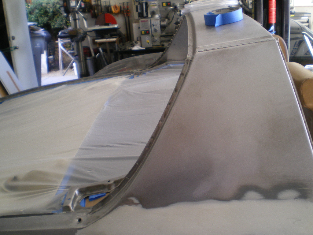

76-914   2 of 4   Jan 26 2022, 10:10 PM

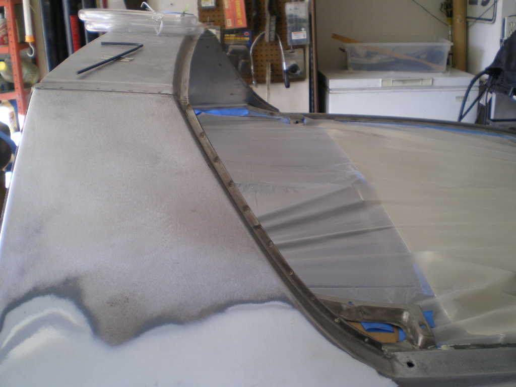

76-914   another angle from 2 of 4 3 of 4   Jan 26 2022, 10:14 PM
76-914   This is one of the aluminum pieces I had riveted i...   Jan 26 2022, 10:20 PM

Mayne   Nice work. I was just looking at those rail replac...   Jan 27 2022, 04:53 PM
76-914   Nice work. I was just looking at those rail repla...   Jan 27 2022, 08:25 PM

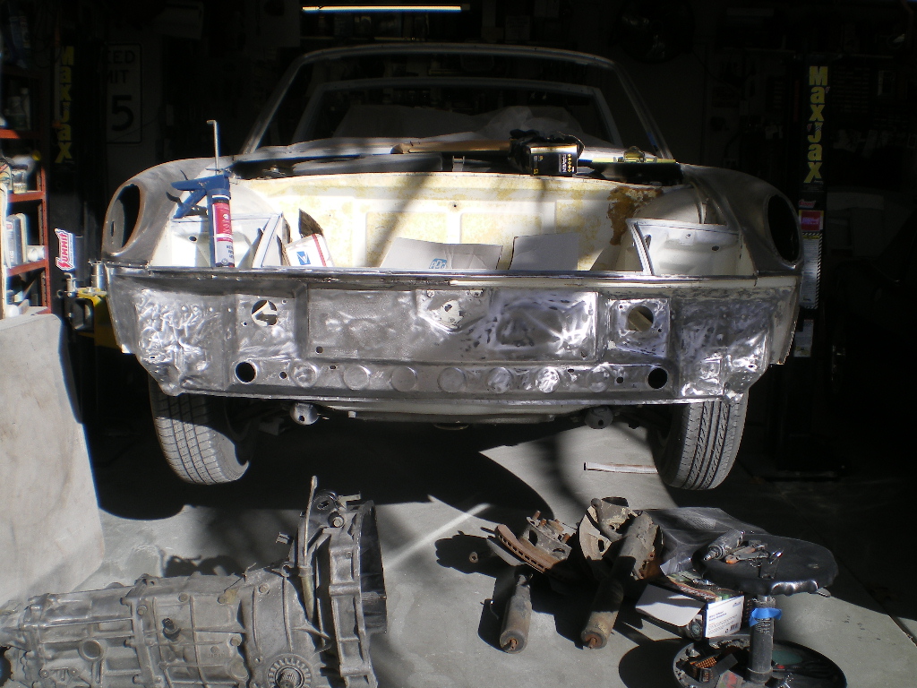

76-914   Moving forward - actually I started at the front a...   Jan 28 2022, 09:54 PM
76-914   Opps. Hit the wrong button but the previous pic wa...   Jan 28 2022, 10:08 PM

76-914   Dang, that took longer than I thought. Now I know ...   Feb 3 2022, 08:54 PM
Chris H.   Nice work Kent! Don't see any distortion ...   Feb 4 2022, 08:24 AM
76-914   Thx Chris but there is a little shrinkage at the w...   Feb 5 2022, 06:46 PM
