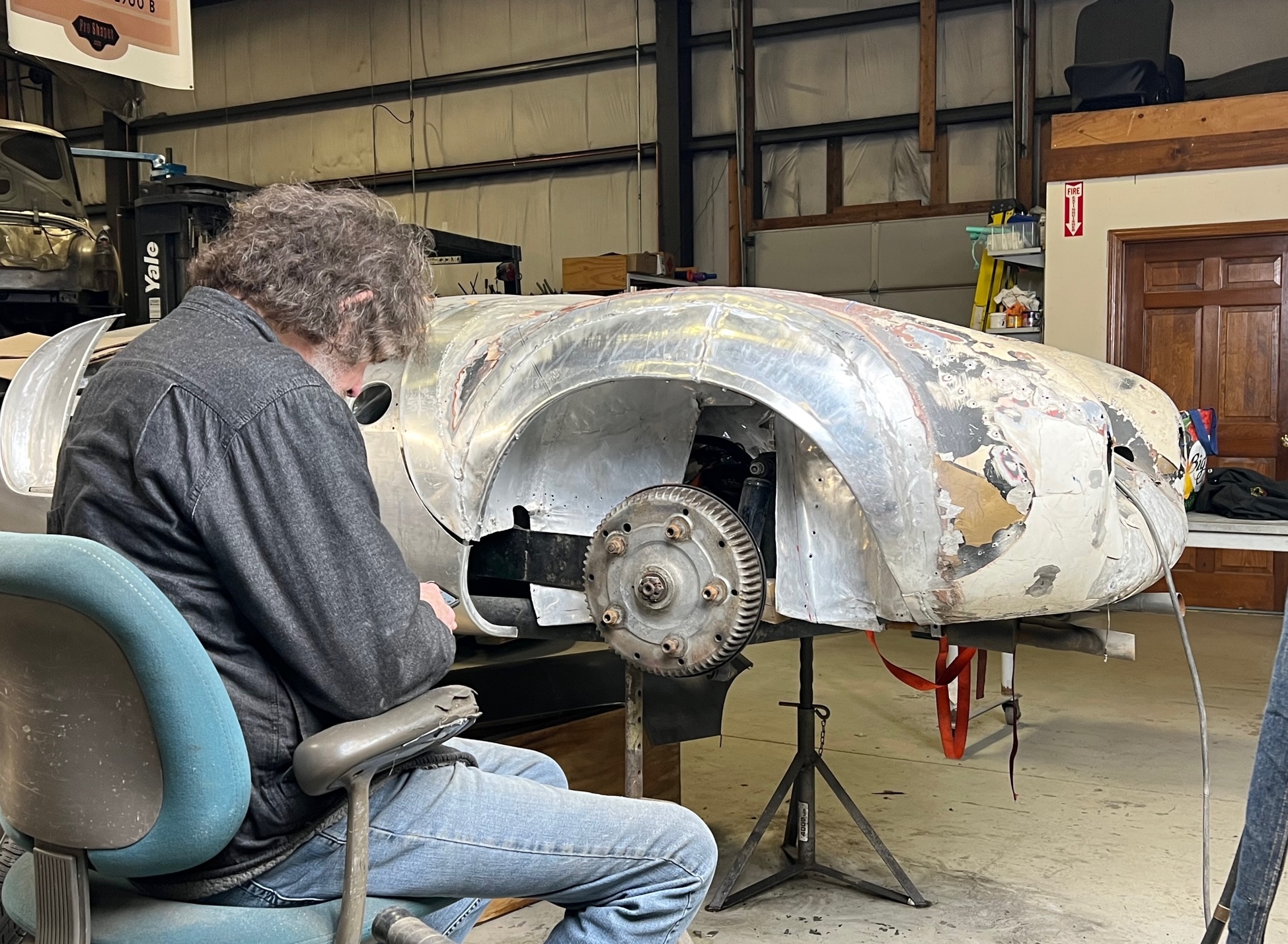

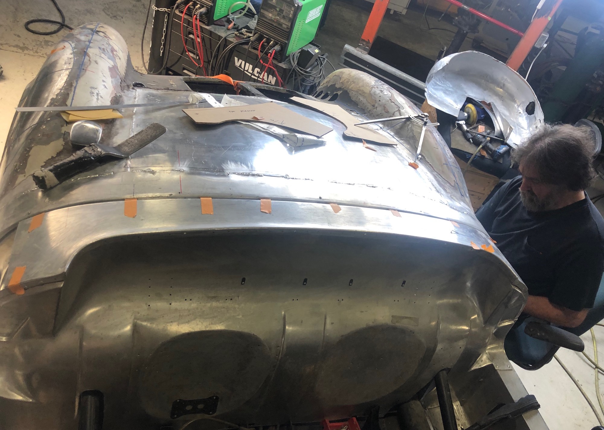

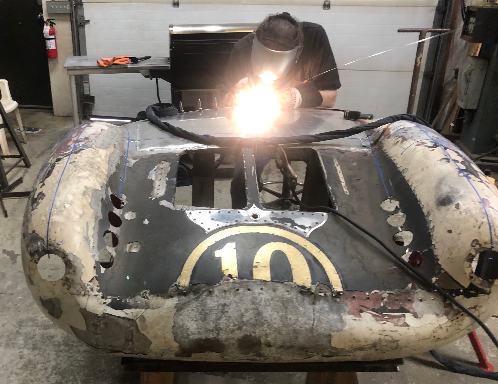

My Miller MIG died a few years ago and I upgraded to this one and man, it's impressive.
I haven't tried the TIG on it yet but will once I transfer the 550 build back to my shop in the next year or so. The HF welders are good machines, not cheap.
We've been using them to repair the 550 tail and it's tricky because 60 year old aluminum and modern aluminum aren't always friends. I've been told the post WWII aluminum in Germany had a lot of Iron in it.
