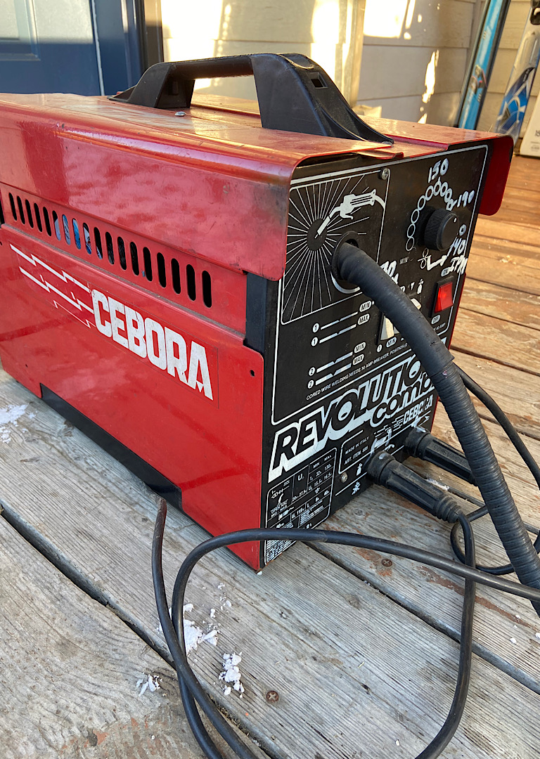

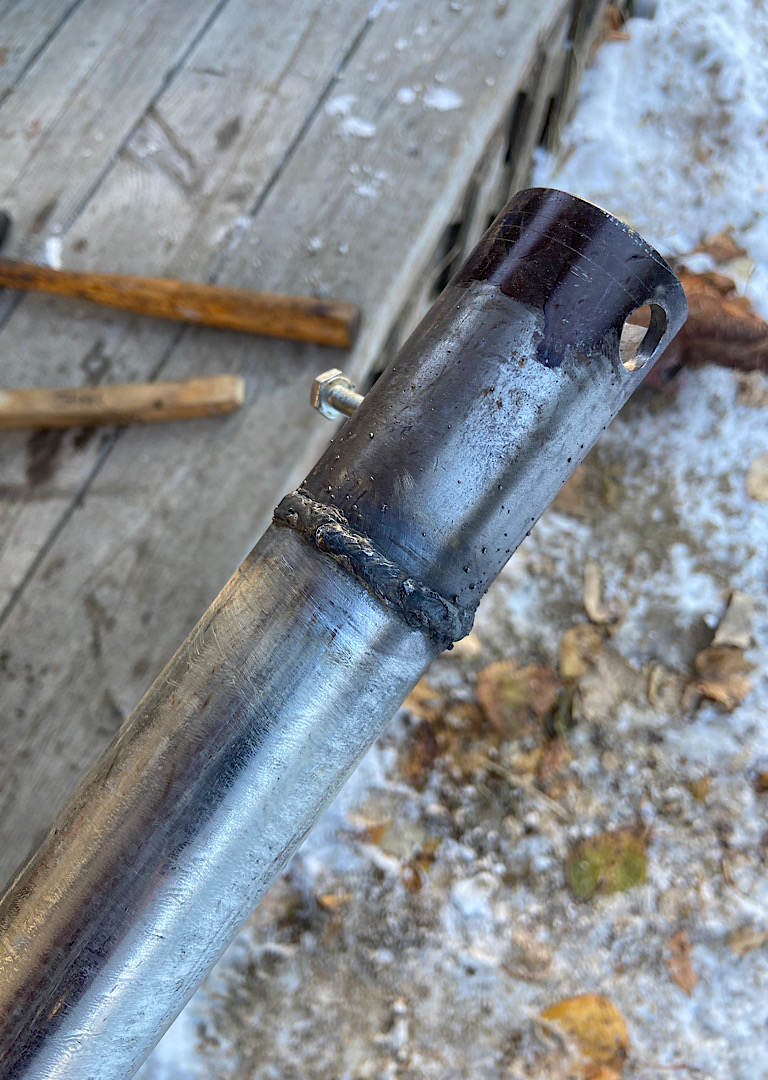

Serviceable flux core weld made in freezing cold weather with a breeze. Fused thin wall galvanized pipe with a piece thick cold rolled steel that was machined. Done with an old 90s era Italian 110v MIG with only 4 finite heat ranges. Easy.
