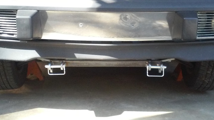

where can I purchase a flat tow bracket that does not require the removal of the valance or front bumper?

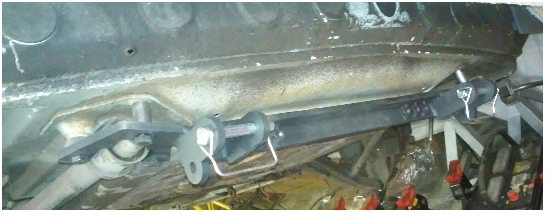

That setup kinda scares me. (IMG:style_emoticons/default/huh.gif)
I see what was done by spreading out the push/pull load, but bolting it to the thin single layer trunk floor isnt what most folks would opt to do.
If you are open to "trimming" the FG OE style valance Im pretty sure it will fit fine.
As I described the bracket bolts to the 3 bolt points at the front of each A-arm only.
