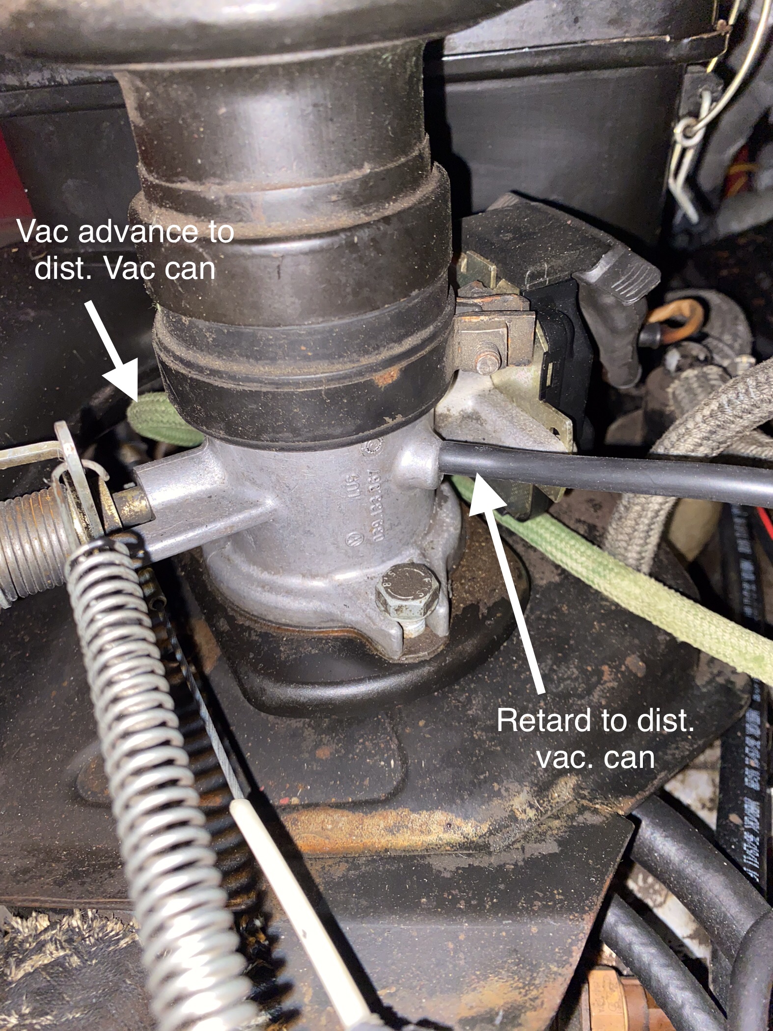

Getting ready for a throttle body rebuild and planning to use a spare core, but noted a difference in my spare relative to the part installed in my 75 2.0L.
My installed throttle body has 2 vacuum ports which I understand are for the vacuum advance and retard (I actually found the advance line loose at the distribution vac can).
I am looking to confirm that the best course of action is to retain the dual ported throttle body versus rebuilding the single port body and capping the retard line at the distributor. Pretty new to this so I appreciate the feedback to confirm.
Pics of my installed and spare bodies are below.
Installed on my ‘75 2.0L:

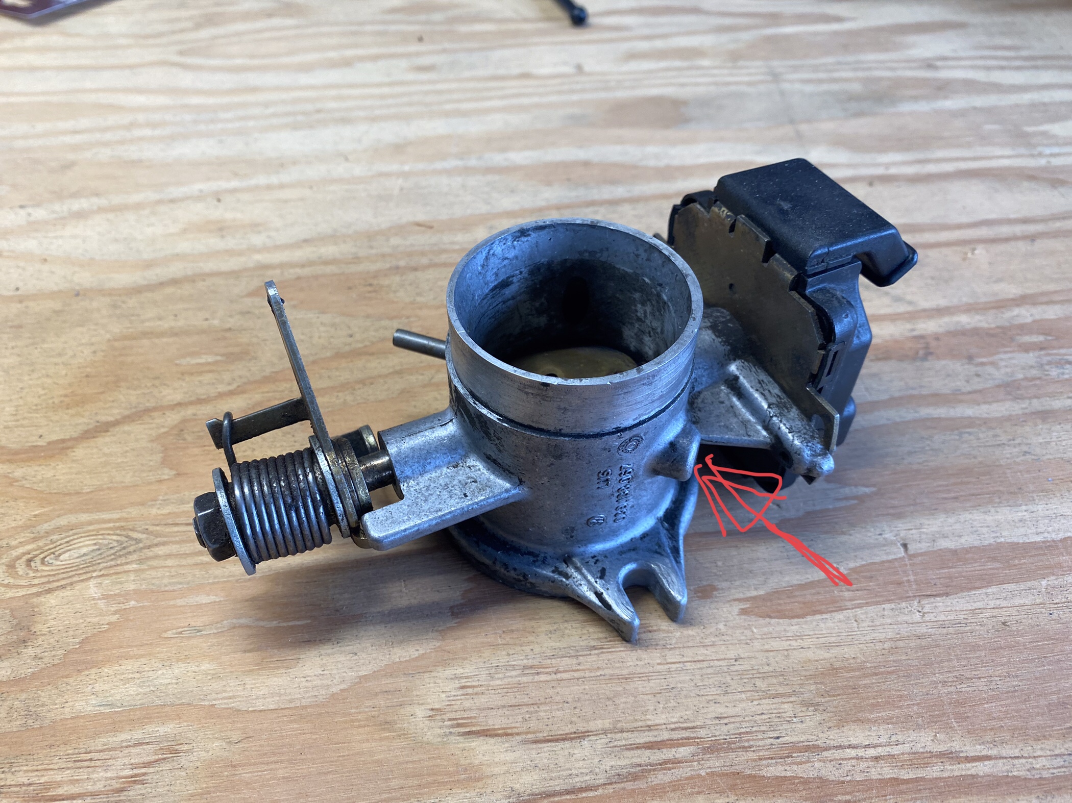

Spare throttle body:
