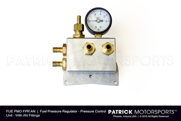

Superhawk996   The PMO fuel regulator is perfect for converting...   Dec 7 2022, 12:32 PM
BK911   Generally speaking, it is bad practice to use a...   Dec 7 2022, 12:58 PM

914werke   @bk911 What specific PMO Fuel Pump are you referr...   Dec 7 2022, 03:20 PM
BK911   Regulator, not pump. With this regulator and prope...   Dec 7 2022, 03:29 PM
