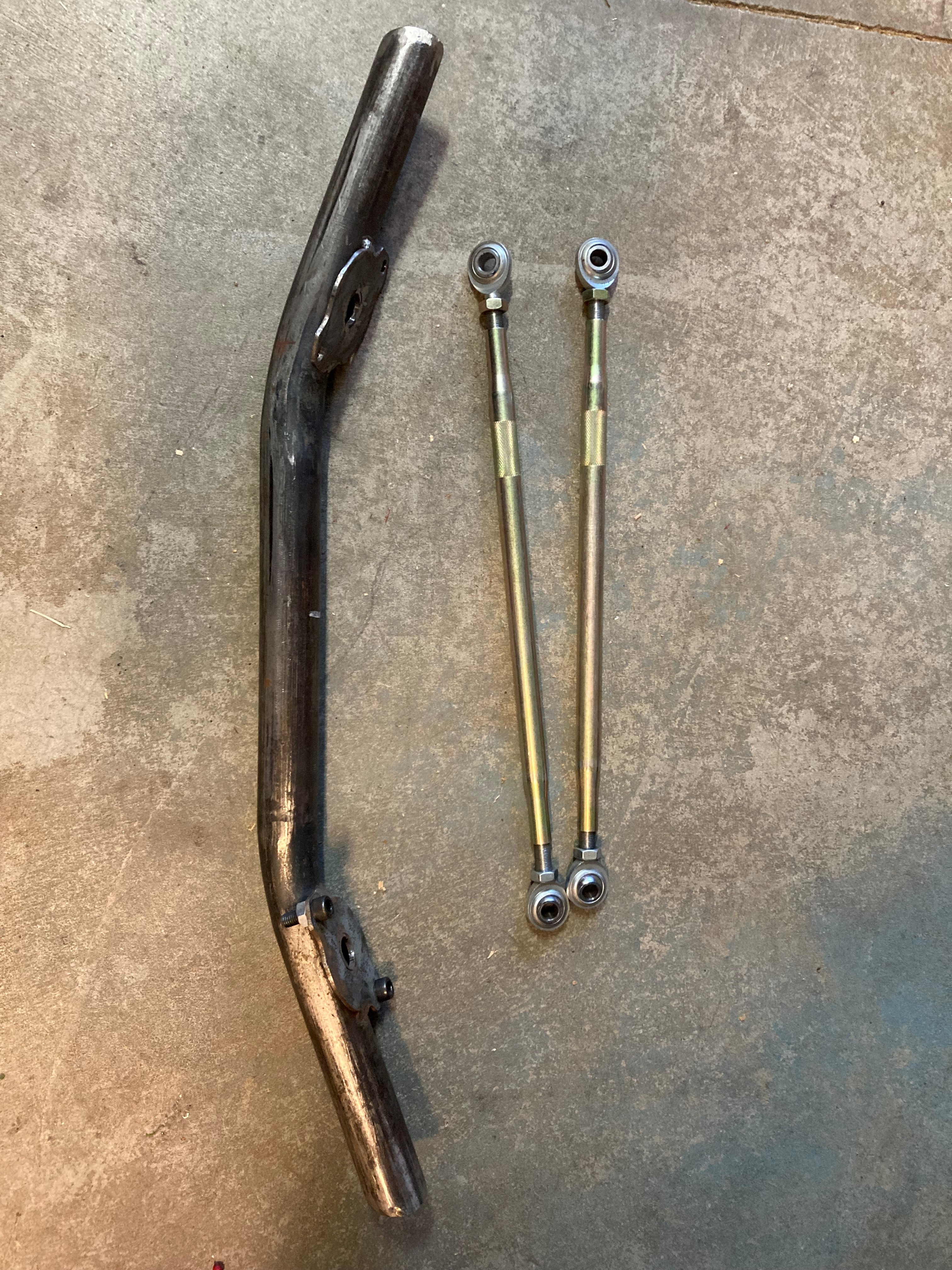

I have started fabrication of a crossmember using 1 3/4" .125 tube (pic below) but it looks kind of wimpy, especially with the drop in it. I want it to be stiff not just strong. So I'm thinking upgrading to 2x3 .120 tube. The diagonal tension members are also shown in pic, 3/4" swaged tubes from Speedway Motors with 1/2" rod ends.
Let me know what you think
