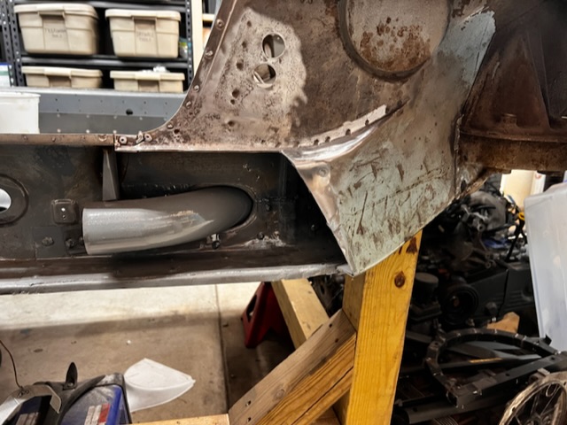

This is about where I left off two years ago:

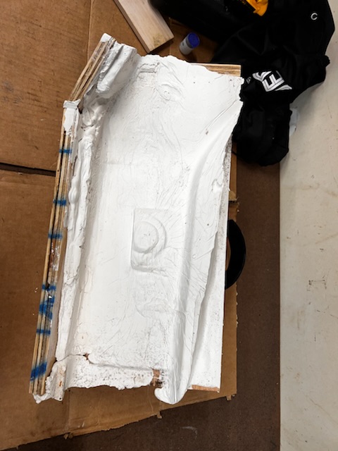

A mold I made from plaster of what was left of the driver side jack point area prior to demo. I wasn’t sure how or if I would use this, but I thought it might be helpful since there are no patch panels for this area.

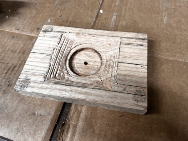

A wood buck I made to attempt to replicate the recess where the jack point tube gets installed:

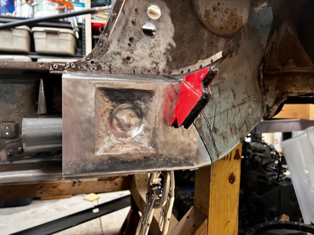

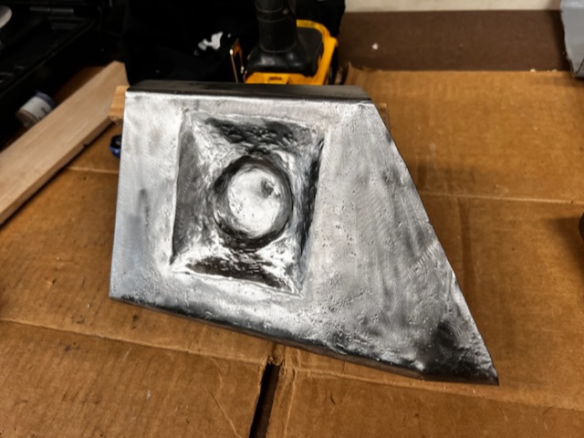

Making the outer skin of my repair section:

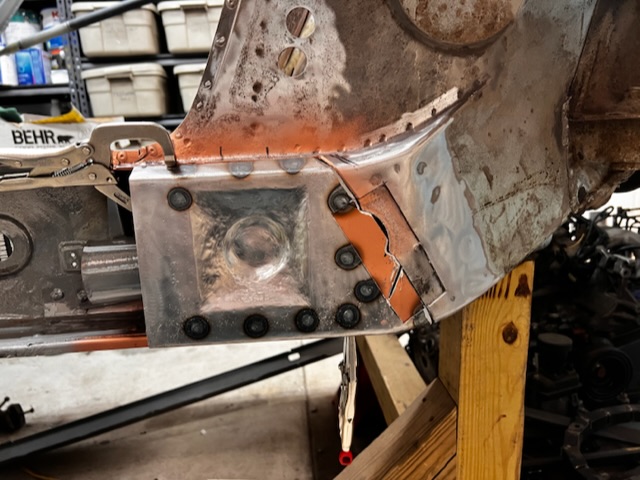

Some test-fitting:

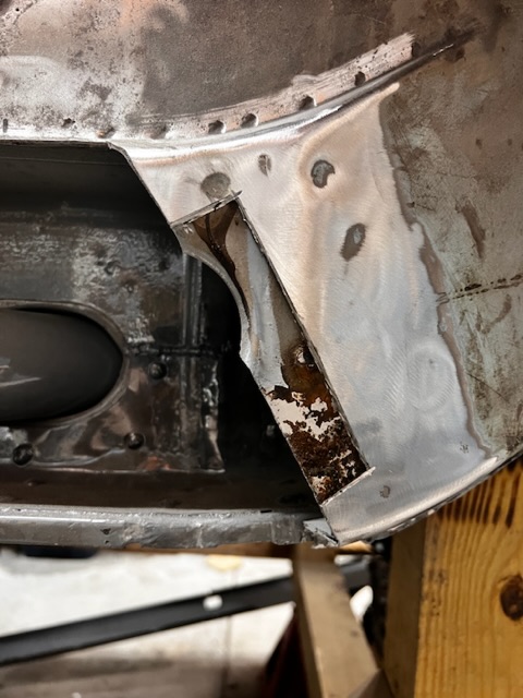

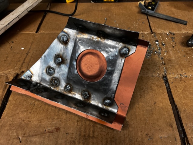

Cutting through the outer layer so I can have some stagger in the weld seam joint:

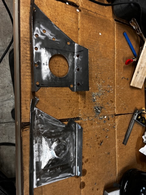

Finished the inner layer and plug-welded the two pieces together:

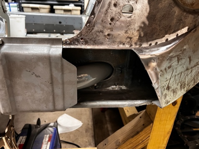

Ready to weld in place:
