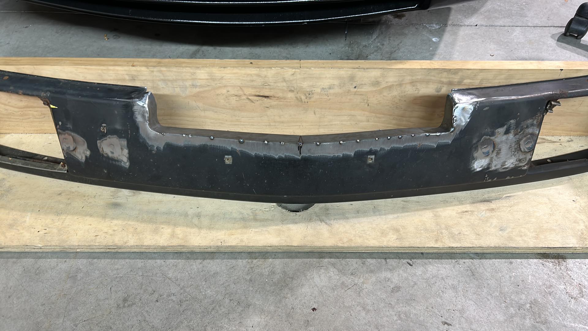

Anywho, I did spot a front bumper on Facebook marketplace for a decent price (I already scored a clean rear bumper for the backdate locally.) The front bumper met a few requirements, mainly that it was not chromed and not severely rusted. Seller sent me a pic of his kitchen sink too! :-D
It looked pretty clean so I made a deal to have it shipped from NC to WI where I asked Ben Mcfarland to apply his metal skillz to customize it for the GT opening.
He sent me a few pics of his progress already and I'm excited to get it mounted up.
I also asked him to delete the license plate holes. That's something I did on my 911 valance and I really like the smoothie look.
I really dig this car.
Definitely the direction I'm heading. Clean, narrowbody with GT front, and I think that's the Patrick Motorsports "Limited Edition" valance, but not 100% sure. Anyone know who owns this car? More pics!
