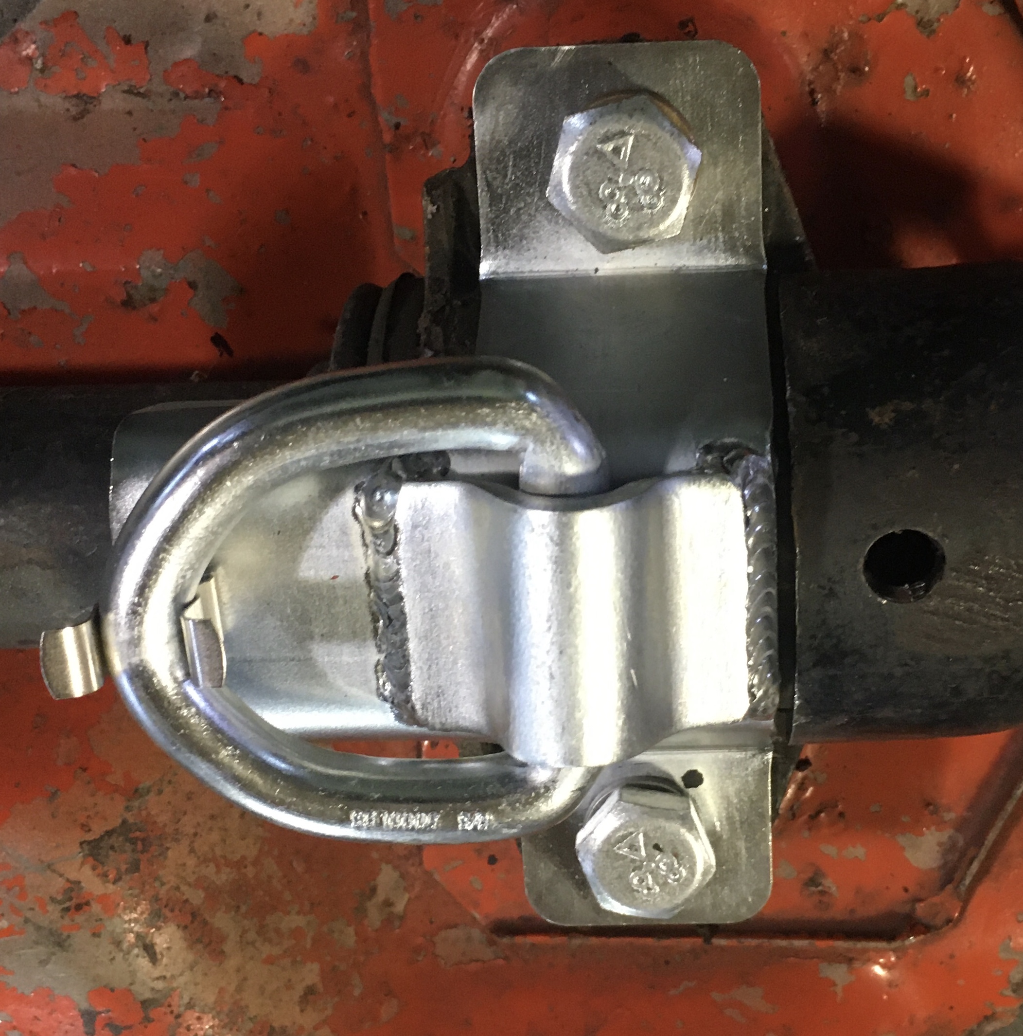

My car has dealership installed AC so the front tow point is gone. I got it with a bent drop link I’m sure was the result of a past tow. I’m trying to figure out what my options are and found these tie downs from Jman. Has anyone used these or something similar? If so I would really appreciate a picture of one installed.

jdamiano   Here is how I ended up mounting the Jman loop.   Sep 17 2022, 04:40 PM
ChrisFoley   It really shouldn't be between the a-arm carri...   Sep 17 2022, 05:55 PM
jdamiano   It really shouldn't be between the a-arm carr...   Sep 17 2022, 07:16 PM
Superhawk996   It really shouldn't be between the a-arm car...   Sep 17 2022, 08:03 PM
914werke   Confused about intended use? Title says "Tow ...   Sep 18 2022, 07:54 AM
jdamiano   Confused about intended use? Title says "Tow...   Sep 18 2022, 08:24 AM
ChrisFoley   I’m trying to add a good place to hook a tow c...   Sep 18 2022, 08:42 AM
robkammer   I’m trying to add a good place to hook a tow ...   Sep 26 2022, 04:39 PM
Olympic 914   I carry a couple motorcycle tie down straps. Wrap...   Sep 18 2022, 08:41 AM
mepstein   I carry a couple motorcycle tie down straps. Wra...   Sep 25 2022, 07:52 AM
jdamiano   Here is the way I ended up installing it. Had to m...   Sep 24 2022, 03:23 PM
ChrisFoley   Here is the way I ended up installing it. Had to ...   Dec 19 2022, 04:43 AM
ChrisFoley   That looks ok as an emergency tow point - as usefu...   Sep 25 2022, 03:53 AM
