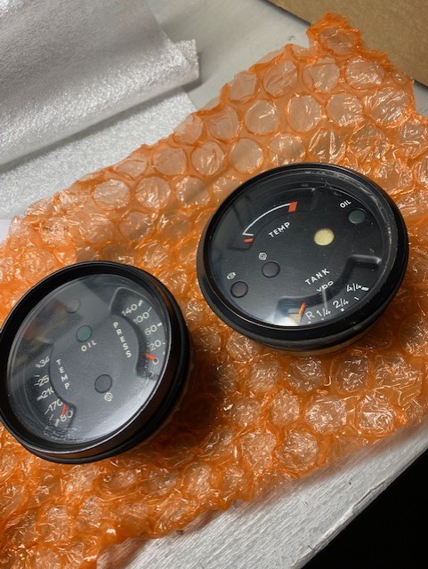

Little update today. I knew I'd want to keep an eye on the temperature and oil pressure for the flat 6 conversion, but I'm not interested in running a center console for moving the gas gauge or other gauges down in the middle.

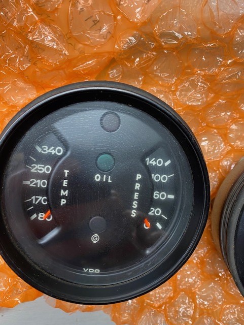

Enter John Bell who agreed to make me a custom combo gauge out of my 914 gas gauge and a 77 donor oil temp gauge out of a 911. Here are the donor gauges:
And a close up of the 914 stock 75 gauge. I love the simplicity of these VDO gauges.

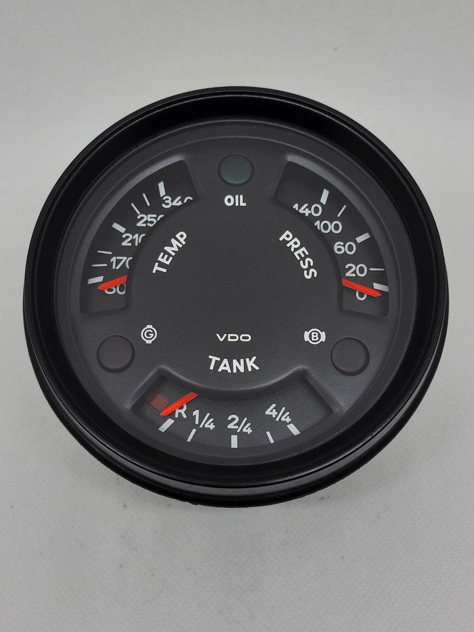

I sent the donor gauges off around 2 weeks ago and today received this pic -and should have this beautiful example in my hands tomorrow.
John has laser cut faces for the triple combo style already made up. For a moment I considered a quad gauge, but they are too busy, and it was going to be quite a bit more. I want VOLT meter so maybe I'll update the speedo at some point to have a subtle volt meter in the bottom.
I'll need two wires and I think the EGR wires may work as they will already be in the harness running up to the cluster from the engine bay. I actually removed the entire EGR harness from the harness of my 75 full harness. If I remember there's a blue and a blue/white stripped, and maybe a third that was emissions related that I can commandeer for my purposes. I have a 76 harness going in that should have that same sub harness, but if not, there are myriad wires I can snag for the pared down flat 6 conversion as I'll be running carbs. So anything that had to do with the 75 2.0 motor can now be a donor line.
