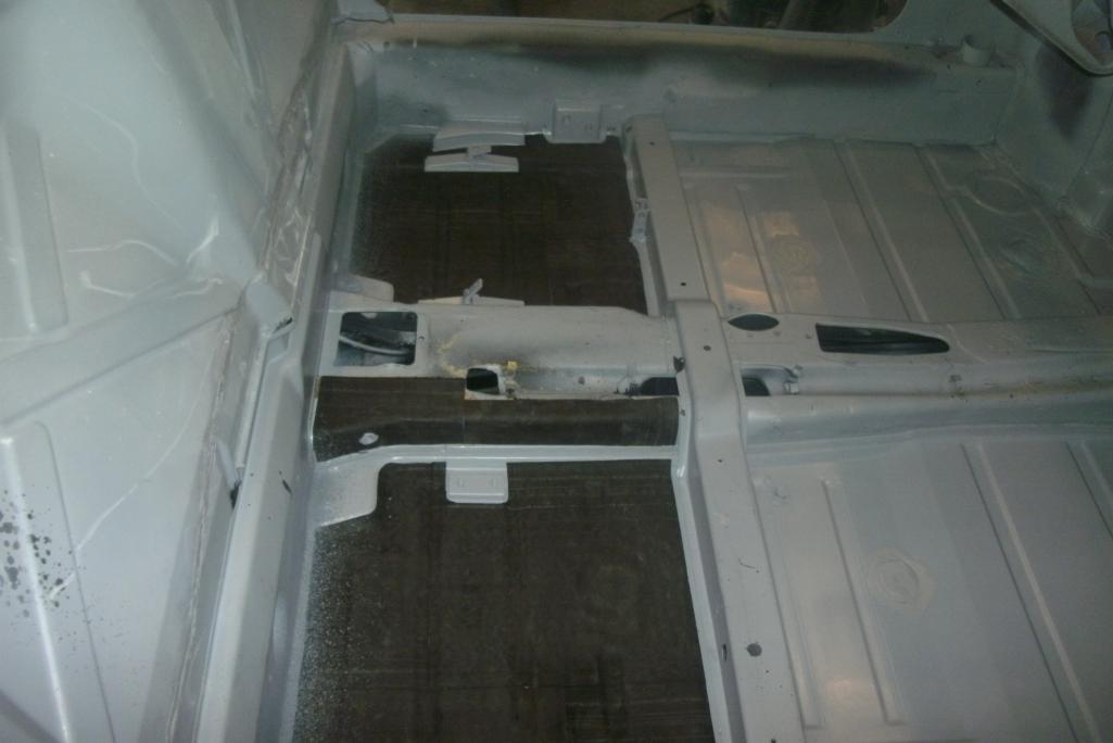

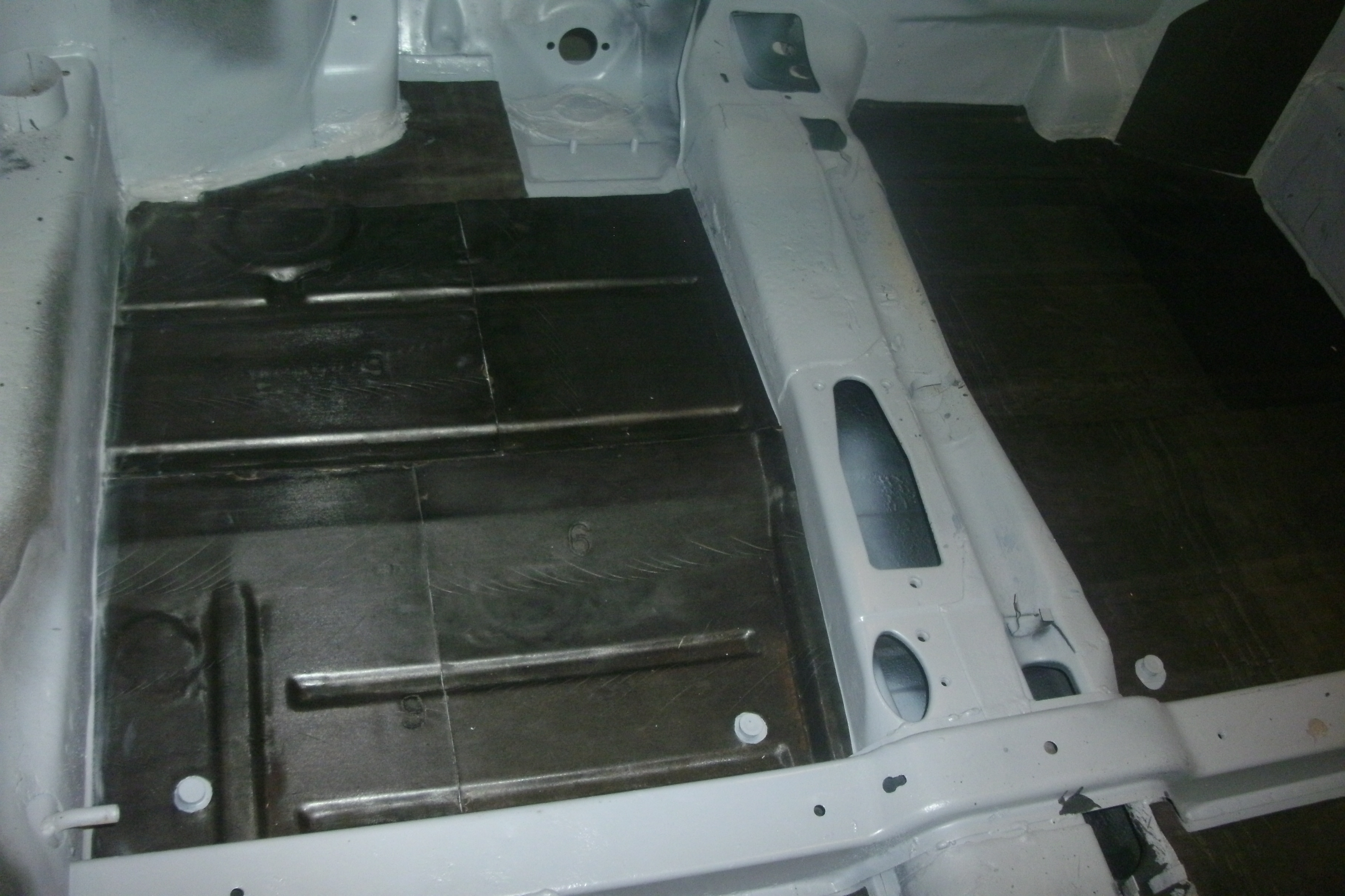

Wished i had known you sell a kit George. I ended up with a nice result but needed to cut and fit the stuff I used. Same as the factory material. If I had to do it again I would just purchase the kit. Infact I think I will purchase one anyway just to have it in stock here. (IMG:style_emoticons/default/idea.gif) The original was lightly oversprayed from the factory in this car. I am doing the same when it comes time for paint. I also dislike the foil advertisement stuff.
