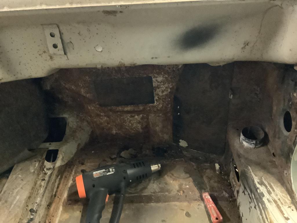

In addition to the floor and sills the factory put tar on the front firewall. Here’s what I found in a 70 six. George sells these as well.
