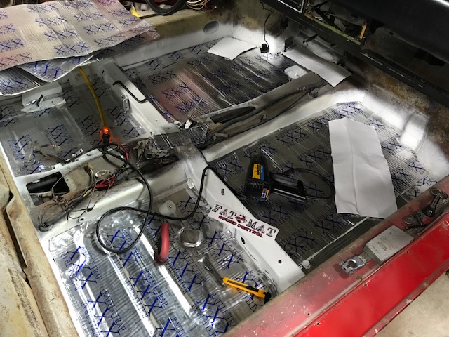

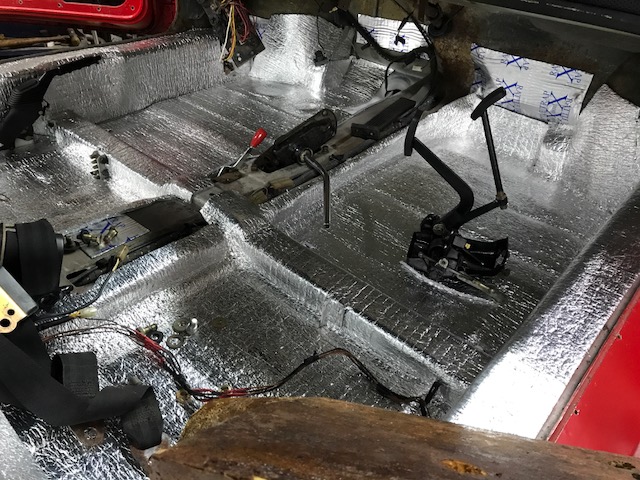

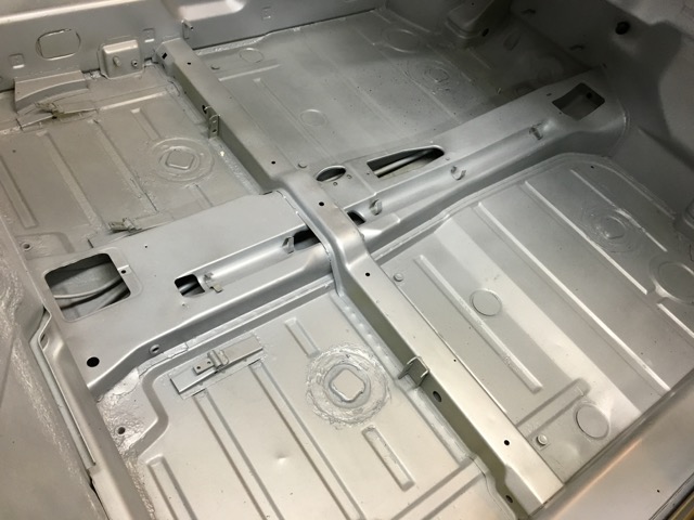

I order the kit today, I did my Build off 73 in FatMat, and EZ Cool. But in the 72 I’m going with a stock build and installing George’s kit. I’ll share the install when the weather warms up a bit.
Here’s 2 pictures of the 73 build off floor, and then the silver 72 floor, waiting fo the kit.
