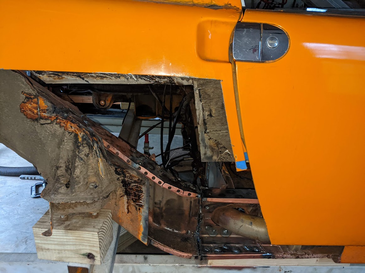

Hello all, I'm a bit new to this. I had one of these in my 20's and and did a little stick welding fixing the hell hole.
I'm not sure how to approach this. Do I need to strip all this and go on rotisserie? Or is it feasible to cut and patch this from the top
The driver side floor is bondo (or something). I'm not sure what is holding the seat mounts. The passenger side seat mount right is about broken loose. There's also holes past the transverse strut into the battery area.
The longs seem ok from what I can see. Can I get the sill covers off without taking the fenders off? I was worried I drill out all the rivets to figure one hidden under the fender.
Any good tool recommendations for rust removal?
I was thinking maybe I can get away with with https://www.restoration-design.com/store/product/PP345BR and a https://www.restoration-design.com/store/PR...duct_Code=PP325 and the seat brakets and patch the holes.
Attached Image Attached Image Attached ImageAttached Image

Your door braces are way to weak to be of any use in resisting the compression that occurs as welds shrink.
Do not proceed further. This needs to be fixed now before the structure gets even stiffer.
Step 1) Build proper door braces with tubing and heim joints.
Step 2) cut the long at the transition (see pic)
Step 3) regap the door
Step 4) reweld - go slow and cool as was suggested

This is great advice. You can see in your photo that the turnbuckle wasn't able to withstand the shrink. I got by with iron pipe and turnbuckle braces but me turnbuckles were a little beefier than yours. I was also warned early about keeping the heat down by going slow with the welding. In the end, this little blip of a redo will be insignificant and well worth the time to get it right.

Step 1. It popped back into place after the cut which also separated.
I think the issue wasn't so much the turnbuckle but rather where it was placed. It's all bent now because I really cranked on it in a last hope it could force the car apart. I think since I have the fender and wheel house cut out, the bottom has no brace to stop pulling in there. Ideally I'd have a brace going from behind the suspension console to the door frame but then I won't be able to close the door. Maybe weld in something temporary to reweld the cut as suggested by Dlee6205 and then go slow elsewhere. Like a tack weld every 2 min? Though I would think welding in the wheel house shouldn't shrink the door gap. I did get that AA part as well as the rear firewall and some hundred $ of other panels. ( I ended up with 2 passenger inner firewalls trying to get 5% on all the parts)
Also looks like the door frame pulled down I guess on welding in the rear firewall. So I'll try to undo the few spotwelds and see if that pops back up.

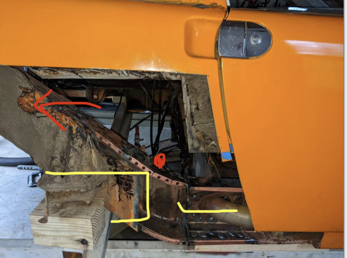

You need to look very carefully at what’s going on and understand where the metal is being pulled by shrink.
See pic - yellow is the approximation of the sheet metal profile as viewed from above.
When you weld in the inner wheelhouse your going to end up with shrink that pulls in the direction of the red arrow. Because the sheet metal is anchored at the rear bulkhead you will get a pivot point marked by red dot.
Hopefully you can see from my crude drawing when the shrink occurs and pivots - the door gap will close. Especially so where the rear quarter is missing which would counteract it to some degree if it were there since that quarter panel would go into tension.

Superhawk996   I’ll apologise because my diagram is over simpli...   Jan 4 2023, 11:13 PM

stoneman30hotmail   Someone said "don't trust the jack stands...   May 3 2023, 04:27 AM
mepstein   I would have made the base wider and triangulated ...   May 3 2023, 05:29 AM
Superhawk996   :agree: You’ve got a recipe for disaster brewi...   May 3 2023, 07:22 AM
